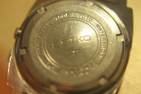

here's a sweet little number i got in the mail friday. it's a 7005 from june 1969. i looked at it on fleabay and tossed a number at it. when i looked at the seller's pictures, i knew that the dial was in good shape. this is one of my favorite watch case styles - it's style lends it to being a bit larger.
my only gripe with this watch is that the crown is so small. i'm sure it is the original.
it was advertised as a non runner. usually i find that it isn't always the case, but it is in this case. it doesn't run after charging the barrel. but, if i keep a bit of pressure on the crown, it will run. i'm not sure what would cause this.
looking closely at the dial, you can see some spotting of the paint between 7 o'clock and 9 o'clock and again at 1 o'clock to 3 o'clock. i would love to clean this up somehow but it looks like it's lifting from beneath the paint.
the case back has been peened outwards for some reason. this was deliberately done because it is dead center and perfectly round. the crystal is in very good shape as is the case. the sides could use a polish, but the top still has some nice radial brushing on it.

this will run only if i keep a bit of pressure on the crown. if i pull it out to set and turn it slightly, the second hand will keep going nicely until i release. i don't know if that means nothing or anything.
I'm not too sure about this movement since it has been a while but, isn't this one, one of the hacking pre 7S26? This I'm not sure, off the top of my head, so IF it is hacking there may be an issue with the hacking mechanism. I'd definitely check the keyless works though, since it seems to be an issue with the stem or with the parts it interacts...maybe a broken stem? It could be a simple case of clean and lube...In any case, do show us some pics of the movement, that will help.

bobm - no, this is not a hacking movement. and i did pull the stem - it is intact. i'm leaning toward a simple case of clean and lube. this is an easy movement to take apart. i'll get a few pictures of the movement and put them up.

ok.....here are some pictures of the movement.....and an edit: i removed the balance for the hell of it and reinstalled it. the watch hasn't stopped running since. but the amplitude is extremely low. barely turnining.

Sounds like your movement just needs a service, you'll have it humming soon enough, I'm sure.
