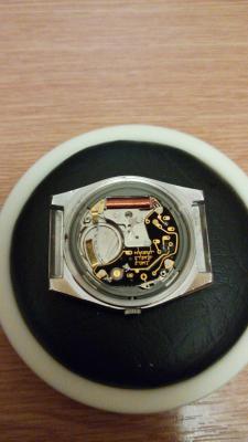

Here are four views of the battery compartment:-
Hi PaulB
I did a google image search on "Seiko 7123A", and in most photos it seems that the battery is kept in place by the brass spring closest to the coil, but in your watch that spring looks a little bent. But again - I'm a newcomer so I recommend you to wait for more experienced answers. Good luck anyway.
Pauli
Thanks Pauli, that's a good point.  I'll have a closer look at the spring & see what can be done with it.
Cheers
Paul
I think chainstay is absolutely correct. By the coil is the retaining spring. It looks a little short as though a bits broken off or it needs to be re shaped with a little fiddling about with. When changing the battery with this type of retainer I always like to loosen the screw and swing the arm out of the way. Fit the battery and swing the arm back and tighten the screw.

Or re looking at your photos, loosen the screw and lift, just to take the tension off the spring. Be careful not to touch the coil

I've attached the service manual where you can see sort of what the positive terminal looks like. Visually to me it looks just about right but it's been a very long time since I've seen one of these. The other thing that comes up is the battery has to be the right shape there is no insulator and the wrong shape battery doesn't fit correctly. Then when the batteries in what happens if you put the back lot does the back hold the battery in place? Because the positive terminal does not go across the top of the battery like you see on other watches some of these the battery will literally fall out of the back is off.

Many thanks for this John.  I do have a direct replacement for the battery so unless there are any minute size differences between the new and old 389, then I wouldn't expect any problems.  Kicking myself for not taking reference photos as I took the back off etc, but from memory the battery was firmly held in place without the back being on.  I'll experiment at the weekend with loosening the terminal screw to see if that makes it easier to seat the battery and then tighten up to see if this provides the 'lock'.

I'm a bit in the dark here but does the watch work when the battery is held in place with your finger. If not definitely the terminal part has snapped off. Loosen screw and try repositioning the terminal slightly. If that doesn't work.undo the screw and take the terminal off. A staking set would be useful but if not. Use a small hammer and VERY gently hammer the end part to increase its length to make a contact; If that doesn't work you can try and find a replacement part. Fit another movement if the watch has sentimental value

I was just beginning to think that the battery was never going to go back in when all of a sudden it did!  Turns out the positive terminal locates against the side of the battery, although it is very fiddly to achieve this, but once in place it does seem very secure.
I've added a photo to show what it should look like and as you can see the positive terminal is not quite fully seated, although it is screwed tight.  Having got the battery to stay in situ I wasn't minded to start fiddling again!
I've also added a photo of the finished article.  The face was in perfect condition, so I just replaced the glass and cleaned up all the metalwork.  No attempt to get any of the dings out of the case - partly because I don't have the equipment or time, but mainly because they are part of our history together.

The positive battery contact is strange in these Seiko's. As you've noticed a lot of times the back is required to keep the battery in place. Then I've attached some images the service manual that's not outstanding but does give you a clue of what it should look like. Another image off the Internet where you can better see were the contact is supposed to be. Then Paul's positive contact isn't quite where it's supposed to be. Notice the red line I drew that is supposed to be parallel to the end of the coil. The circle is supposed to be over the indent and you can see it's off a little bit.
So the contact is at the angle to provide side pressure on the battery. Then it requires the back to hold the whole thing together. You're not supposed to get creative and bend the strap to go across the top although that would work providing you can still get the back on and it doesn't make it too thick.
