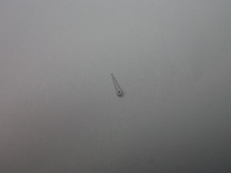

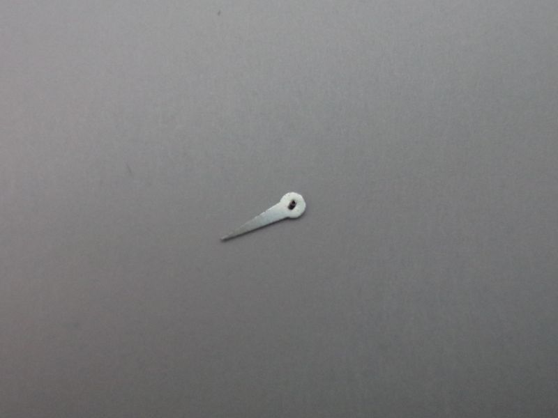

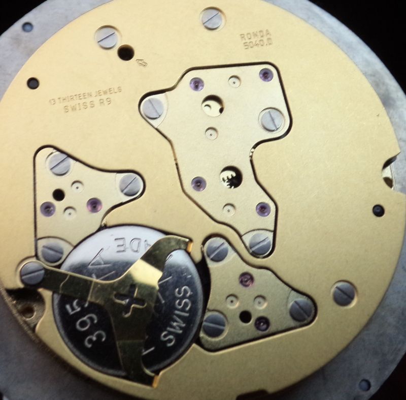

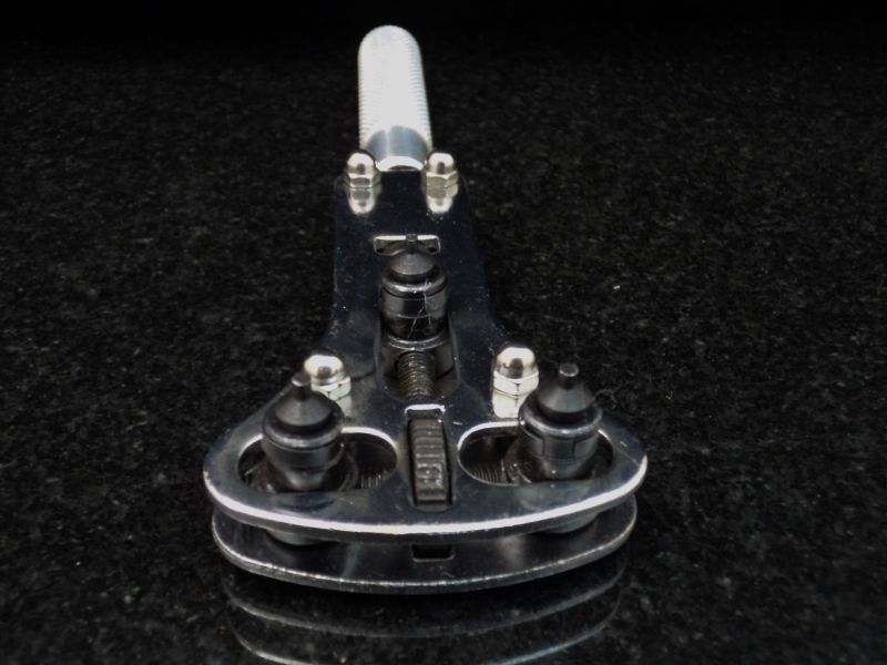

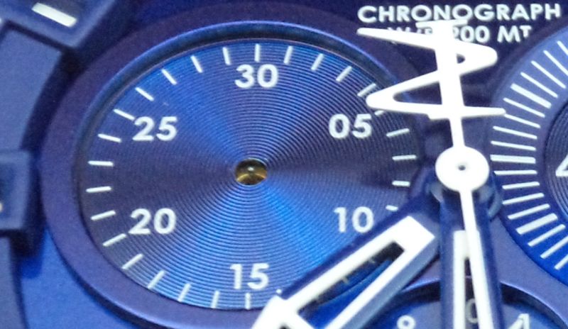

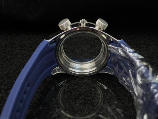

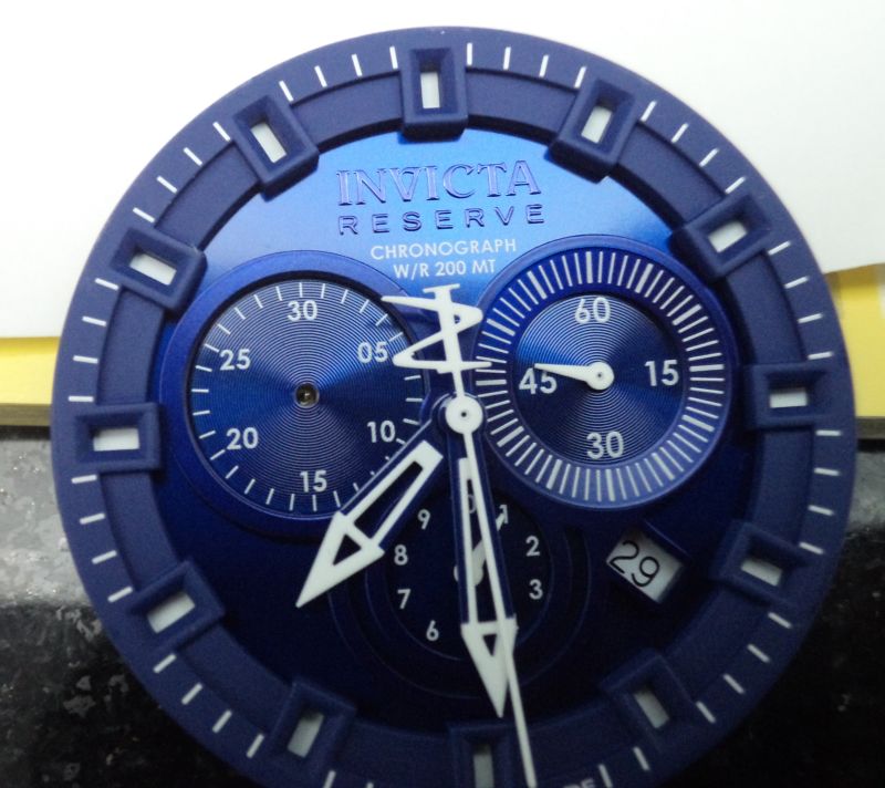

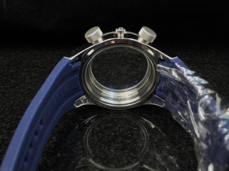

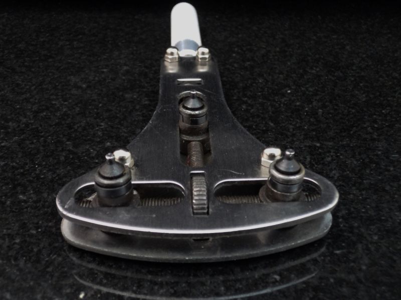

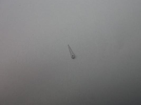

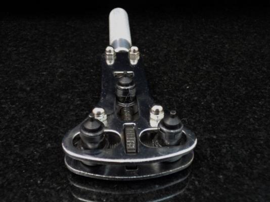

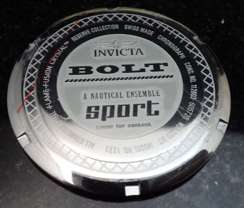

I am new to wearing wrist watches. I purchased my first Quartz Wrist Watch in January 2015 called Invicta. The watch battery died in November 2015 also the inside of the dial now have moisture. I purchased a watch repair kit from Amazon for $13 hoping I can get the battery replaced myself and wipe of the moisture. JAXA wrench that came with the kit was too small to open the case back. I purchased another one XL. This XL Jaxa wrench was almost useless too big unless I take the out Rubber Strap. Oh well, I used two keys of the wrench with difficulty to remove the case back. Found instructions on how to remove stem on Rondo 5040.D and did it without any issue. I had to take out the whole movement with dial from the case to clean the moisture from inside of the glass.Accidentally Minute hand came off and I do not have a proper tool to put it back.
Please help me purchase the best tool I can use to put this minute hand back without causing more damage.
Attach are some pictures.
Thanks for all the help in Advance.

Hi watchhobbyist,
Welcome to the forum.
Ronda 5040.D is a 150/90/26/20 hands movement (the option without the big date at the bottom). -- Big date option ".G" = US$90, regular date = US$53 (approximate common prices ) -- So, your hand setting tools should accommodate those measurements in order not to "over push" them. Otherwise the small hands could be in the way of the main hands. When choosing your tools check out the hole diameters.
