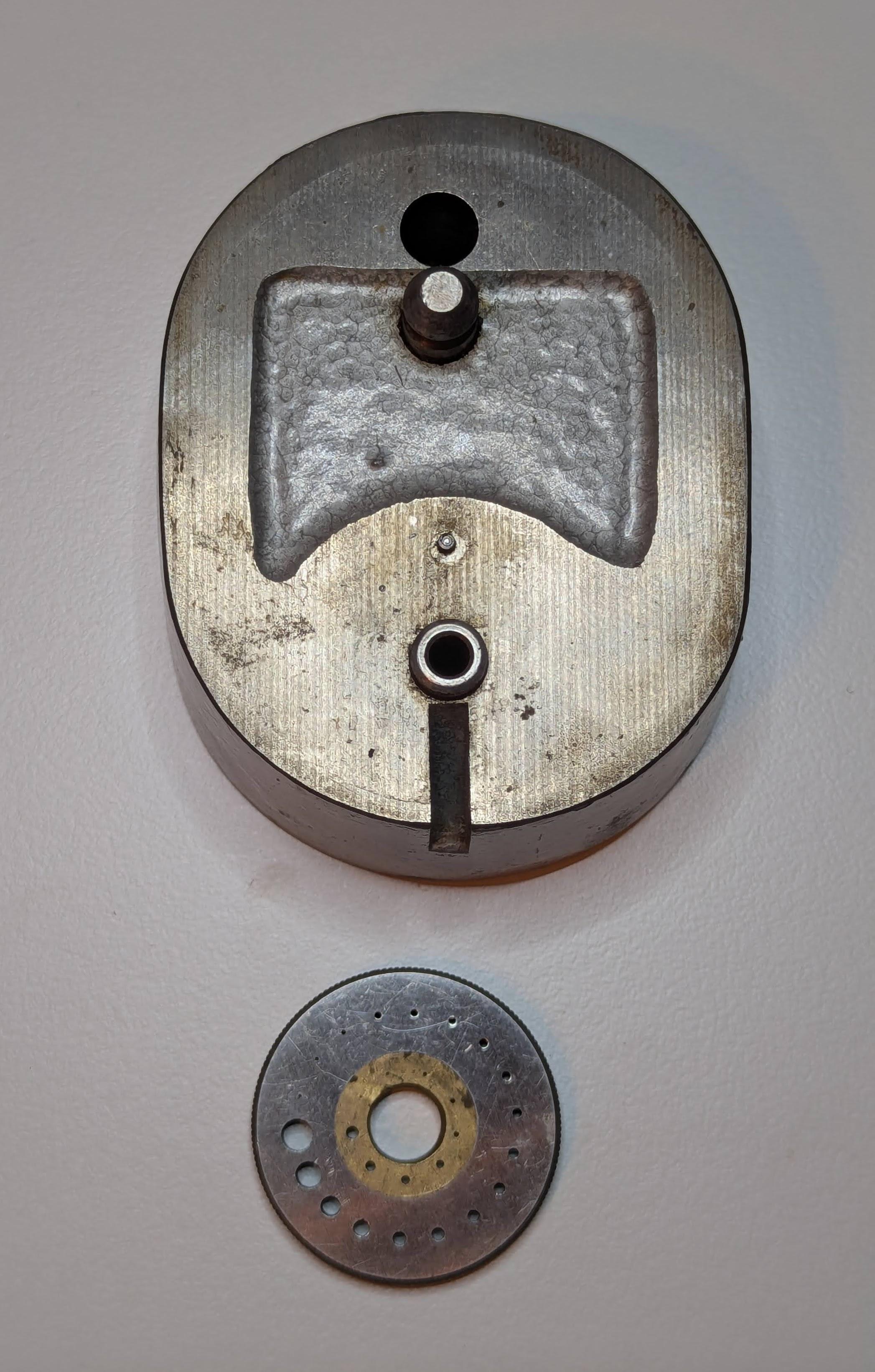

I bought this staking tool on Ebay for 220€ plus shipping. As far I can tell it is in acceptable shape.
I could not discover any brand name on the tool or on the case. Is it possible to identify what brand and model this is?PXL_20250404_174819547.thumb.jpg.94ddb3ca3b08c12af1b92ccc33a50676.jpgPXL_20250404_174857278.thumb.jpg.46a6e1ac323e74d93a9957e4a94dd6e5.jpgPXL_20250404_174906233.thumb.jpg.ba2097eff37292e2dc6c683d45e41d61.jpgPXL_20250404_174938580.thumb.jpg.5c831ed38acec9b826f7ed1f6b2bcbf6.jpgPXL_20250404_175153991.thumb.jpg.f9f211d531a381ebaac95e73fd7e6b5f.jpgPXL_20250404_175200616.thumb.jpg.aa28e3ec3286790f56dcbd5799d61dc6.jpg

You are right, it is WELO, this is punched on the stakes.
There are two disks in the set. The left one is the one that is visible in the photos in the first message in this thread:
The left disk has a cutout so that the pole fits flat into the disk:
This cutout is not present in the second disk, so the top end of the pole would protrude.
What is the purpose of the second disk to the right, and is it actually original without the cutout for the pole?
Afaik you can use it on the base as separate anvil.
Frank

3 hours ago, praezis said:
Not sure if I said it clear enough:
- remove 1
- mount the anvil plate on 2
Frank
Thanks for the clarification, that was not clear. I tried this out now:
PXL_20250406_175320430.thumb.jpg.898376f2125a4519800a5d053cacd994.jpgPXL_20250406_175304201.thumb.jpg.64bbf294dfe4849c9e6070b53380573d.jpg
Like this?
19 minutes ago, praezis said:
No 😀
Argh, overlooked again  that you had replied already...
Ok, thanks! What can this setup be used for?
