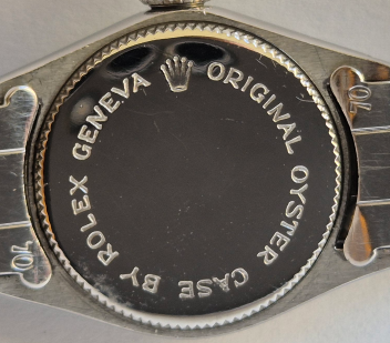

Been offered this Tudor Rolex and I must say I've not seen one like it before. Before I take the plunge would kind Rolex/Tudor enthusiast cast their eyes over the pics and tell me what you think....Thanks

I'm not so sure about the spacing in the writing on the back. The 'V' isn't spaced correctly.

I agree with @mikepilk that the back doesn't look right.

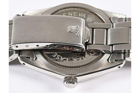

It might be OK as the writing on originals is a bit uneven. Look at the 'N' s in your pic @AndyGSi. And here's a genuine one I recently had - with 'N's are wonky too !
It was more the punched text as opposed to the detail I was looking at but I see what you're saying.
