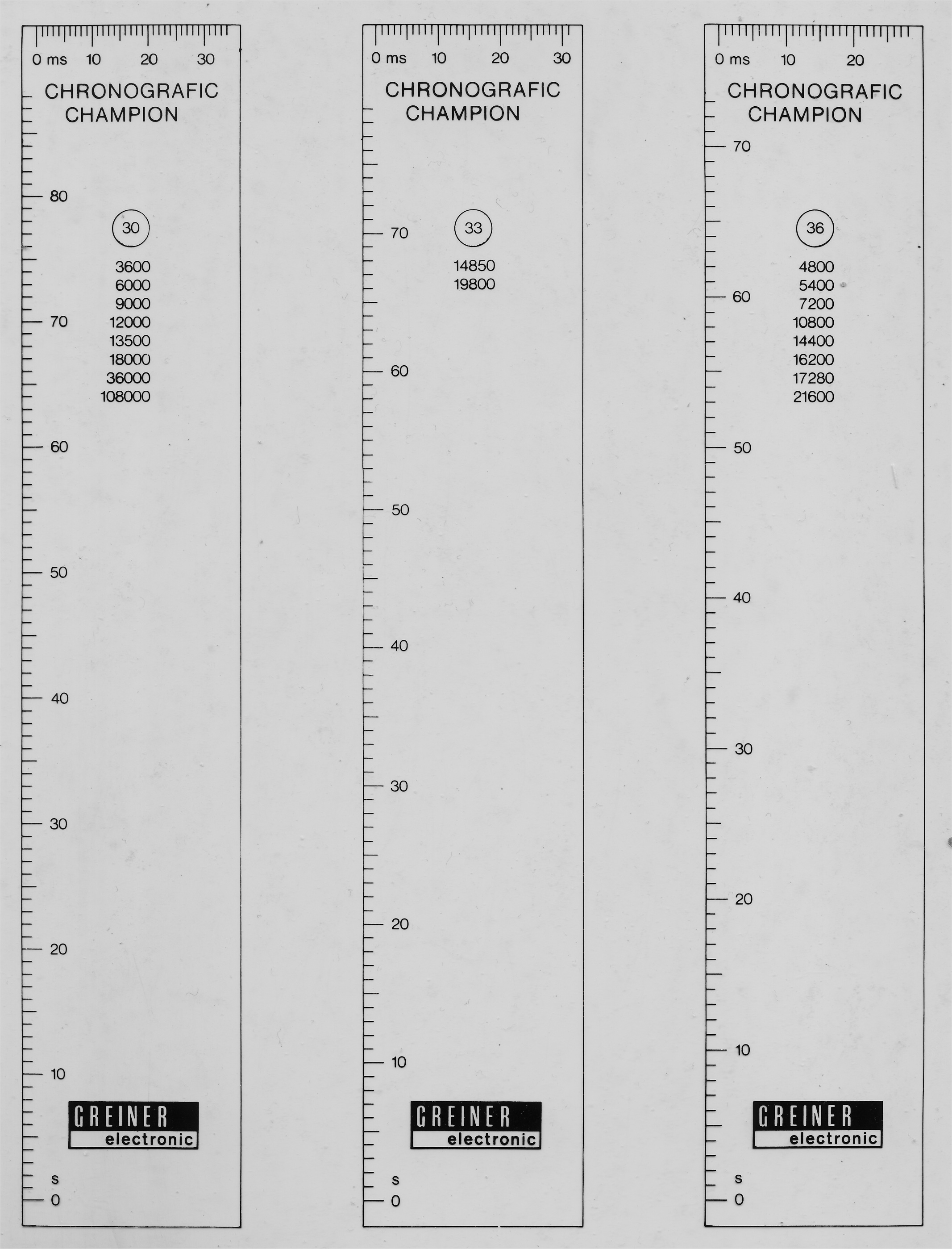

The amusing problem is the service manual does not specify a timing machine.  Not specifying an exact timing machine considerably that would be some variations but probably on paper tape machines they're all approximately the same. So that you don't have to do the math I've scanned the transparent ruler that comes with the Greiner timing machine manual. Although I don't see the frequency we need which is  28,800. Which I believe would be the one labeled 36 although I am mathematically challenged so Frank may have to verify that that is indeed correct.
 I'm also attaching the service manual at least what there is of it in PDF form.
Then for those nitpicky observant people of exactly how big is the image versus the original image I will measure the last one Number 36 5 mm  Is equal to 4 ms exactly.

In John‘s picture, left paper: drum rotates @ 30 Hz (see circle). That is the speed, if shown beat rate group was selected.
Assuming the paper width is 33mm. Then the paper width equals 1/30 s = 33ms or 1mm equals 1ms.
If the paper is 40mm:
1mm equals 33ms/40mm * 1mm = 0.825ms
If nitpicky, replace paper width by printing width, if not the same.
You can make cardboard rulers for your machine like Greiner showed.
Where does the 30Hz refer to?  I'm asking because the outer edge of a rotating object is spinning faster than further towards the axis of rotation.
It is the rotating frequency of the drum: 30 rotations per second.

Thanks for scanning that, very interesting. I hadn't really had an appreciation for how those old timegraphers worked.

So it sounds like up to around a 4ms to 5ms wold be acceptable and I'm getting around 1 to 1.5 so I'm not worrying about it. Not that I would have been able to do anything about it anyways 🙂
