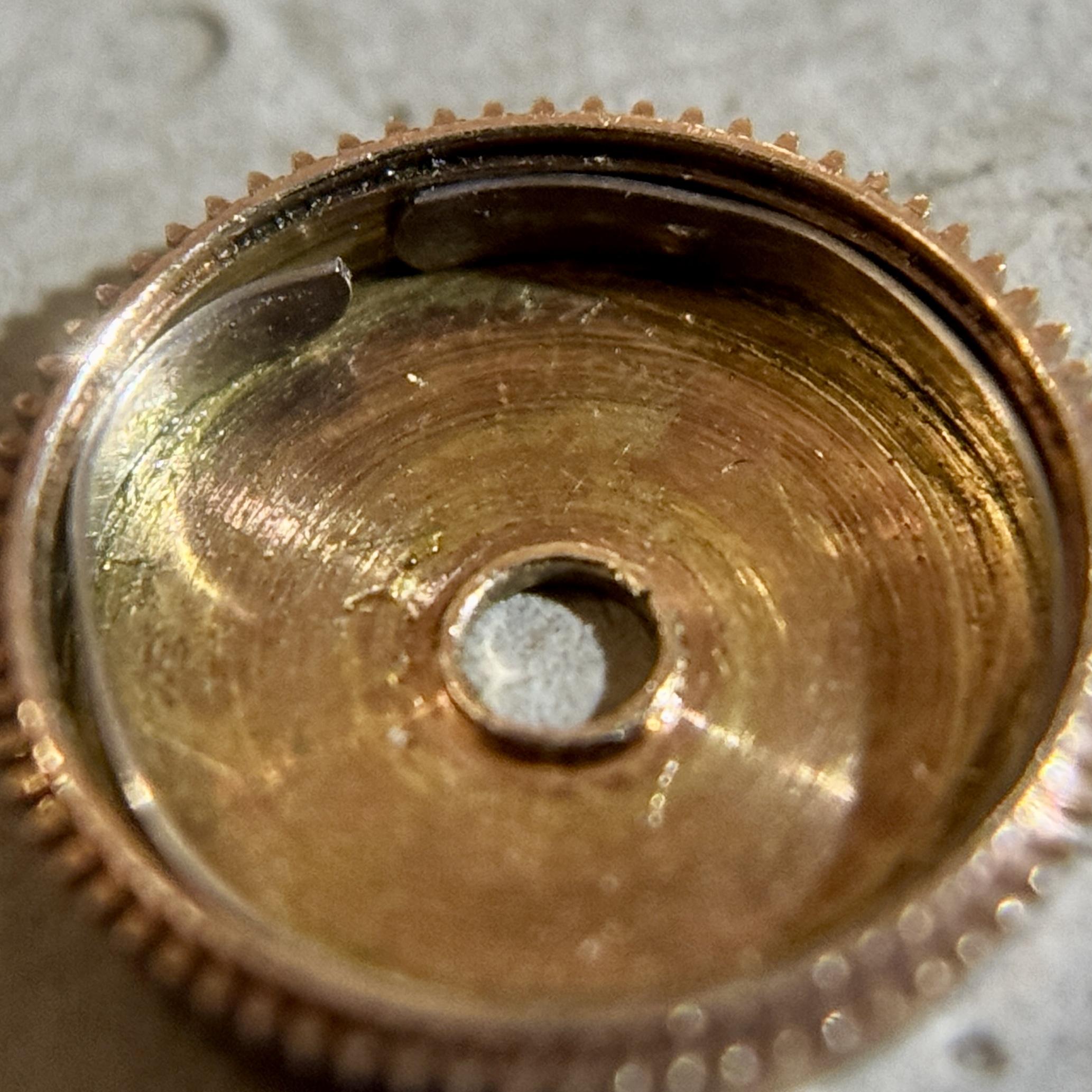

Sorry for the long gap, took me a little bit to get back to this project.
I started chasing down the idea of the bridle or barrel wall causing too much friction so when fully wound OR automatically wound, it would keep hitting that point of high tension and high amplitude, hence the rebanking. But when left to it's own, it would settle into it's natural state of amplitude.
What I've noticed in the process, that standard loose bridle for a MSN-29 (same as WA80) is too short for the barrel. As you can see in the picture, it does not appropriately overlap itself. The rest of the spring is getting caught up under the bridle and causing issues!
Further that, I noticed Tudor 390 lists a "MAINSPRING BRIDLE ONLY" in the parts list, A/1396. I'm suspecting, though I don't know until I get one, the bridle only is a special length to be substituted in.
More to come when I get this piece.
Just looking back at your earlier responses and you say you've used an MSN-29 Auto Mainspring.
If that's the case then why is that bridle still in the barrel?
MSN-29 = WA80
I have two WA80's on hand, both have a split bridle.
Bridle is in there for posterity sake and photographic evidence of what I observed.
So all the details I've found for both the MSN-29 & WA80 show attached bridles?
Also the WA80 is even stronger again at 0.10 thick which won't help.
When I get home I'll look at my packaging again, see if I can recall where I got the WA80. I took it out just yesterday and it was a split bridle.
