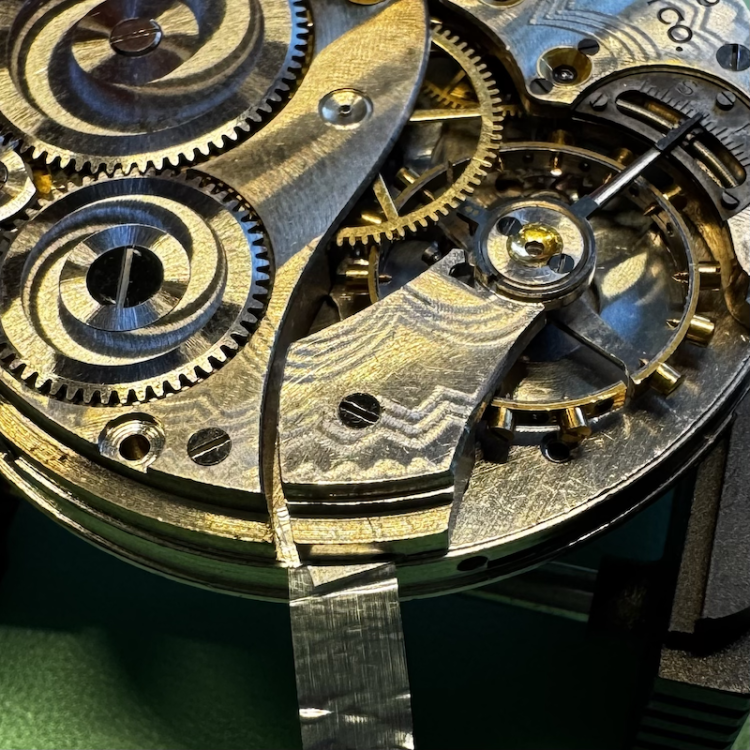

So here's what I did:
  1. Fold over a small piece of tin foil multiple times
  2. Place under the edge of balance cock
  3. Tighten
  4. Inspect end shake visually (by moving balance wheel up an down with tweezers, observing the roller movement)
  5. Use a puff of air to test rotation
I went through this process multiple times, with three key observation thicknesses:
  • NO foil: Lots of end shake visible. Puff of air spins balance, but when I rotate so dial is up (balance down), I can hear metal-on-metal and the balance stops spinning
  • Lots of foil: I found the point at which the thickness of the foil was enough to eliminate end shake, but also only allowed slight rotation of the balance wheel, but no ability to spin freely. In other words, just a bit too much, which I then backed off to the goldilocks thickness...
  • Goldilocks thickness: A very small amount of end shake visible, but not too much. Balance wheel rotates cleanly with a puff of air. AND (drum roll please), when I rotate the movement to dial side up after a puff of air, there is NO sound of metal-on-metal and the balance wheel continues to spin freely in this orientation.
The conclusion I draw from this experiment is that excessive end shake is at the very least ONE part of the problem.

The free play first: I would recommend to remove everything from the main plate and to put the balance cock only (no balance). But before that, if there are traces of 'repairs' like this
then smooth and flatten all the surface under the cock or the cock bottom surface beforehand.
Then fix the cock with it's screw and press it down on the stones area in order to bend it down a little. Then insert the balance and check the free play. You aim is to achieve what You call 'goldilocks' situation - there mus me almost no free play and the balance must turn absolutely free and all this without shimming. Of course, if the bending is too much, then You will use some lever to lift the cock or if the bending is not enough, repeat the pressing with more force.

Regarding the balance cock, there’s no sign of damage or tinkering on the base plate. Bending the cock seems like a really easy thing to mess up in an irreversible way. The benefit of a shim is that I can get it precise without any application of force. What’s the downside to shimming @nevenbekriev?
Oh and @nevenbekriev, your suspicion was pretty close in terms of what caused the wheel to come out of flat. I think the greatest harm was done removing the hairspring. The collet was on very firmly and I think I applied too much downward force to remove. Also, in the category of being a total noob, I think I tried to remove the hairspring with the balance resting on a piece of pith wood, as opposed to an anvil. Not smart, in hindsight.
OK, now I see You believe the balance got out of flat while removing the hairspring. It is not probable, but not impossible. But no matter, You need to true You balance. After riveting the balance staff, this is normal to expect the balance will need truing. Actually, we don't have idea how bad the balance is out of true, we only know the balance touches the center wheel and thus we can suppose as one of the reasons for it is balance out of true.
You can use truing calipers of whatever type You have. The 8-type I prefer is easier to use as it takes no time to open and close it. It can not  be used for the truing itself, as the pivots will immediately break. The other type can be used for the truing as the pivots do not contact with the tool and are thus preserved, but the riveting of the staff this way is subjected to significant pressure and if it is not riveted so firmly, the joint can move and it is very bad when trying to true the balance as every little move there will strongly affect truing. If the staff is not riveted properly, then for sure removing or placing the hairspring can easily bring the rim out of true
We need to see some video that shows how the balance turns in the movement and how it is positioned against the central wheel.
Shimming the cock is OK, but You have to check end shake every time You put the cock in the movement. The way You put the foil can not be the same every time and the foil itself will get thinner and flattened with every tightening of the screw. Regulating by bending the cock gives reliable result that doesn't depend on chance. Why do You think that bending the cock will  be irreversible? Of course, You can decide which way to use, both are possible.
 Your approach limits your adjusting  to integer number of folds.
One fold
Two folds,     ......so on.
You don't have 1.3     or     1.3758 folds.
 Just insert one fold under the cock,  then moving the foil with respect to cock screw, gives you infinite slopes of the cock, and  shoot for the  smallest end shake.
In practice, smallest end shake is, one that,
if cock screw is  99% tightened !!   balance is not free to turn.
But
When fully  100% tightened, balance frees up to turn.
It is a very practical approach.
