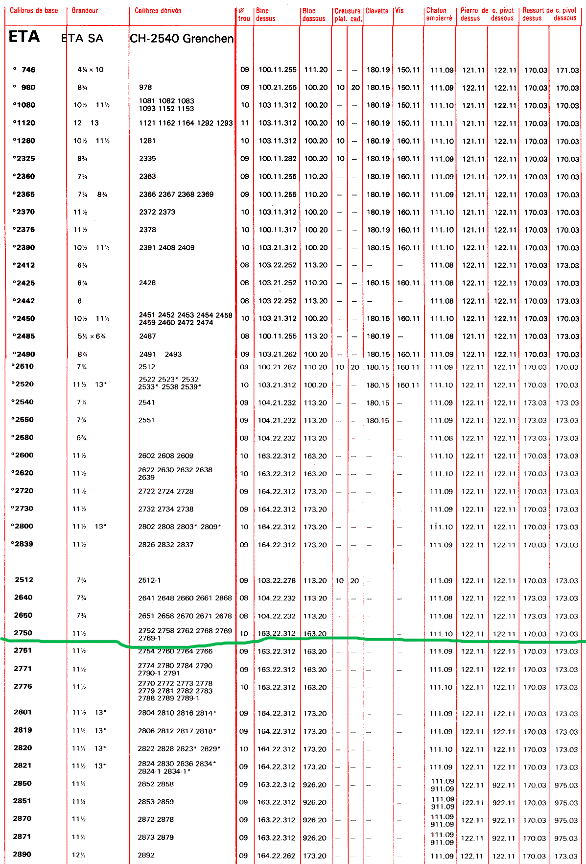

Lesson learned, I'll make sure I lead with more pics in the future. I'm sure at some point I'll find a use for this chaton... I also had a look online and can't find anything matching this either. Even other images of Hamilton 649s show standard Incabloc springs instead of these weird things.
I did see one image which did seem to show a similar spring, but I can find no references
It's a KIF spring 5 -  for the ETA 2750
Wow, that's a fantastic find, thank you! I see what I should have been looking for now on EmmyWatch - this will be super handy in the future.

currently I'm looking at a different source which is best fit online. Does not list the Hamilton number at all I was hoping for a confirmation of yes they really are exactly the same. Then the editor part number comes up very clearly as a 170.03. Which your spring in your picture very definitely is not that spring.
this brings up the problem of assuming that a watch has only been rebranded when typically they are not 100%. So basically the base caliber is ETA but Hamilton has modified it. Which is why the balance jewels are not right because they're not ETA balance jewel assembly or the spring for that matter
