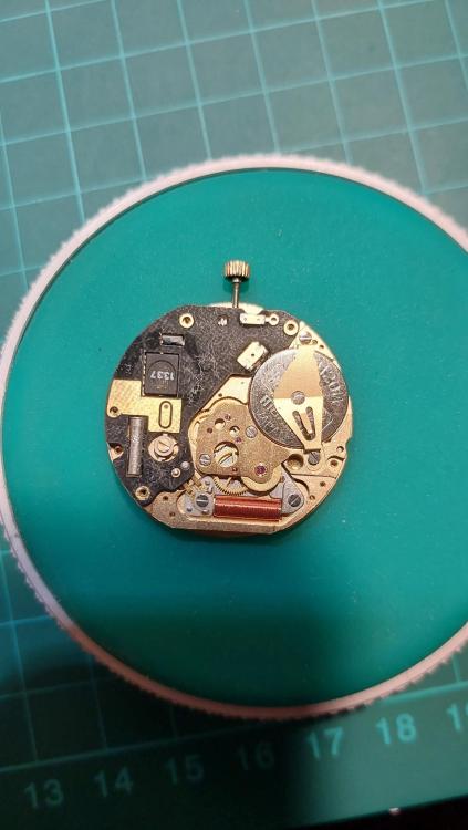

Have recieved a non running Omega DeVille 1337 from my brother.
On recieving the watch I found the 2nd wheel had some of broken teeth which I thought would be the issue. Found a corrosion damaged donor movement, replaced the wheel and got the gear training running smoothly, but watch stil isnt running. The coil has a resistance of 3.5k ohms so I believe its ok.
Can I get some advice please on how to troubleshoot if the chip, crystal or stepper motor is the issue please? I only have a digital multimeter, not an analogue one unfortunatly.

then looking through number 18 you'll come to the page that I snipped image from we get technical specs for your watch
this is where it be nice to have some test equipment because unfortunately circuits without test equipments are basically black boxes that there isn't a lot we can do with. then your measured coil resistance is within the specified range.

then we can only go so far but let's follow the testing procedures. With the battery in place they give you test points ideally for the plus you would like to put it on the plate someplace and not on the battery even though it shows contact with the battery. The reason for this is you want to make sure that the battery power is actually going into the watch and there isn't a short or something else somewhere.
Then yes analog meter supersensitive one would be preferred. You can then check for the impulses to the coil. With a digital meter you'll probably see something as opposed to just sitting there and doing basically nothing. With analog meter on the most sensitive settings what you typically see as the output polarity changes each time the stepping motor steps you would see the alternating movement of the needle by a little bit. So you might build a sort of possibly see that with the digital may be but there should be some sort of change their
then we basically come to the end of the testing that you can do with what you have. Ideally it be nice to have a variable voltage power supply and the ability to measure microamps including fractional microamps. Personally I prefer an analog meter over a digital meter here. Because then we can see what's going on as opposed to we can't at all
then the Chinese do make some inexpensive diagnostic things and somebody will come along eventually and tell you about their nifty device that does nifty stuff. otherwise the Swiss make a whole variety of test equipment but it's hardly worthwhile unfortunately for one watch.
Although? One of things you do is take out the wheel next to the stepping motor. The stepping motor rotor is only turning itself and see if that will turn. You might have to put a Mark on the rotor because when it steps it may actually look like it didn't step would off. So sometimes a small mark on one side than you can tell but it actually rotated. In other words you just trying to get the stepping motor to step if that works you can start to add the rest the gear train in.

Yeah regarding the broken teeth, there is a magnetic washer on the seconds pivot, I believe the last person in there wasnt carefull when assembling and tightened the bridge without properly alligning the intermediate wheel teeth above the washer.  would be an easy mistake to make.
I have already tried removing the wheel next to the rotor and stil get no movement in the rotor unfortunatly.
Ive just ordered a cheap analogue meter so should be able to do those tests in a couple days, really appreciate you findig those documents for me!
Im concidering swapping the crystal out of the donor movement as my last hope.. the chip on the donor movement is obviously fried but guess theres a chance the crystal might have survived.

I've be working on a 1337 recently. It was very corroded and had green, powdery residue all over the battery contacts.
It cleaned up very nicely, leaving no trace of any previous battery leak. The coil resistance is 3.5K, which is within specifications. But the movement doesn't move when powered up with my Bulova 700 meter. It shows a short in the circuit.
There are only 2 discrete components on the PCB, the quartz oscillator and the variable capacitor. I have desoldered both of these and the circuit is still shorted. So the short must be inside the IC itself.
