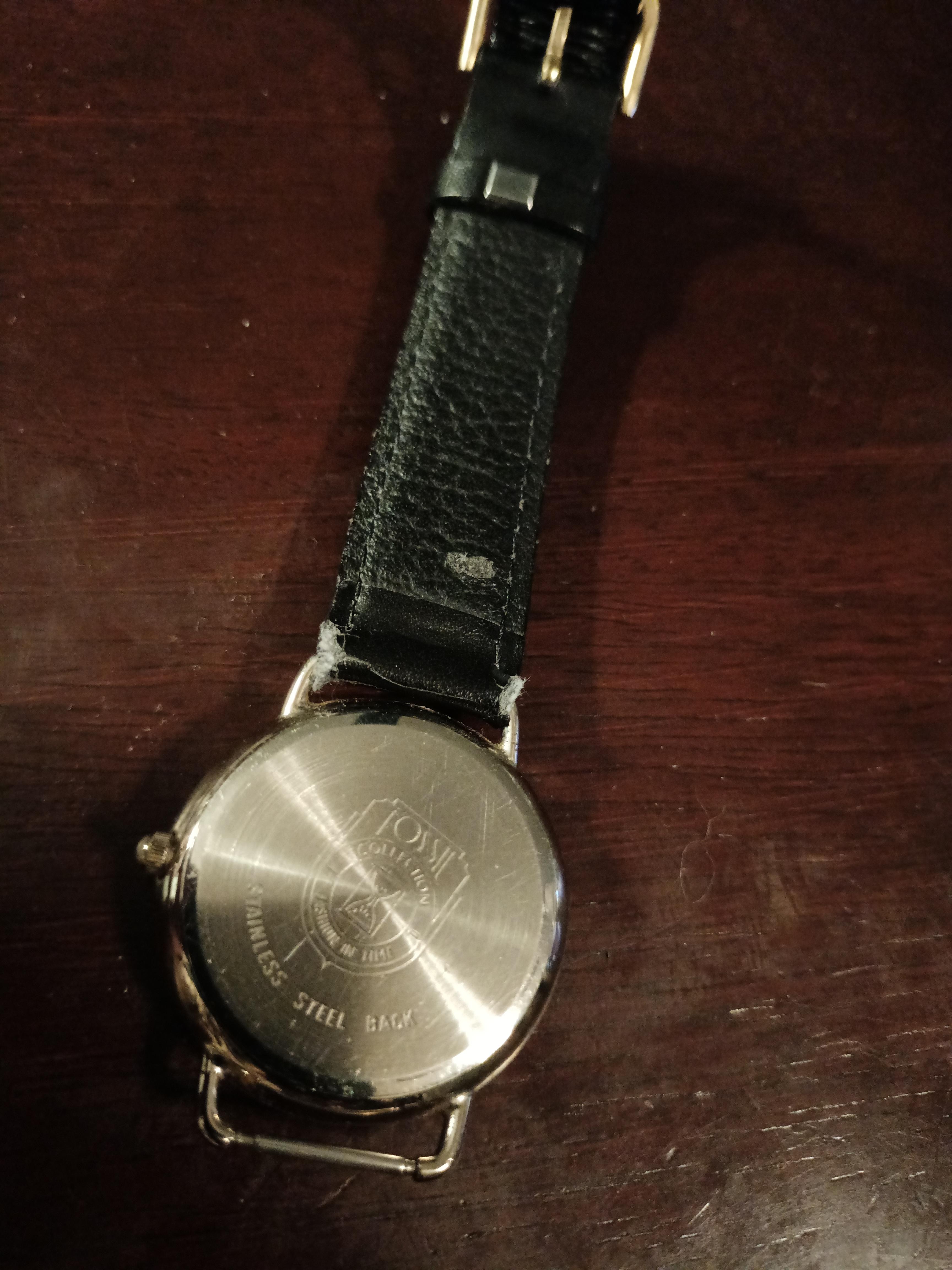

Another watch that was included is this old fossil watch with floating gears that appears second hand fell off and air must have gotten in and oxidized the gears etc...  is this serviceable?

On that Fossil, I have to imagine the liquid filled chamber is encapsulated away from the dial and hands. It doesn't look like the seconds hand is floating around in the fluid, does it?  Or if it is floating around, are you sure it isn't supposed to be?
I just found this similar or same model on auction and it looks like the seconds hand is intentionally floating around with the gears. The handful of these I've seen photos of all have a bubble like yours. I would bet that if you open the back and remove the movement retainer ring, the dial will just drop out as a normal 2 hander.
(P.S. - I can't help but notice that's an escape wheel from a pin pallet movement sloshing around in there)
Here's another one, although it is a 3 hander, there's still a seconds hand floating loose. (and an escape wheel from a Swiss lever escapement this time)

Yes it appears to be the case with the fossil watch the needle intended to float around.  I am just wondering if it's the liquid or crystal causing the clarity issues.  I am not sure if polishing it will help or maybe heating the liquid up etc...
