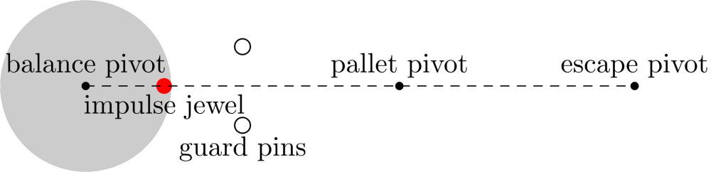

Here is a video showing the balance free run test screwed in -
And I checked carefully, here is an updated diagram of the jewel’s position on the balance vs the guard pins and escape wheel.
Edited by SiZi
As @caseback pointed out, the stud carrier is way out. The impulse jewel should come to rest on the line that joins the pivots of the escape wheel, the pallet fork and the balance wheel, and that line should run right through the middle of the two guard pins. Something like this:jewel-001.thumb.png.8017bf4f93598590cd1ad93683b74e51.png
From your diagram yours looks to be more like this:
To fix this you should gently turn the stud carrier anticlockwise towards the balance cock with the balance installed, until the jewel comes to rest on the correct line.

No, you don't need to do any of that. It's much simpler on your watch because it has a moveable stud carrier. The way Mark is demonstrating in the video is how to adjust it if the stud is fixed directly to the balance cock. You might have to do that if the jewel position was WAY out, but I don't think that's the case here. The whole point of a moveable stud carrier is to make it possible to make this adjustment without removing the balance and fiddling with the collet. All you need to do is move the stud carrier, as I indicated in the marked-up still I took from your video.

I tbink we could use a photograph of the balance, the guard pins you mention, these are the horns of the fork, the cental finger is the safety gaurd,. Learning correct names will prevent confusion 🙂
The movable stud carrier is not intended/suitable to adjust the position of the impuls jewel when the movement is in rest AND the pallet fork is attached. You use it when the pallet fork is out to set it up "about right" and you can use it when the movement runs to do a fine tuning of the beat error if you have a timegrapher or other timing instrument.
If the impuls jewel (when in rest and without the pallet fork removed) is approx in the middle of the banking pins it is ok and it will not cause the movement to stop. The movement is loosing power somewhere else.

It sounds like you have interference between the impulse jewel and either the guard pin or the fork horns (or both). By the way, the, the fork horns are what you are calling the "guard pins of the pallette fork".
Remove the escape wheel, the rest of the train, and all cocks and bridges on the movement side. You want to have just the balance and the pallet fork interacting with one another, and the best view from all angles that you can get. Ideally you would remove the hairspring too, but if you feel unsure about that, leave it.
Observe the interaction of the balance with the pallet fork. Take some good photos if you can, and report back.

Ok here is a video showing the escape wheel pivot point lined up with the pallet fork pivot point lined up with the banking pins and the impulse jewel.
Does this look ok? thanks so much for all your help!
Also here’s a pic showing the line up. I’ve tried to highlight where the banking pins are in case you can’t se them clearly.  IMG_0810.thumb.jpeg.ad751fd473c587827217313b8d3d3656.jpeg
As already mentioned, if it's about centered it will be ok and not be the cause of the watch stopping.
You mentioned that the escapewheel comes to a gentle stop. That is nice, but no guarantee. You also seem to have some doubts about the pallet fork's "snap".
Sometimes an escapewheel spins great when the train is not under "load", but with some wind and the pallet fork preventing the wheels from spinning, other factors come into play. There was a post on this forum very recently where the train of a desk clock of some type spun great when free, but not under load. In the end it turned out one of the wheels had a broken pivot.. Just saying, don't assume the pallet fork or balance are now the only 2 options left.
