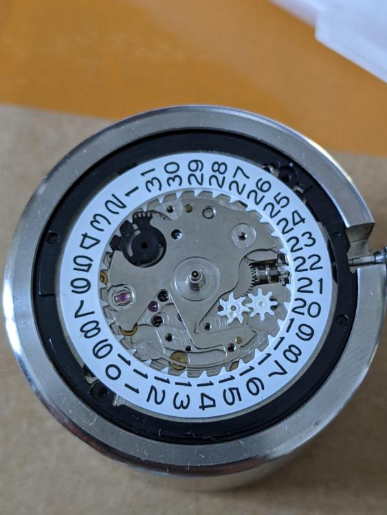

Hi I encountered an issue that my seiko 7s26 calendar 'day' not aligned properly after 24 hours. Date no issue, quickset also no issue. I have replaced the date driving wheel, the issue not solved. Please help.
 I gather day disk isn't dead stuck,  WILL CHANGE but consistantly  LAGS behind by a few hours.
Day disk misalignment  is in genetic code of Seiko 5.
Its not worth buying parts for, just advance the day disk on gear attached to the back of it to compensate for the lag.
Good luck.
The star (gear) on the rear of the day disk should be fixed and not moveable.
If it needs to be realigned then it also needs to be secured back in place.

Hi thanks for the replies,
if the problem is the alignment of star behind the day disc, why the quickset of day no issue?
Initially I suspected date driving wheel which will push date ring and day disc after 24 hours, but date no issue. But day disc cannot aligned.
I hadn't seen about the quickset, so back to my original question.
What version of the 7S26 and what wheel have you replaced (Part No.)
Also how does Day-Date Correction Wheel look?

A common fault with the 7S26 is the star on the rear of the day disc coming loose and creating the misalignment.
This appears not to be the OPs problem as the quickset works OK.
On 9/30/2024 at 12:27 PM, caseback said:
Just to clarify: if you say "quickset is not an issue", do you mean that if you use the quickset the alignment of the day disk ends up ok?
Yes, both Day and Date aligned properly with quickset
What happens when you manually advance the day by passing midnight?
How do the white star wheels in your photo appear to operate during this transition?
Edit
Can you post a photo of the date dial guard.
