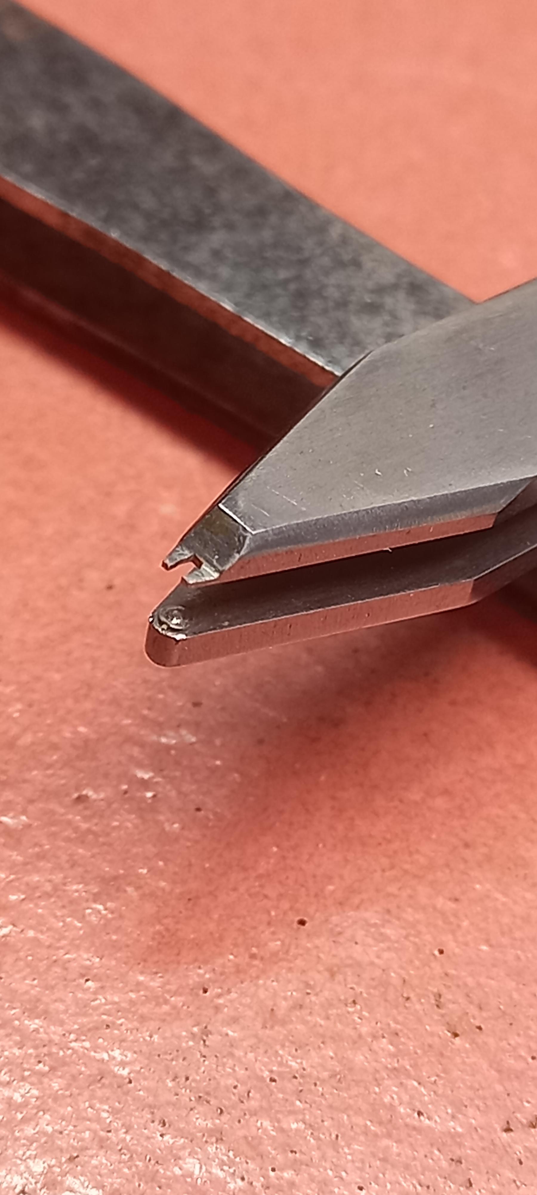

Yah that’s a good way to think about it.  Since I have the pivot tool from my Seitz set I give it a go with the expectation I may be replacing the staff. I’ve had great success with the tool though, a great time and hassle saver when it works. I’ve only had couple two or three snaps out of six or seven, one while learning how to do it and one where I miscalculated the pivot width and went too small in the jewel hole…
…I don’t understand the heat/cool idea- ‘twas bent at room temperature and it didn’t snap so just bend it back. I’ve done the following for wheel pivots, too…
42 minutes ago, JohnR725 said:
It helps to have the right tweezers and the right procedure with tweezers. Yes like everything in the world there's procedures like if the tweezers a heated up not red hot but they have to be hot hot enough you can't actually hold the tweezers. When I was in school the instructor had the tweezers with strips of wood to keep you from burning your fingers. Then it hit it with an alcohol lamp and that's how he would do that. Plus of course the right shape of the tweezers conveniently I don't remember what they're called I'd have to get a picture.
These ones I think John, the small set is Favorite and the large Dumont
Tom
Tom
Oooooh Tom , now I've got some tweezers this thick and i wasn't sure what they were for, still dont , but it could be adapted,  now i can sell my bergeon straightener lol

Yes it's the large one that works fine for straightening pivots at least if it's warmed up.
