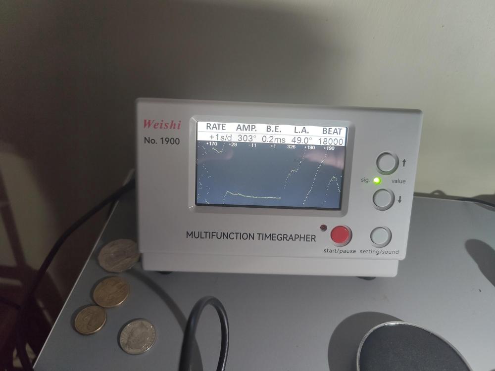

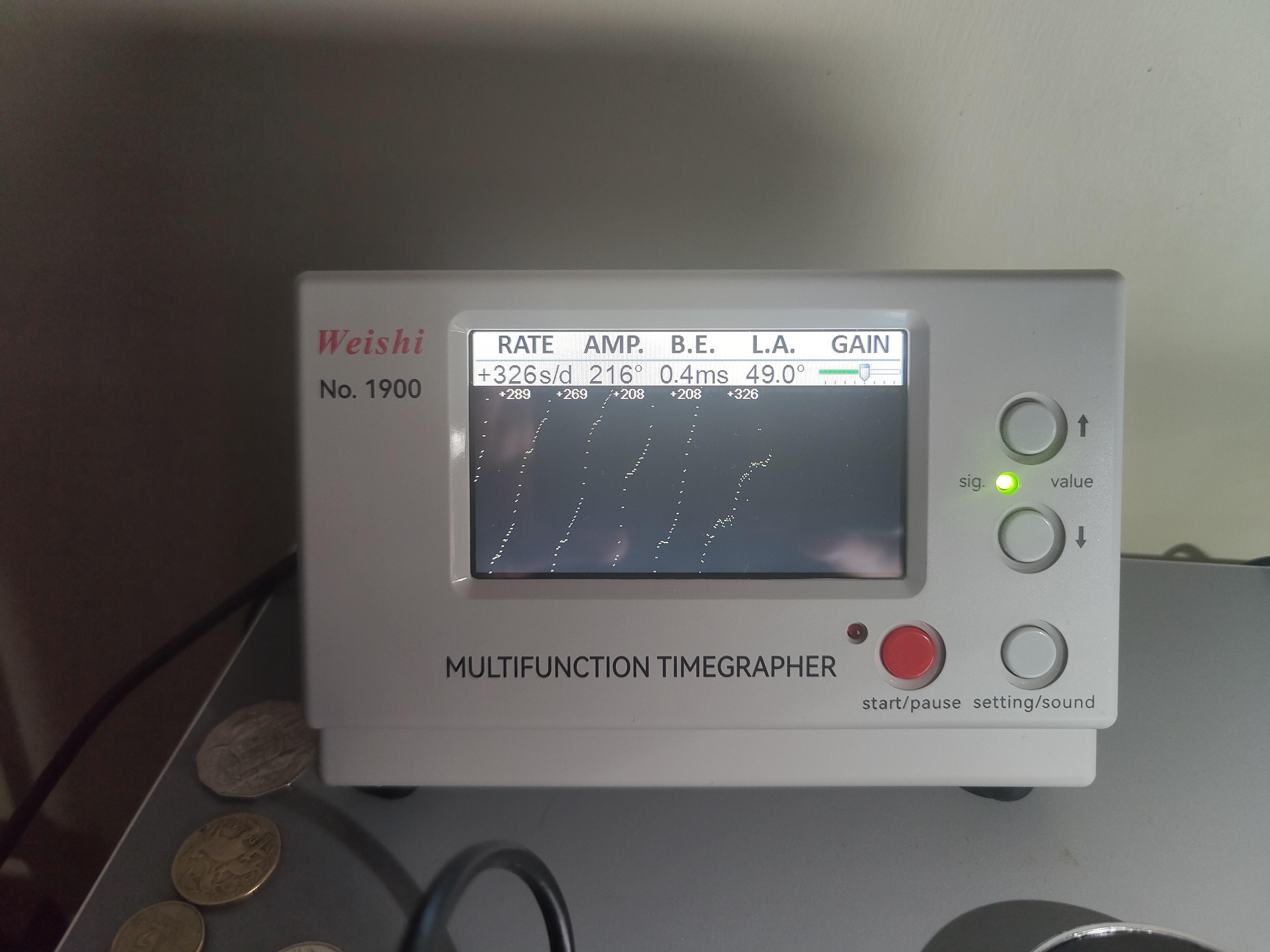

I have just serviced a Vostok 2234 (basically a 2209 with a calendar and hacking). This always ran erratically when cased, periodically stopping. It looked like something was clashing when cased as I noted that touching the crown (pushing it in towards the case) would make it stop. It looked to me like there was some case screws missing and the movement ring might have been touching the stud carrier on the balance cock. When I could keep it running it gave  about +30 / +20 DD and DU. Amplitude was about 180. It definitely needed a service - out with the movement and onto the bench.
After service the watch performed a lot better. Amplitude around 300 and similar dial up / dial down rates. After sitting and watching the timegrapher for a couple of minutes the DD rate suddenly went very erratic - +200 and amplitude dropped to 200 then it would veer to -125 with an amplitude like 316, bouncing around a bit like this before settling back to 295-300 degrees and about +10 SPD. Checking this with a stop watch it has a cycle of running well for about 3 minutes before the amplitude drops off and the rate flies up.
It carries on like this for a few minutes before settling back again. A total cycle (going from 300 degrees down and back to 300 degrees) was timed consistently around 7.5 minutes.
I can't see anything on, or around the hairspring. Could this be something in the train, on one of the wheels causing it? It's periodic nature strikes me as being train related. Pretty sure everything was clean and undamaged (though that movement  has the strangest train of wheels I have ever seen).
Could it be the spring inconsistently delivering torque? Binding and releasing?
Two timegrapher shots showing the rate when amplitude dips and one when it is stabilising again (you can see the mess still on the screen).
IMG_20240731_234651.thumb.jpg.a2903f206bedb8281d6dd20f7e4e0bc2.jpgIMG_20240731_234704.thumb.jpg.b1cca7cab67ecf1e2c02c58fef975440.jpg
Looks like it could be re-banking from too much amplitude.  Are you sure you have the correct lift angle set ? Can you hear it making a galloping sound when it does it?
I have a cal 2414 which has a 42° lift angle. It also has a high amplitude, but avoids re-banking.
Does it do it if the movement is vertical ?
If not re-banking, could be coils sticking together. Sometimes it can be really hard to get all the sticky gunk off hairsprings.
I assume you have demagnetized ?
Edited by mikepilk
40 minutes ago, rehajm said:
Like mike, maybe sticking or rubbing once it gets a head of steam…or how long has it been running since lubricants? Hours?
Let a few turns off the mainspring and see what happens.
These movements usually have shims under the balance cock, so check that the end shake is OK.

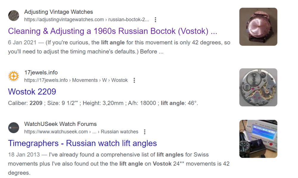

I got the lift angle from a WUS thread which had a .JPG with a massive list of lift angles for Soviet watches. 42 for 24xx and 49 for 22xx it said. Obviously it would be good to get some independent verification of this now, so I will look around.

The 2209 lift angle should be 46 Deg so expect the 2234 would be the same and the amplitude would then be a lot lower.
It could well be. It definitely will be the same as the 2209 so, will check that out.

What is strange is the timegrapher results look better for when it's running fast.
When it's running well, it gives a nice smooth line, when bad it seems to be missing ticks on the graph. You can see it in the second picture after it has stabilised and started running well again towards the bottom of the screen. Nice flat line while the rest remaining on the screen is garbage.

Yes, I will have to do this.  Searching around on the internet gives conflicting results. I could always split the difference and test at 44 😀
28 minutes ago, AndyGSi said:
Everything I've seen for the 2209 shows 46Deg with the 24** being 42 Deg.
Yeah, 46 degrees seems to be the consensus. I will stick with that.
