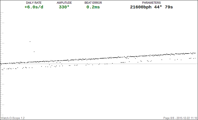

I've also been working on some improvements to the software, specifically in the area of beat error determination. Right now, if one has a somewhat noisy watch, where the ticks occasionally seem to occur too early for reasons other than beat error, this throws off the beat error reading. My improved algorithm is very good at ignoring these spurious sounds, resulting in a much more realistic and steady beat error display.
Here's an example:
With the previous version of Watch-O-Scope, this would have given a beat error reading of around 0.6ms, whereas you can clearly see that the new reading of 0.2ms looks about right (the ticks on the left hand edge are 1ms apart).
I've applied a similar change to the amplitude averaging (the amplitude shown here is probably too high, because I don't know what the lift angle is for the Sea-Gull ST-19 that I was testing, and I doubt that the value of 44 that I came across somewhere is correct).

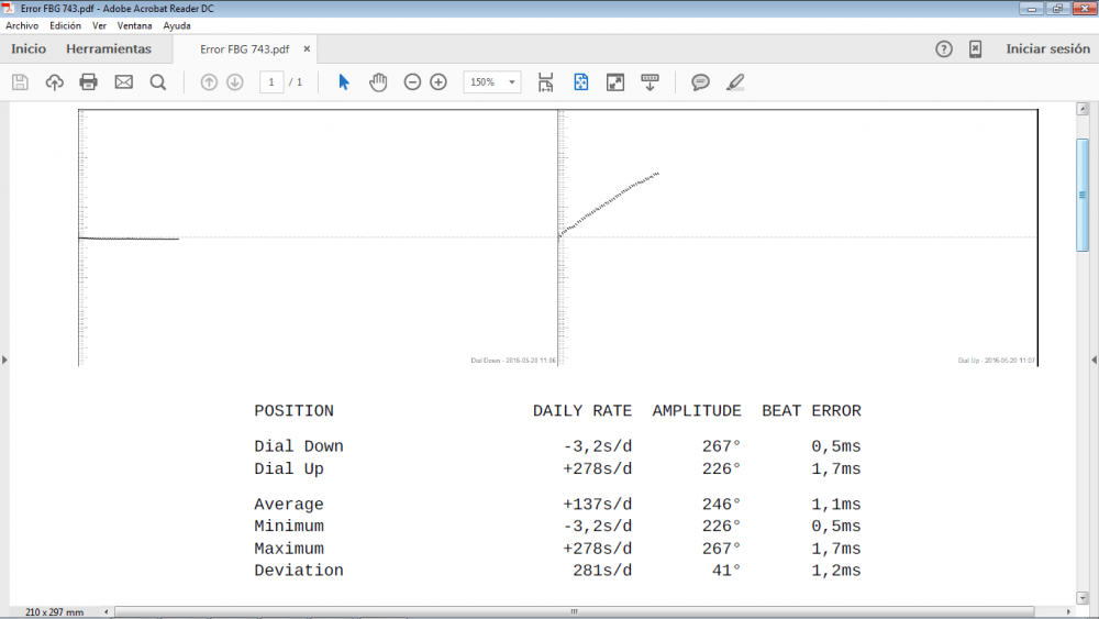

One of the most versatile features that positions almost on all Timing machiene software watches is "Annotate" and "Generate Report". Allows the study of watch performance in different positions and also create a log report to compare results in different positions. Great!
Here is a screen shot of report in pdf.
