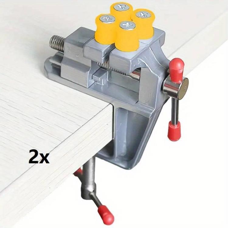

I've attached 3 pics... would these be any good?

I like that you have a procedure you know what you're doing or do you? I don't suppose we can have a decent picture of the back of the watch and a side view of the watch?
The case opener in your first picture is for Rolex style casebacks.
The case holding vice in the second picture is cr*p. The moment you start turning the caseback, the entire vice would turn together with it.
The crystal/caseback press in picture three would probably work. But you have to make sure that the screws of the upper and lower tool holders are properly aligned. Some of them don't line up properly.
If you're using a traditional caseback knife or a Swiss Army knife, you're chances of slipping and scratching the caseback is very high. No paper or plastic sheet will be able to protect the surface if you slip. The secret is not to slip. 🙄
A Seiko style caseback knife is less likely to slip. It is used with a stabbing action to wedge the blade under the caseback. Don't try to pry/lever the caseback off like a tin can, that would only lead to slippage. The wedging action would pop the caseback off in most cases. Only in really stubborn cases where the blade has wedged in but the caseback still hasn't popped off, then some twisting and levering is permitted to lift caseback to pop it off.

my, and most case vices can be used in a bench vice to give you extra stability or be hand held.
what he was trying to get over as well is our natural tendency is to twist the tool to open the back, this is not the way to do it but using the tool to wedge the back off is.
