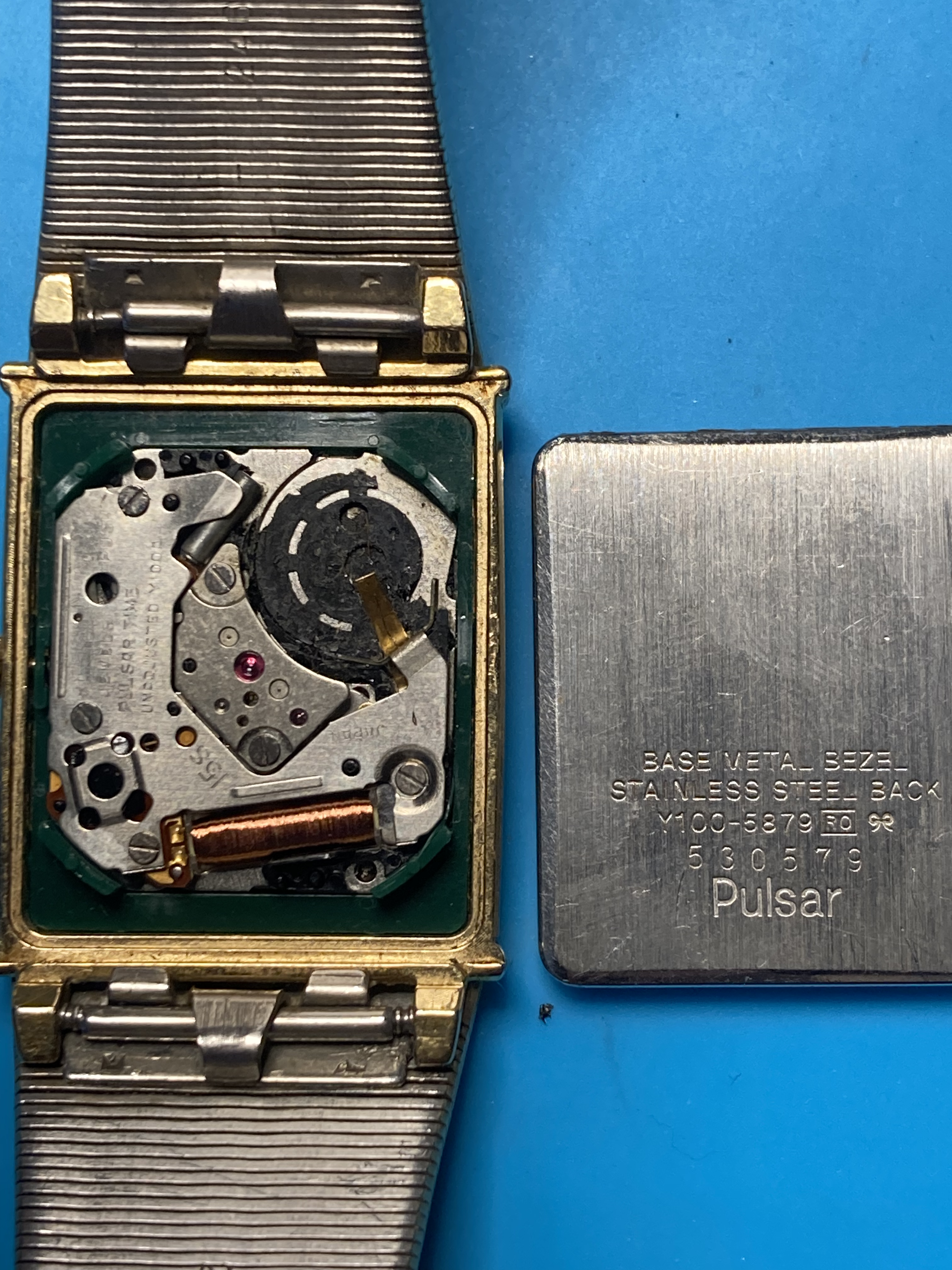

I have two of these mens Pulsar watches. One is running, but the other needs a new movement. I have tried to find another one and I am not having any luck. I have gathered the movement is Y100A. Maybe it is discontinued?
Also, the crystals have minor scratches on them. Is there a way to buff these out?

Hi.  The crystals will polish out ok ,  Sovol autosol. Chrome polish from your auto store will do the job, takes a bit of effort but it works for surface scratches.   I think the Hattori VX43 would be a close match you may have to alter or remove the dial feet and use dots.

How does that work Andy ? I usually test the coil and circuit boards for continuity
I understood that the field generator acted on and spun the permanent magnet rotor to turn the train.

Just place the watch over the MECANIC part and activate it.
The magnetic field will induce a voltage in the coil and cause the hands to rotate.
This does sometimes help to free a stuck mechanism where you can see the second hand
twitching but not moving, but the main purpose is it shows the coil doesn't have a break.

Ah ok, i didn't know it worked in that way, i tnought it worked on the rotor.

It doesn't work that way. You can remove the coil completely and the line release tool will still rotate the hands.

Never really sat back and thought about it to be honest but yes you're right, it is the rotor
that causes movement so as @HectorLooi said it would still work with the coil removed.

Haha dont believe everything that you hear Andy, I only knew because my introduction to watch restoration was pulling apart and putting back together hundreds of scrapped quartz watches. Now you can sit there and question if what me and Hector told you is true 😆

No, it doesn't work this way. You can rip all the wire off the coil and the hands will still turn on the magnetic field generator.
As stated by Neven and Hector, the tool generates an alternating wave form which pulses the rotor. With the coil off and the circuit block off it will spin the rotor. For an understanding of how quartz watches work read the attached documents.
a cheap line release tool can be made from a low voltage transformer or a mains transformer the active ingredient being the generated wave form. Introduce the watch and the wave form acts on the rotor

If the crystals are glass as i thought they might be then no the autosol or any other polish unfortunately doesn't work unless you are prepared to put in lots and lots and lots of hours on it and then a few more hours.  Dont try sandpaper as you wont get those scratches out by hand either, its not fun unless this is your idea of fun. Best bet Melissa is going to be diminishing grades of diamond paste used with a mechanical buffer.

The autosol is good for acrylic,  but removing scratches from glass is much more difficult. If you can feel the scratch with your nails then its not going to be easy
