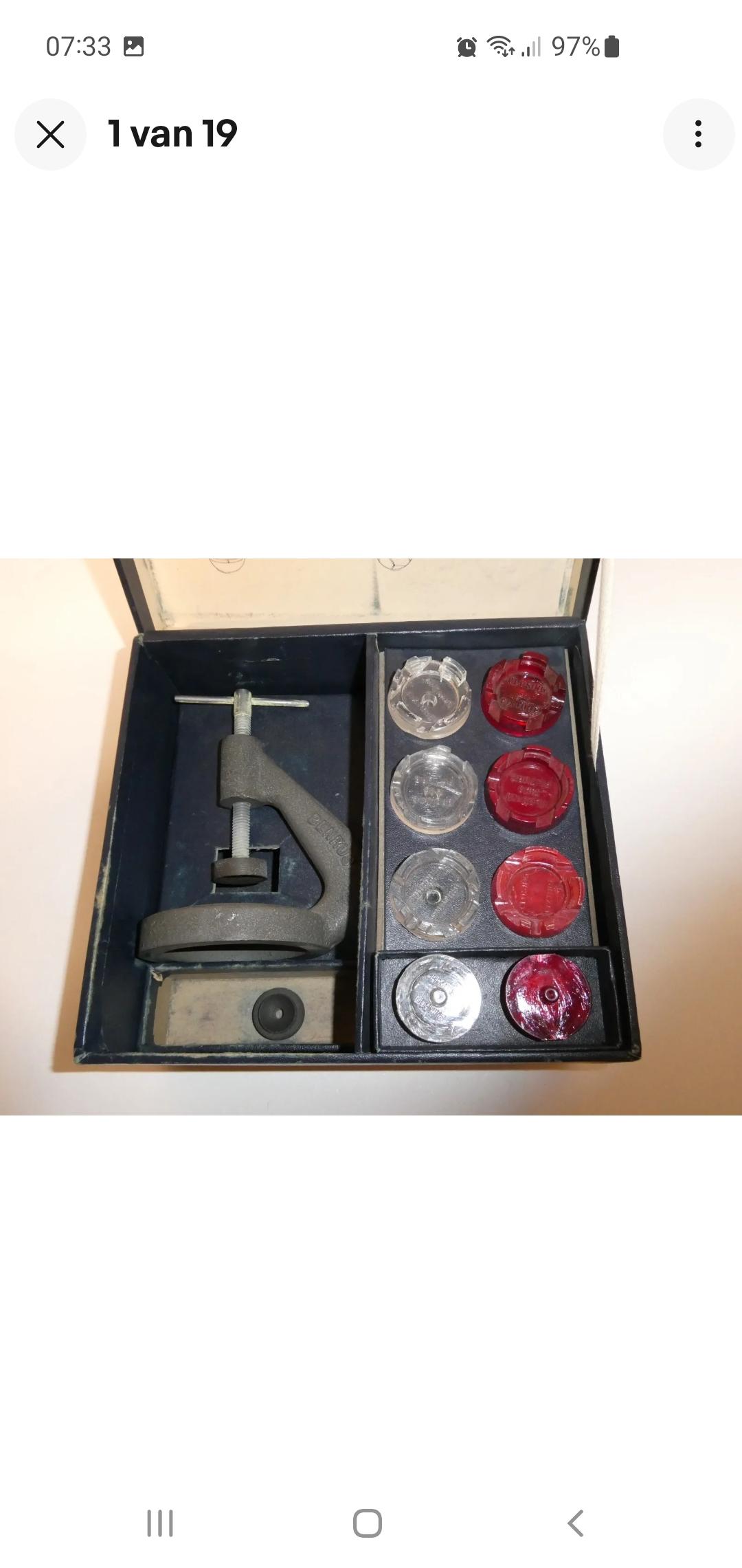

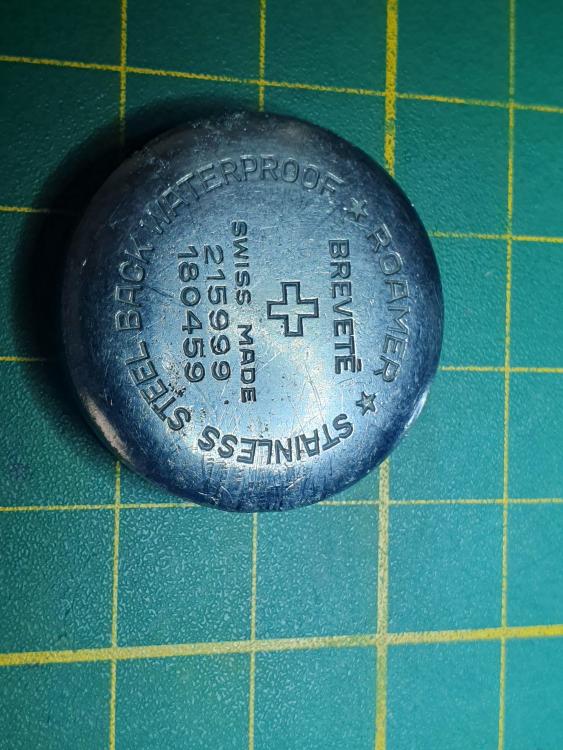

Benrus indeed has models with a kind of 2-piece case where you have to press on the crystal to remove the back after you remove the crown (split stem). Roamer had a simular system. Benrus sold specific tools for that purpose. I had one of those tools, but it was incomplete (just the box and the press) so I sold that to a Benrus collector.
You can still find these sets. Often the pictures also show the instructions for removing and assembly. There's on on the bay right now:

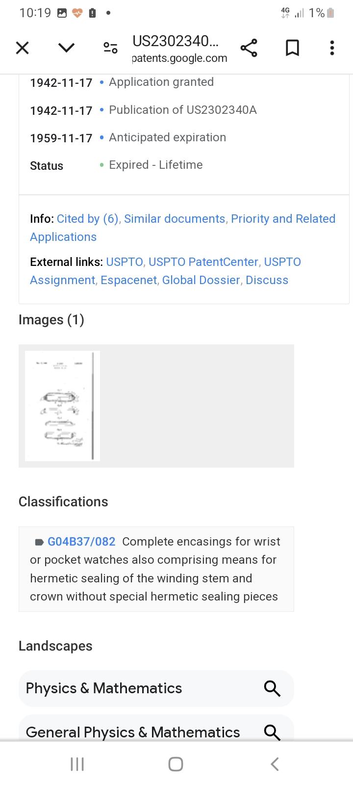

Patent numbers can sometimes give us clues to things like this .Screenshot_20240630-101919_Chrome.thumb.jpg.f8fb10232b8c001afdb4189fd4994a7a.jpg

Good digging!
Indeed the same principle as Roamer's. Different patent?

Worth a try. Should work. I'm not a big fan of these presses though, as it is difficult to "manage" the amount of force. That's why I practically never use the Bergeon 5500  but prefer the screw down type press:
The Roamer sets come up for sale often, and are usually cheap. And as a watchmaker's purpose in life is to collect tools....

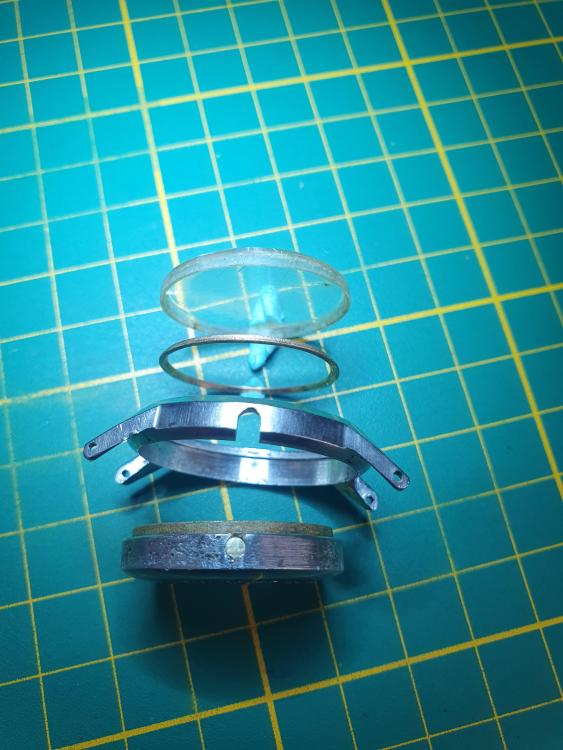

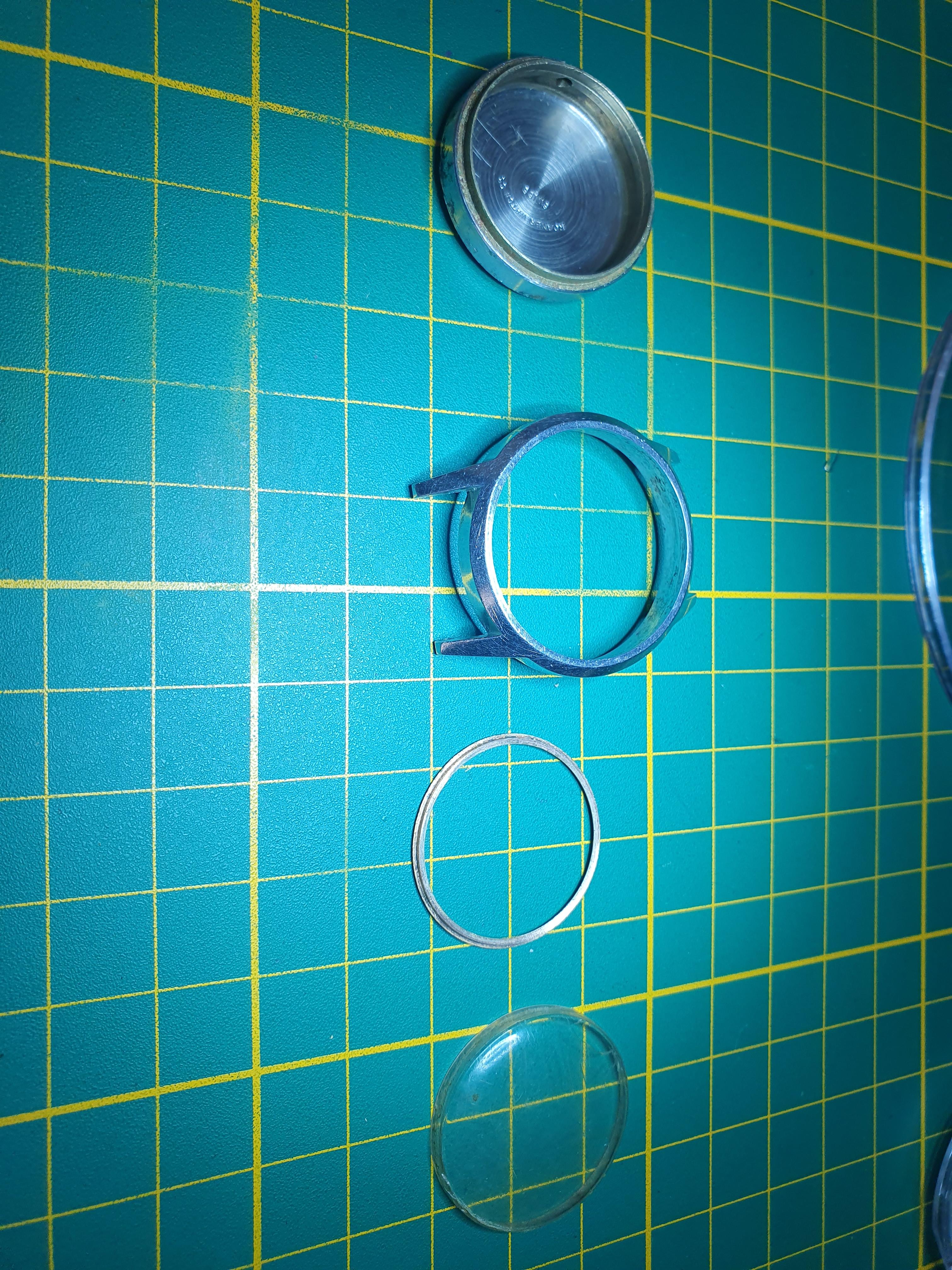

Thanks again guys!  Always great advice.   Popped off the stem, put the watch in the press and the crystal, movement and case back came right out with just a little bit of pressure.

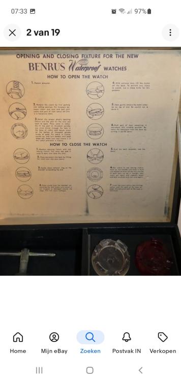

Bulova also had watches with this style case so they also sold their version of a press. These purpose-made tools are nice, but as you found out you can find other ways to push them apart and together.
My advice is to be careful with the crystal on these - they have a unique side wall geometry (as shown on the patent diagram above) and are not that easy to replace. Some NOS crystals are out there, and there are some ways to bodge other crystals to work (you can search for some other threads here on WRT) but it's best to maintain what you have if it's not badly damaged. The "official" opening fixture has a wide clearance so the crystal isn't subjected to pressure when the case is popped apart, and the closing fixture very tightly conforms to the crystal so the pressure is evenly distributed during closing (see picture).
Thanks for the info Geotex.  I did press it back in with my press and it went in without any issue so I may have dodged a bullet there.  The crystal is not in great shape.  It has a lot of micro cracks around the edge.  I ordered a PHD 25 (28.5 mm) crystal.  It seemed to be a good match in terms of shape and the diameter was spot on.
I do have a bit of experience reshaping them if it’s not quite right.  We’ll see how that plays out.  The dial and the case were both sort of a mess but they cleaned up nicely so I’m hoping that I can get a new crystal to fit (see pic).  Thanks again.
So the PHD 25 28.5 mm crystal did not work due to the custom shape of the crystals used in the Benrus waterproof models from this period.  Luckily, I kept looking and was able to find the exact Benrus NOS 28.5 crystal that was used in the 3 Star.  A perfect fit!  See pics.
