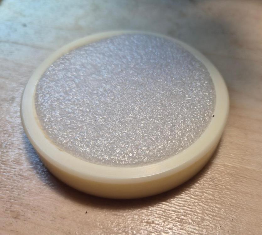

Eyup evening (UK) watch folk.  You may or may not know i like to make my own stuff for the watch repair addiction.  Thats the Yorkshireman in me, i got a bit bored with my movement cushion so i decided to procure some ideas of what makes the perfect material to work on. You may not use a cushion, i seem to switch back and forth with a cushion and a holder but there are things that a cushion makes easier to do and its often faster. I have no idea 💡 of what the shop bought stuff is made of so or how good it is to work with so i need some input there to educate me. So here is my play around table loaded with bits of allsorts . Paper, cardboard, cork, mdf, different rubbers , different foams, insulation board, polystyrene . The lead pennies are to weight down the tins tubs I've bin using to make cushions/dust protectors ( cool idea if i say so myself🎺 <- thats my trumpet  ) bigger tins are on route. Who's  broken a sub second pivot on a watch cushion ?
The polystyrene seems handy, the right hardness to work on yet soft so as not to damage a sticky out pivot, i guess not very durable though. Heres another little added idea for part storage/protection during multiple disassemblies, I'll add it to the tips and tricks thread as well. Origamy boxes and lids, dead easy to make and cost  nothing.

I had a very cheap (and nasty) cushion, threw away the middle, and in the ring put some 15mm thick packing foam. It's perfect for the job. Soft enough not to cause damage, and wipe clean. I don't like the idea of gel cushions, as they can catch hands/pivots etc and cause damage.

👍 thats the sort of idea I was going for Mike, i thought the same about the gel ones ripping an extended pivot off if it dug into the cushion,the foam has more give in it.

I have a scrap of shearling leather I use on rare occasion (not much of a cushion user). Suede side for the movement, hair is padding. I figure in the long history of watchmaking, that is likely not at all an uncommon sort of solution.
