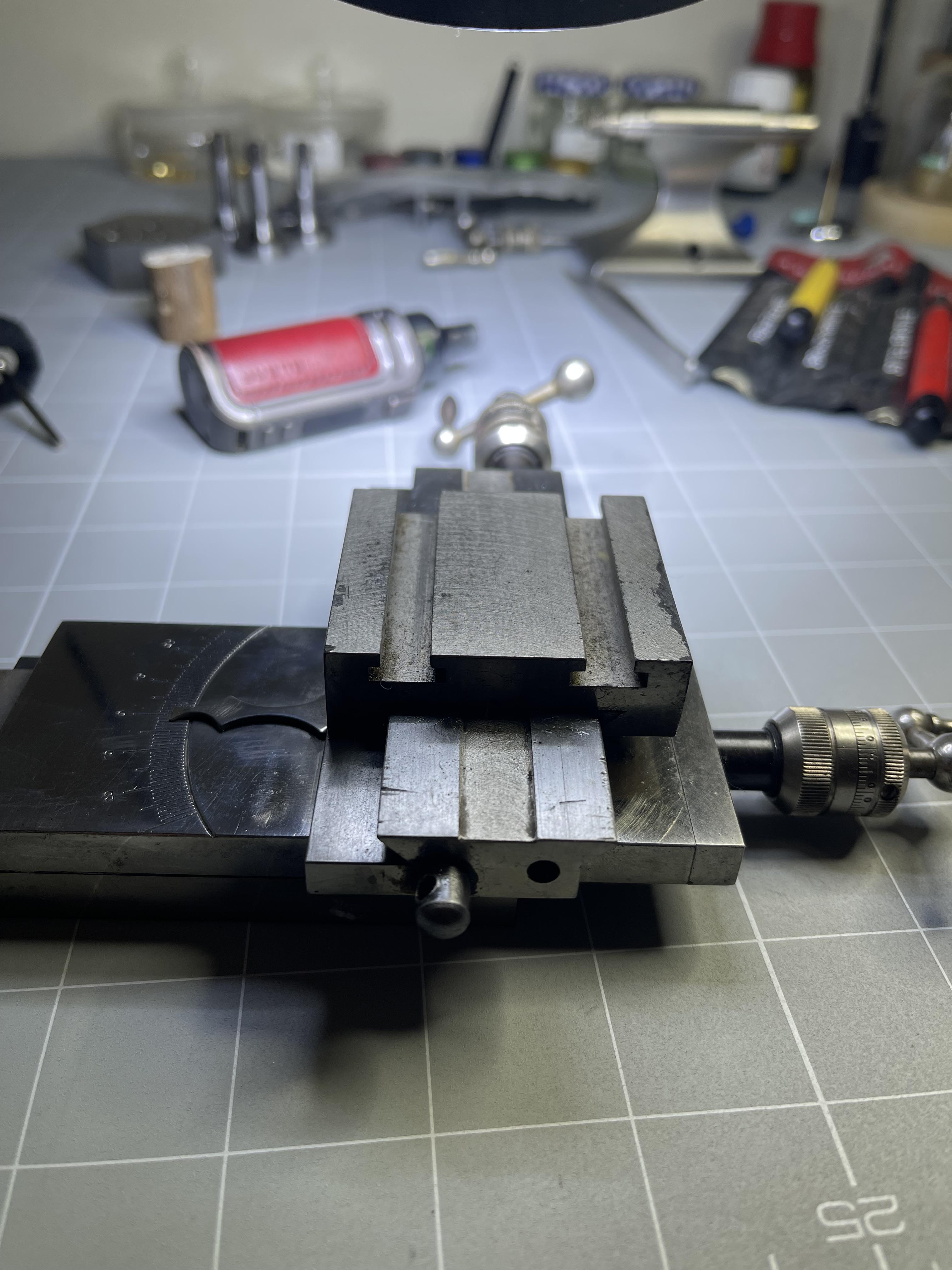

I’ve acquired a 8mm Boley Leiden WW Lathe . I’ve been slowly working through cleaning it up and it seems to be in a decent state overall. The bed is true and free of dinks etc and, working with a T rest, I’ve made some good progress with it.  The questions I have are with regard to the tailstock and cross slide.  As you can see the tailstock has a runner with a micrometer and would be ideal for drilling a pivot but, apart from the male and female centres that came with it, I can’t find anything to fit. The taper is 5.6mm at the widest point (.22”). I’ve seen some tapered chucks and 8mm collet adapters, which would have been prefect and claimed to be Boley WW but they seem to be all at around 3.5mm (this is not exact but I didn’t register the actual size as they are clearly too small).  I’ve seen alternative tailstock (which are very expensive) with sliding runners but, again, no chuck or collet adapter and I could just end up in the same boat. Boley seem to still be making parts but they only seem to sell to commercial customers and seem completely disinterested in replying to emails regarding resellers. The cross (as you could see if the photo uploaded. I’ll try and remedy this) has no tool post and I am having trouble finding something to fit. The T slot is about 10mm+ wide. I can supply other dimensions if this would help. One additional thing about the tailstock is, as expected, if I remove the runner and locking grommets, I can insert a 8mm collet runner
So, in summary, I have a lathe that works nicely but I am stuck with the sourcing of accessories. Any help you could give me would be most welcome

You have a WW style Leinen, which is a good thing! This is the larger width Webster Whitcomb type bed, they also made a model called Reform with the same shape but narrower. It's been my experience that tailstocks for these are completely standardized and one will fit any lathe and line up correctly with the head. This isn't necessarily the case for other makers. A collet holding tailstock is worth looking for, even at the prices they command. The one thing to check is that the locking lever is straight and black, like yours. Earlier Leinens had a slightly different bed dimension, a little larger in width I think?, but those tailstocks won't work. They can be identified by their locking lever, which is bulbous in the middle, and chromed.
The tapers in watchmaker lathe tailstocks are a bit all over the place; I haven't found a reliable source of the actual specs for different makers.
Do you have the shoe for the slide? This is what fits it to the bed; it slides into the recess in the bottom of the slide.
For tool posts, a quick-change is the most useful. Tripan makes an excellent one, at a Swiss price. There is a new maker of high quality watchmaker lathes in China, but they don't have a website- you have to contact them over Instagram. Their handle is watchmakerlathe there. A friend has one of their machines and it's very nice, and their tool post is also very nice and I think less than half the price of Tripan.

Yes! Couldn't think of his name. From what I understand he sells the tool posts to anyone, but not sure if he provides a nut for the slot in the slide. His slides have tapped holes that the post screws directly into. I imagine it would be hard to make a universal nut given all the different slides out there.
Thanks @nickelsilver ,thankfully a square nut shouldn’t be too difficult to make.

Yes, I've noticed this. The taper on the end of my tailstock is really weird, with a max  diameter of about 5.4mm min of about 5.2mm. I have a couple of centres, convex and concave, whose tapers are from 5.6mm to 5.2mm. I cannot find anything matching that taper anywhere. I have even been considering making my own sleeve adapter but, you know, you need to drill holes for that 🤦‍♂️
Yes, I have a shoe for the tailstock and the clamping arm Is the thin, black one
Thanks for the reply. I have made some comments inline with your post.
I have been looking at these quick change posts but the concern is the shoe. The T slot in the cross-slide is only 10mm+ wide where the shoe slides in. I bought a lantern on the off-chance, which has a shoe that is too wide by a millimetre or so (it's also a bit crappy(It is a Chinese knock off) so I am worried about that and not many sellers show the shoe size. I guess I could turn one (need to add a decent tap and die set to my shopping list)
I contacted an eBay seller selling the quick change posts for about £100 as advertised for watchmakers lathes and the 'T' foot is 12 mm and it was too thick as well so like you couldn't fit my cross-slide, unless you start hacking it down, which I really didn't want to do.
