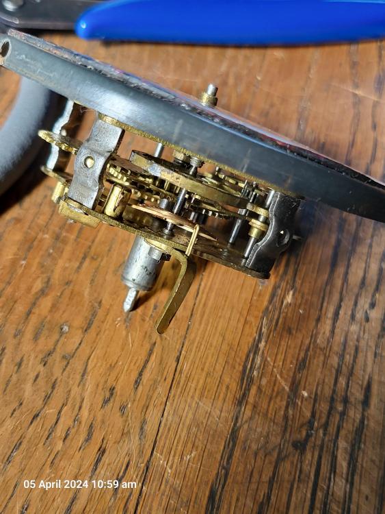

Dismantling a 'family' clock. Managed to remove the stuck-on ceramic dial without cracking it & found what looks like an inventive previous repair. Grateful for views on what might have happened back then & what the original part was.

It's in bits now: hope the attached pics help. The back plate bears the words "....British United Clock Co Birmingham  England". Thanks for your interest.

Nothing seems modified or not original. What are You concerns?

In the top (original) photo there is a coil of wire between the plate and the lower wheel which I thought might not be original....
It is all original and you do not have missing parts.

I suspect that may be a friction drive between the movement and the hands / motion works, to allow for time setting?
Something broadly equivalent to the cannon pinion friction drive in many watches.

The coil of wire is a spring that is there to press and create friction for the 'clutch' that slips when the time is set.
Thanks for your advice, guys, which, as a newbie, I respect. However, please excuse my offering the following observations: while the spring is completely compressed, as the original photo indicates,  it shows no sign of expanding when pressure is applied to reduce the compression; there is no evidence of any torsional force; it is not uniformly cylindrical & its ends do not have the form I'd expect those of a manufactured spring to possess. To my inexperienced eye it looks just like a coil of wire that's been created to achieve the desired spacing between 2 components.
Hi. It may look like a coil but it is compressed enough to provide the tension to enable you to move the hands.
the coil is compressed via the bush under the plate on the arbour. In better quality clocks a three leaf spring is used in the same way again compressed via a bush. Bear in mind these were mass produced and lacked many refinements and in large numbers. Most probably ended up scrapped as the repair costs was more than the clock.   If you take into consideration the quality, the plates are poor the wheels are rough which is commensurate with mass produced movement.
You won't see any obvious movement with it as it is - but if you apply a bit of force, you should find that the small pinion at the top end in the first photo can be turned relative to the large wheel, but with significant friction.
All conventional clock and watches must have some friction slip "clutch" mechanism. to allow the hands to be set without breaking the movement; without that clutch, the hands could not be set, other than by stopping and starting the whole movement.

Thanks for the education RJ. I did find, in line with your comment, that I could move the pinion & wheel independently & now understand why being able to do that is important to time-setting. However I remain convinced that on my clock the friction has simply been achieved by an ad hoc 'cylinder' of wire of the length necessary to achieve the desired effect: it is not a 'manufactured' part like the springs in your helpful picture.
