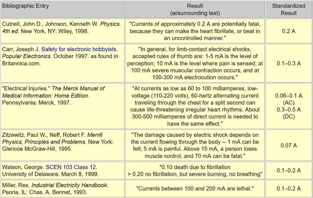

Not that know I much about electronics I understood it the same, its not the voltage that can kill you its the amount of current flow
Sad I'm hopelessly confused here. I tend to be much more afraid of voltage especially high voltage. I do not have fond memories of things with high voltages. Think about it this way I don't think I've ever had any pain from holding a watch battery but high voltages where things that you perceive could be an insulation don't exactly function that way.  What are basically managing to get your hand anywhere near something that's high-voltage is not a pleasant experience. Then yes the current is important but it really helps if you can get the current to flow with a little high-voltage
Ohms law again.  It is the current that kills, but your body is a resistor.  Here.
