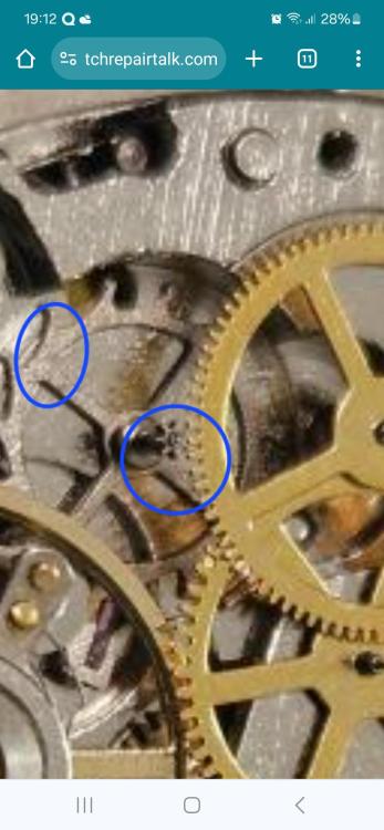

Here a photo with the bridge removed,
I found that little metal piece haging aroud, could be it was stopping the movement ? it is a broken part from another piece that is now preventing the movement do work correctly ?
let me know if I have to make other photos from different angles/ removing other parts
thanks
Looks like the escape wheel upper pivot is broken. At least it is what I see on the picture. One of the leafs of the esc. wheel pinion is not seen, but not sure if it is so or just light effect. Also, the reverse wheel upper pinion is under question, but not seen good enough on the picture.
See, assembling watch movement is with no force, and no screws tightening before absolutelly sure that all pivots are in the holes. Otherwice this happens...

This is what neven rafers to, show the pivot of escape arbour.
