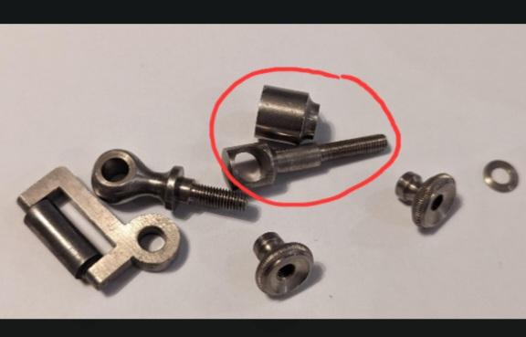

There were couple of mysterious bits floating around in the bottom of a watchmaker's lathe box whose function escaped me. One was obviously a file rest, but I couldn't see any way of mounting it to anything. The other was just some random seeming bits of shiny metal:
The other day I was looking for some images of filing rests (the conventional double-roller sort) and google found me a post on Reddit where someone was asking 'what are these tools'. Among them was this image:
The person who responded said "It's a filing rest". I rushed to put my bits together and what do you know:
My question is, how is this mounted to anything on the lathe? The bottom 'cup' bit acts as a screw clamp, I think, but to what? The screw isn't long enough for it to open very wide. There's a couple of purposeful-looking 'nicks' you can see in the photo. I can find no other photos like it on google and it's not in Britten or any of the lathe books I have. Any ideas how it's used?

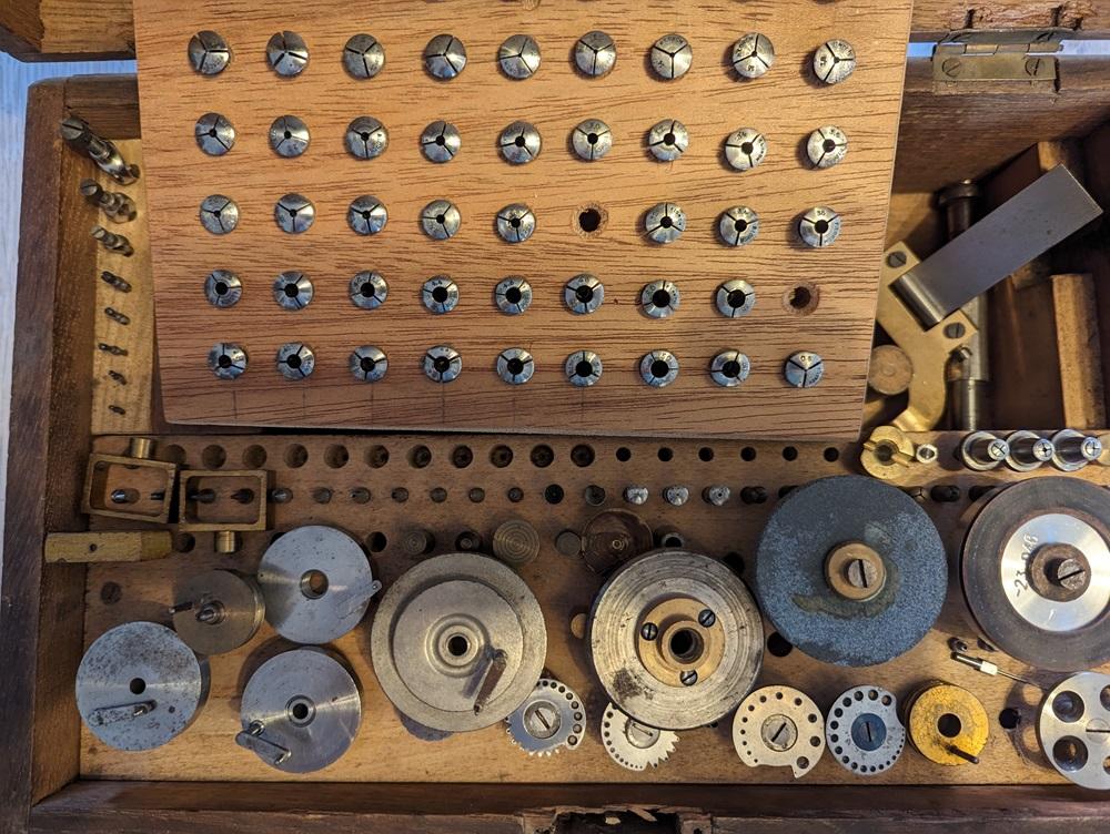

Ask me about the screw lantern in the top left of the second picture 😅

This is tool fully dismantled:
It's only a single roller. It seems strange that the other one out there in Internet-land had exactly the same parts?

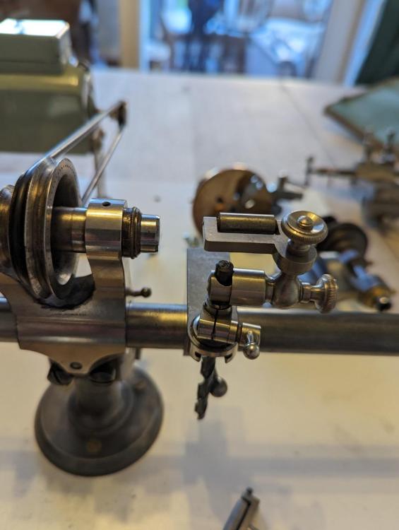

I tried the idea of using the tool rest, but it's too tall:
Anything on the cross-slide would definitely be too tall:

Try flipping the roller part over, and swivel the whole thing forward 90 degrees, so the roller is "facing up", would it fit then? I much prefer single rollers to double, at any rate you have another single there that works!

It looks like it needs to be on the other side of the post and the roller should be pointing  upwards on its frame. If its still too high maybe it was meant for a bigger clearance headstock ?
I think Nickelsilver and Neverenoughwatches are saying roughly the same thing and I see the logic. The only thing that gives me pause is that mechanically, having the roller pivoted at the end would be an odd choice. Any excess pressure when you were filing and the damned thing would slip.

Try loosening the horizontal clamp and rotating the vertical clamp forward until the top of the roller is on the centreline of the lathe. If you can’t get it there, I would suggest that this rest is for a lathe with a higher centreline.
Hi Michael - see my picture in the post above yours - it turns out to be a graver sharpening jig, not a roller file rest after all! And it does a very fine job of that.
