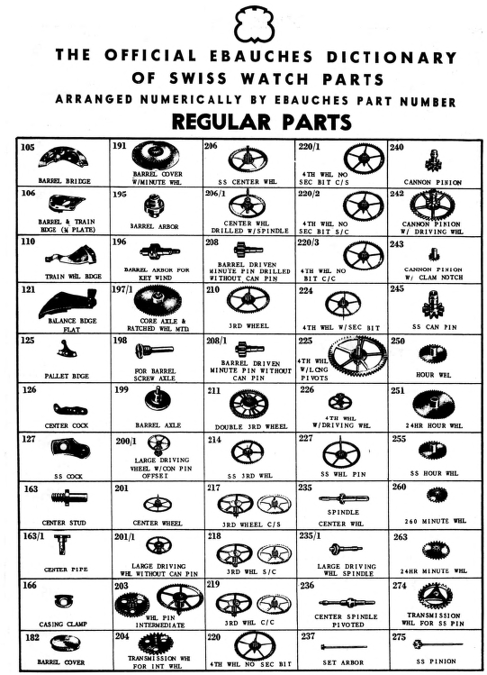

you might want to find yourself a copy of the bestfit book is out there somewhere is a PDF.
For instance in one of the pages we find this. It makes reference to a Swiss dictionary that lists out all the parts with Swiss terms you're probably not going to find this dictionary if I remember right it was expensive. Now the other purpose of this is the problem of how much room on a package of a spare parts you have the right things? You cannot write all the different languages with descriptions on tiny packages so with the Swiss did was adopt a numbering scheme. So when you're looking for a part you need the number of the parts and the model number of the watch this oftentimes comes up where someone sees the part number for another watch and thinks it's going to work and know what will not

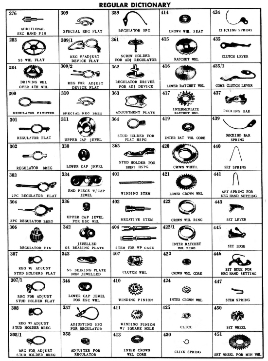

Now let's see we should get the next page that covers your part and will get an official name and make you officially unhappy. So you need a yoke spring 440 and according to the official terminology the Swiss the same people are responsible for your parts list they Call part number 440 a set spring not a yoke spring oh dear. Where's a reality both names will work the most important thing is ideal it be nice to you have a part number or the absence of a part number you see a picture of the part you trying to purchase making sure it fits the caliber of your watch.
