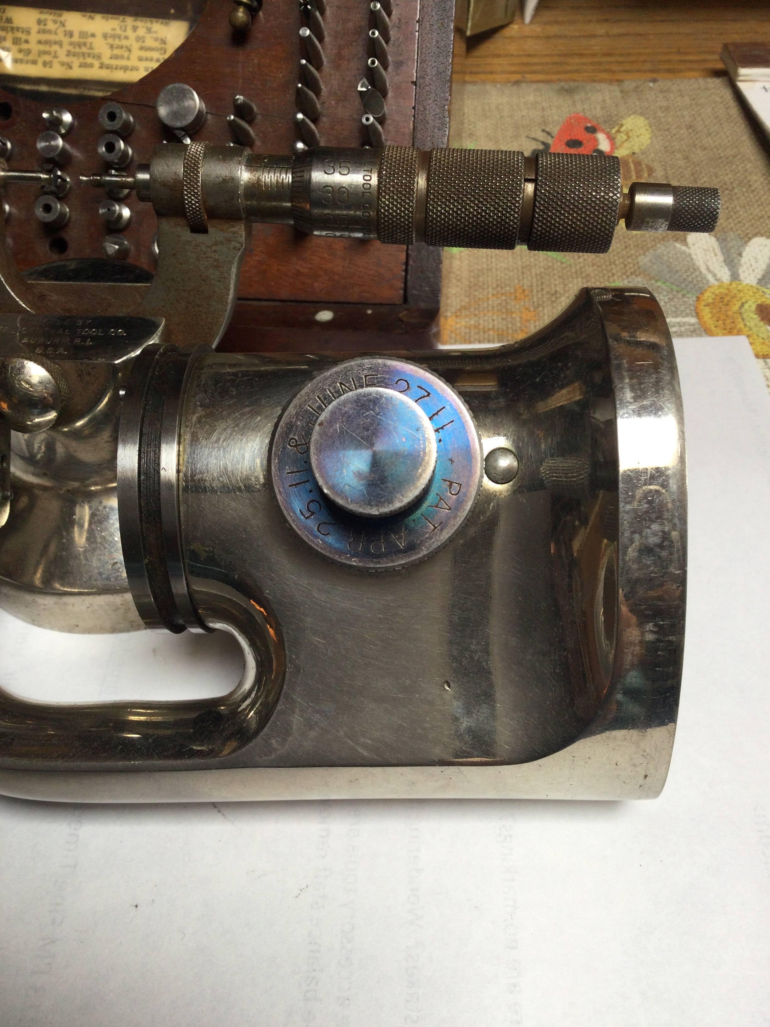

I have been looking for a staking set and found this one from a retiring watchmaker.  He says the only markings on the staking tool itself is Pat. 1911.  The case latch says Eagle Lock, Terryville, CT.
Looks a bit unusual, with the two staking positions.  Not sure of the advantage of that.
He indicates that one of the knobs will rotate the table and the other will lock it down.
I hadn't seen one like it in my browsing around online.
He indicates that it is the best staking set that he has used.  He's asking $425 for all of this.  That's rather more than I was wanting to spend, but I thought that I'd get some feedback on this to see if it is something that I should grab or to just keep looking.

Thats a nice set , with a few extra bits and bobs. Looks to me like a Marshall.  The extra height allows you to use the stakes from underneath.

The way he descried the knobs was that one turns the die plate to the desired hole and the other locks it in place.

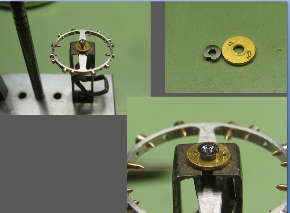

Let's start with the miscellaneous stuff this is your standard modern type war remover usually doesn't work for pocket watches

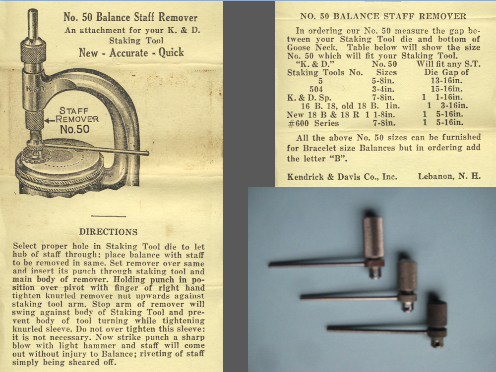

Here's the balance staff knock out tool we do not get a picture of the punch though I'll go back and look carefully at the staking set see if I see it looking it might be in the Ziploc with the instructions which are the yellow thing
As you can see especially remember this if you're purchasing them they come in different heights and you can unscrew the top part like it shows the image of using it to put pressure on the balance staff that silly and docket out depending upon things and how you feel about this you may not hopefully damaged the balance on. I had to put the disclaimer and there can somebody will come along and tell me what a horrible tool it is it does work but you have to be careful like everything in watch repair but if you are purchasing one you want to be careful you get the right size because we get the really short while you're sticking cents big enough it might not do its thing of
Oh and then I believe there's different diameters  there's a reference to B. In other words the hole diameter that goes over the balance pivots one is slightly bigger than the other and the punch that goes through the center has to be sized right.

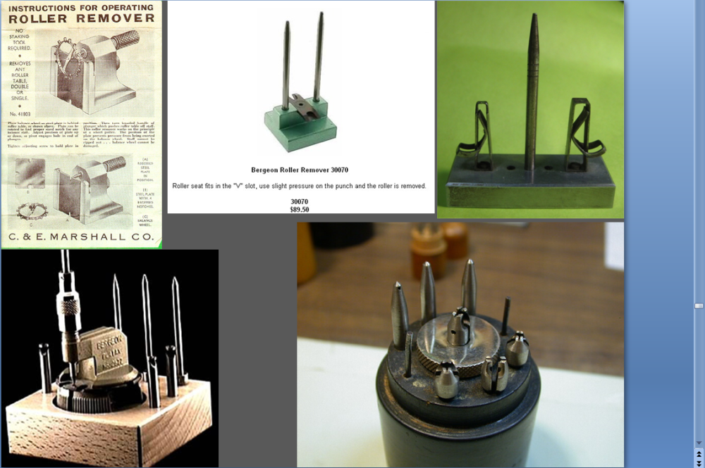

Then because I'm sniffing images out of a lecture I think I'll just expand things a little bit give you some bonus things like here is what are your roller movers but there's a image of a whole bunch of other stuff also

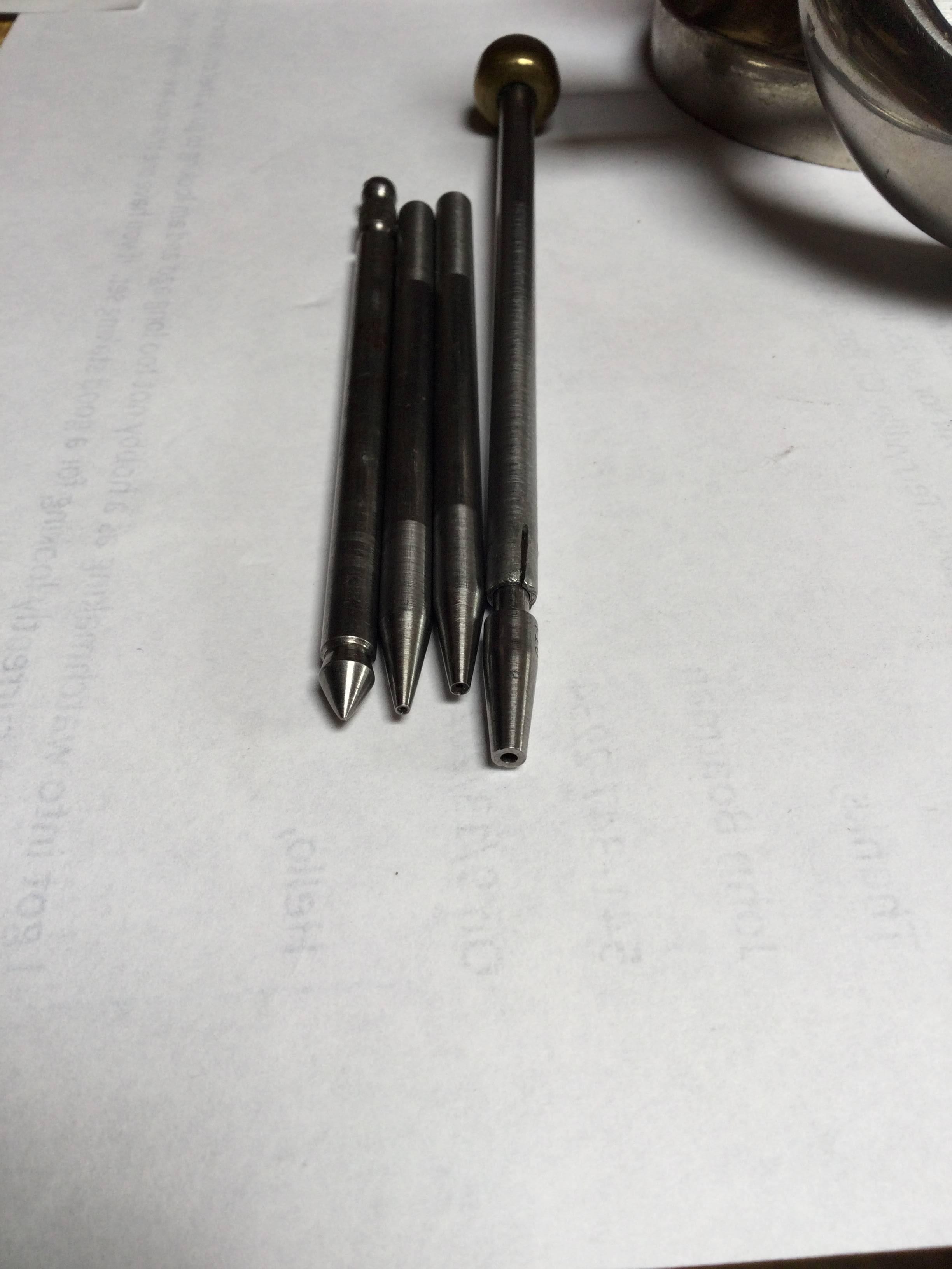

No notice for yours it only shows one punch there are three of them the diameter is small it will not be mistaken for a regular staking set punch. But I've was a box of miscellaneous stuff somebody probably would have zero idea what it is for there's also that problem. Plus there's the other problem at least with mine all of the ends are broken so usually I have to use a staking set punch anyway
Here's an example of the truly use this is a Hamilton 992B. It say to peace roller table the roller table and safety are separate which can present a challenge for removing because first you have to remove the lower one and you can't actually remove it because the safety roller is preventing that that's where this tool becomes really handy for doing this is enough depth to get everything off
Okay I will make a guess this may be for Re-pivoting. If so it's missing a lot of bits and pieces otherwise it might have some other purpose we really need to see it up close and looked up the bits and pieces that you do have.

Thanks for the pics.  I wouldn't have guessed that the grey tool with the metal clips was a roller table remover.  I had seen that other style.

It doesn't clarify too much, other than the stakes are really short.  There's got to be some type of holder for the stakes.  Maybe it's that brass topped rod (which is not in that eBay listing).
Okay that also explains my thought that the punches themselves seem like that too small in diameter. I decided it was an optical illusion but maybe it's not maybe they do well obviously they do because are too short. It's still those interesting staking set I have a sizable book on watch tools and what I get a chance much later today a look and see if we can find this is definitely unique enough that it should show up somewhere on the planet perhaps. There is the other unfortunate problem of watch repair having lots and lots and lots of tools and a lot of room have basically just slid under the radar because they just didn't make a big quantity of them.

Got a reply back from the seller.  There is a holder for those small stakes.  That's an interesting setup.  It would be hard to find any replacement stakes, it would seem, if needed.  Though, they are 4.7mm in diameter, so K&D stakes would be compatible.  He does have a couple of regular stakes with the set, marked 7E and 9F.
The frame has a couple of patent dates on one of the knobs.  A patent search on those dates didn't turn up anything.  Maybe not US patents.
