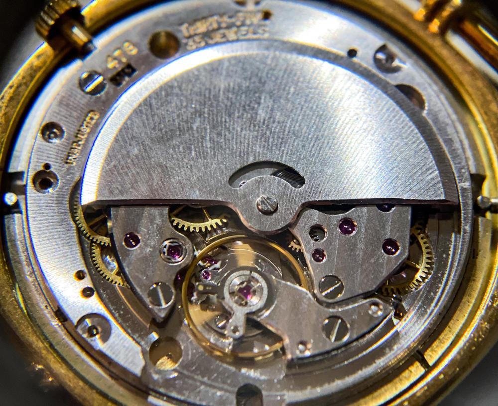

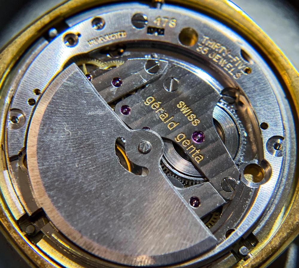

Genta Caliber 478
How does the stem you've got fit the movement and how does it operate? i.e. Do you pull the crown to set the hands and wind in the normal in position?

Finished! Well, not quite, but I've done all I can. I used the original hand for the minute counter. The running seconds hand is a central seconds hand with an extended tube - I just snapped off the long bit. It works I think. As I couldn't source an hour reset hammer I left the hour counter hand off. I hope the owner will be happy. It's all working and keeps good time. I did recommend he got a professional to do a proper job, and he could still do that in future if he wanted to sell.
