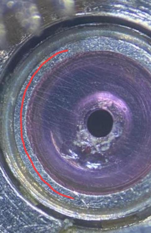

The pictures show a jewel setting (with damaged jewel) from one of my American pocket watches.
I’m looking to replace the jewel, but I’m a bit unsure of what kind of setting this is.  Is it a normal friction setting, like the ones found in modern Swiss watches?
Any input would be much appreciated.

I'm no expert on pocket watches but look at this wavy edge how it seems to fold over the jewel. Is what is known as a rubbed in jewel, as with replacing all jewels they need special tools. Rubbing in a jewel is a more specialised task requiring hand tools. JohnR725 can give you much more detail with this

Thanks. The jewel is flat on that side though. Not typical for rub-in?

How do you mean flat on that side ? How does that affect the mounting of the jewel ? If the jewel is rubbed in you will be able to distinguish it from a friction jewel relatively easy. Look at the edge again, does it look to fold over ?

Looking at it from different angles, the edge does not look to be folded over, except maybe on a couple of small spots.

I decided to push it out with my Swiss jewelling tool. Indeed it was ”rubbed in”. 👍 It wasn’t really obvious to my untrained eye before I pushed it out.

Hmm ok you've replaced friction jewels and you have a good understanding of how a friction jewel looks and fits into plate, bridge etc. they are pretty much the same throughout ? So by deduction does this in any way suggest that it could be a friction jewel 🤔 or could it be something different ? You know the answer to that I'm sure. So your attention is now turned to something different, some kind of rubbed in jewel maybe ? to which there are more than likely quite a few designs, many of which you will not have seen. Namely this type ? The watch is how old ?  Could the jewel be in the wrong way perhaps or not the original.  It does actually look like it has never been changed. My point being just because its not typical and you haven't seen that type , doesn't mean it shouldn't be what it actually is. I take nothing for granted any more and i bet there are guys on here with 30 + years of experience that dont either. That is a massive part of watch repair, embrace it my friend  🙂  .

The rim seem to be intact, so I am hoping I can close it with one of the special tool, if I get one.

the parts list tells us the same thing.  In other words the setting should entirely push out with the jewel.
so basically you're not going to get a replacement jewel you're either going to have to manufacture something or work with what you have.
