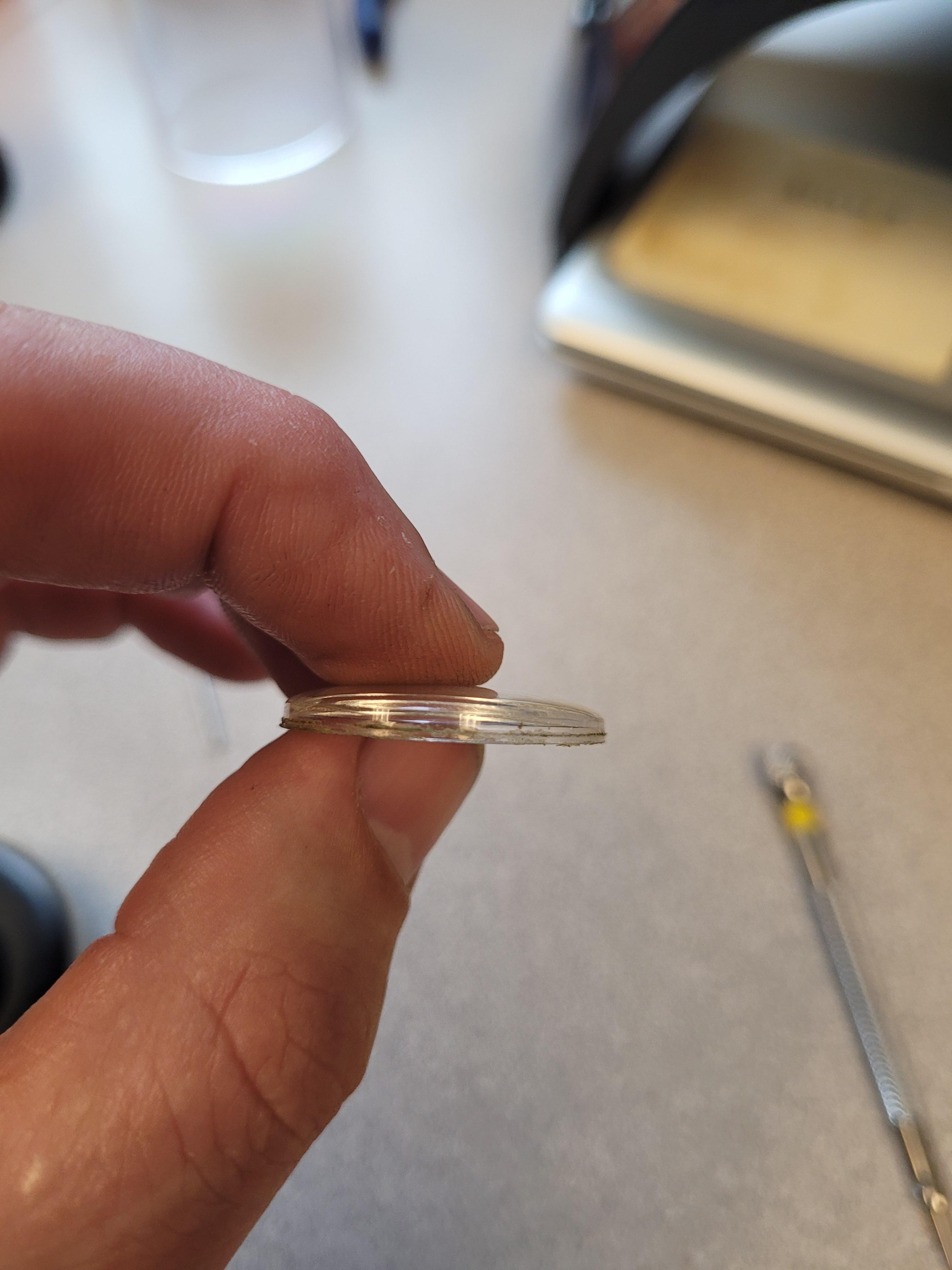

I did manage to get the movement out. The movement ring was very stuck. Now I am left with another dilemma, the crystal is very cracked. It is a 26.5mm round. Where is the best place to find a replacement and should I go a little bit bigger? Forgive the dirty fingernails, I am at work.
