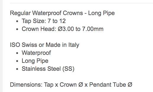

Hello, I have this crown which belong to a citizen and the small tube in which the stem is screwed in is broken so I bought theses small things on aliexpress but there's not enough thread to screw them in.
Can you think about anyway this can be fixed?

Your existing crown looks to have a stem extender already fitted to it, which is broken. So if you can unscrew this part from the existing crown, you may be able to use the crown. It's probably superglued on, so use heat to destroy the bond. You would then need a stem extender or a completely new stem cut to length.
The new stem you found at Cousins looks OK, as long as the number 8 thread fits. You are still likely to need a stem extender or a new stem though, because of the missing length.
