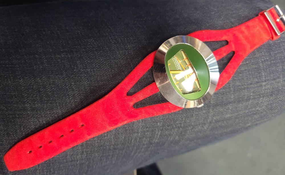

Just got this guy in the mail today. Initial timegrapher reading looks encouraging:
Got the bezels and strap off, got the split stem out, but now I can't get the movement out of the case. It looks as if the bezel around the crystal is melted into the case. You can see in these two pictures that one side is just normal, and the other side has plastic rolled and bulged out.

I have tried prying between the case and that ring with my case knife, but it will not budge. The case material also seems like *very* soft plastic, which is surprising to me given it's supposed to be fiberglass.
I also tried popping the crystal out with my air blower, but no matter how hard I squeeze nothing happens.
Any other suggestions?

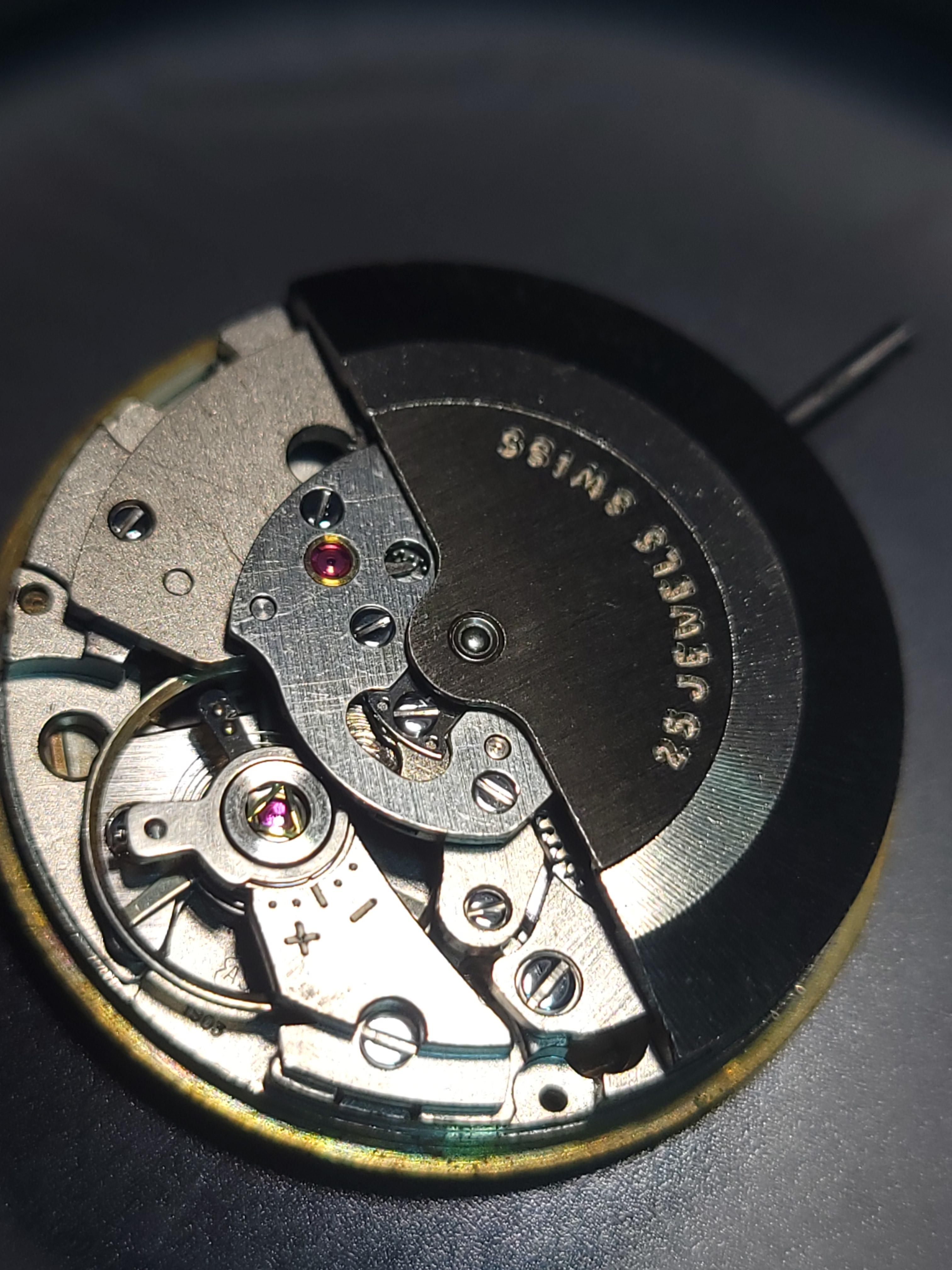

And now I need some help. I got it all back together, when I noticed it was difficult to set the time.
I traced it back to the second wheel, which apparently acts as the cannon pinion on these AS1902/1903 movements. It's tight enough that I can see a lot of wear on the sliding pinion in the keyless works, and I am unable to hold the wheel and turn the pinion gear with tweezers.
I assume there should be much less friction than that.
Can they be taken apart and cleaned/lubricated? I seem to remember seeing something somewhere about it, but can't find it again.
Looks similar to the AS1916 that I serviced. They can be taken apart and lubricated. It's probably not recommended, but I used the Aliexpress Platax Lite® to separate by positioning so the two pinions are separated by the groove and then pushed down on the pivot with the handle of a brass tweezer. I've used a Presto hand remover tool in the past with success, but I've also twice accidentally pulled the entire thing out of the wheel so I don't use that any more. Might want to use a smoothing broach on the friction pinion if it feels overly tight, or maybe just put it on and take it off a few times to help loosen it.
 Put oil on the arbour, try setting time, oil  may loosen it a bit,  then the more the  canon pinion turns the looser it gets.
Canon pinion should be greased   you might want to clean and grease it once loosened.
Good luck
Good watch are these spaceman indeed,   pitty no spacewoman came along.
Edited by Nucejoe
This was exactly my concern! After thinking on it for a bit, I finally remembered that I bought a roller table remover stump from Dave's Watch Parts a while back! It worked a total treat.
There was some wear on the shaft part, so I assume the parts had galled together. I cleaned it up with a polishing stick, added some grease, and reassembled. It's now setting smoothly!
