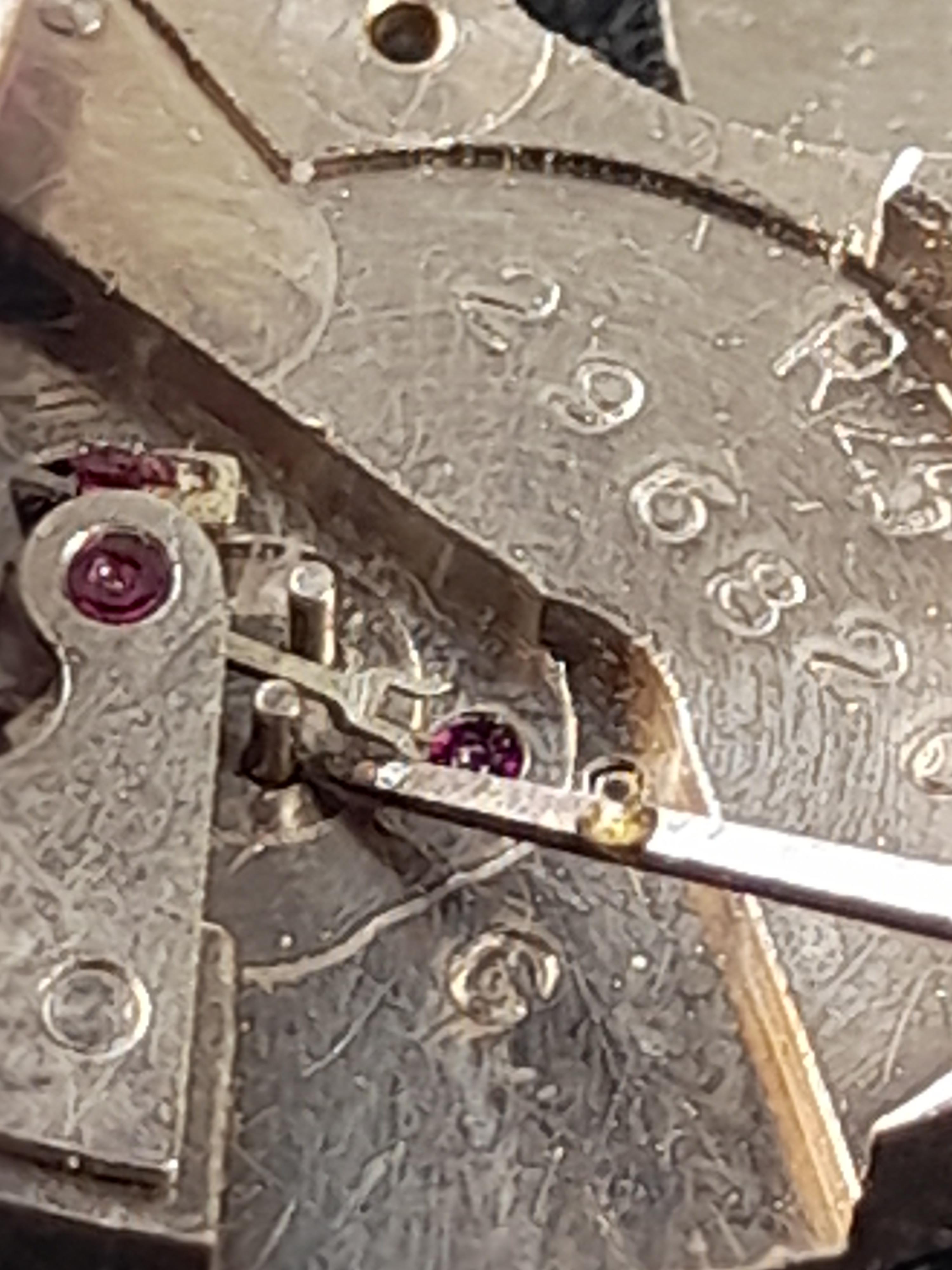

A just send a picture the pallet stone a believe the exit stone catching the escape wheel teeth and not release it should I adjust the exit stone out more if someone can help please

 The lock on exit stone is too heavy to unlock, so move exit  pallet back deeper into the fork slot so it can unlock. This will affect run to the banks thus  may overbank, may also thorw the entery pallet out of adjustment.
Pallet adjustment is a pain, lets first get the fork to do its thing so the watch runs, next level is when you seek to improve amplitude without  rebanknig. Lets just call that advance level which I run away from  everytime I face the challange.

Can you remove the pallet fork, clean it nicely and post high magnification photos of both pallet stones. I think the entry stone might be damaged.

Not only does it look damaged it looks like its facing the wrong way as well.

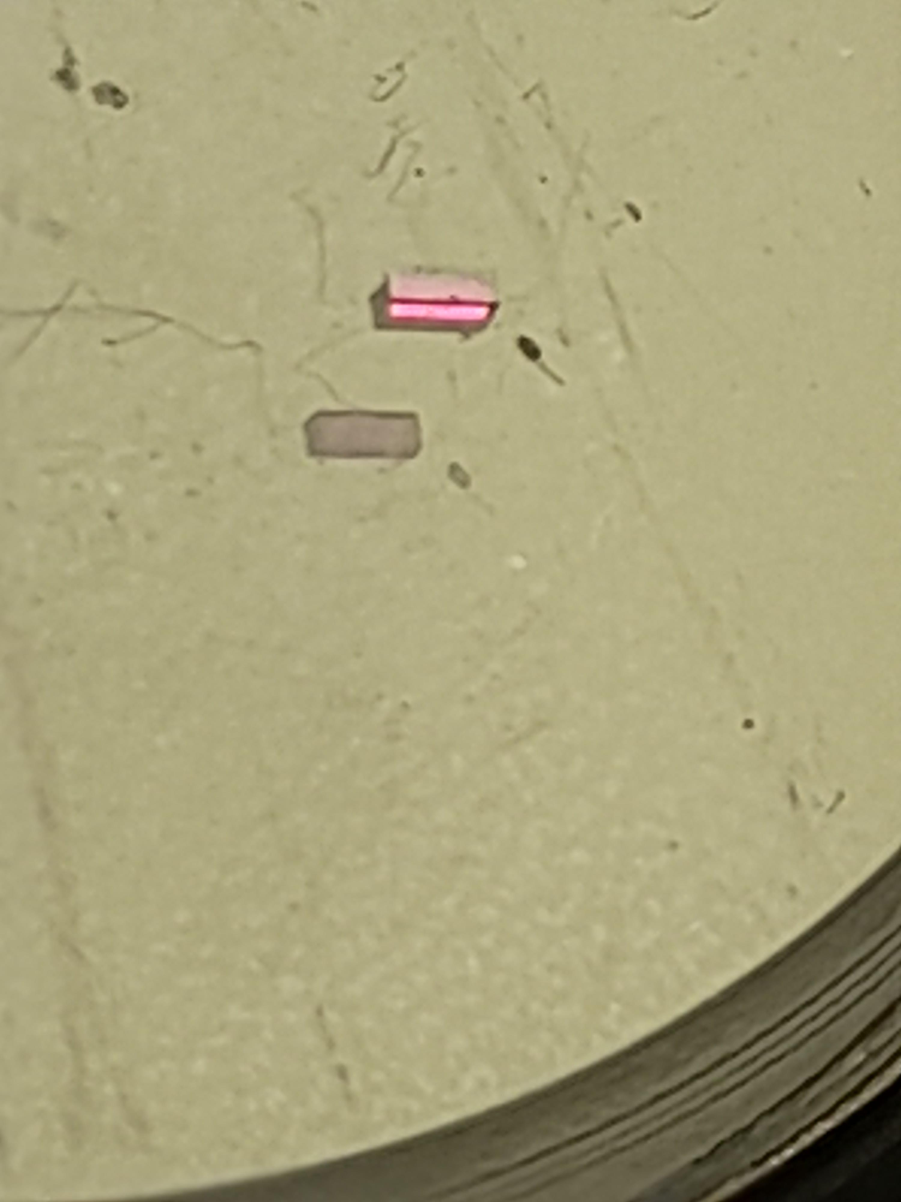

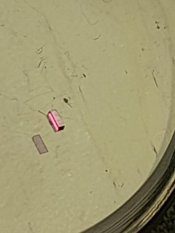

Thanks alot for the reply  a taken picture of the pallet jewel the entry stone can't take pictures  yet of the exit stone till a clean it first and someone  said the entry stone was put in wrong what way is it meant to go  and is the picture clean enough?

 Doesn't that entery stone look it doesn't belong?  as if two stones from two different calibers?

Your interpretation of the quoted instruction above was to remove the individual stone and clean it which is not what the instruction was. Instruction was to clean the fork with the stones in place so we can evaluate the situation. Now that the stone is out everything is changed.

Really hard to tell when it's out of the Fork but seeing as how fast it came out does make you wonder if other pallet stones are involved in this?

Oh and as a reminder both stones are physically different. See do have to put the right one in the right place and they both have the face in the proper direction and of course they have to be the right depth. Then The shellac is also supposed to be on the bottom not on the top of the fork.
