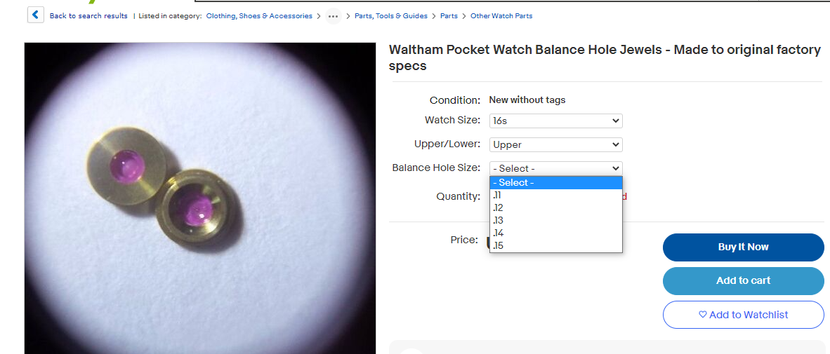

John, you are such a treasure trove of information and resources, thank you very much.  I'm looking for the upper balance pivot hole jewel.  I'm not sure how to go about getting one.  there's a seller on ebay, but it requires knowing the hole diameter, which i don't have a tool for but maybe i can get close by inserting a small rod in the hole then measuring the rod.  Cas-Ker has some but it's a one size fits all waltham 16-18s, so i'm suspicious as to whether it will fit mine.  i'll email them and see what additional info they have on that one.  It's a cool old watch so hopefully i can get her running better.  Arron.  PS. I did put a note in the PW database about the error in case someone else runs into it.
basically the pivot of your staff determines the size the jewel. But then there are the problems of part numbers.
just because it might be easier to read than the PDF snipped out some images. You can see the serial number range of your watches where it's supposed to be even if the serial number book indicates the wrong watch. Then hold jewels you get a couple of choices for the upper and lower depending upon how it goes in. Then I have another reference book that lists just the jewels you can see lots of variations but you get some approximate sizing of how big the setting should be.
So usually if you're replacing a hole jewel it's because you ever broken balance staff and whatever staff size pivot you have will determine the jewel size the jewel is usually a little bigger than the pivots size so the course to fit together promptly.

Thanks John.  A few questions based on that information, if i could.
1. am i reading the chart correctly, that if i have the model 1908 then the new factory number for mine is the 4946F and that then reduces the possible jewel candidates to either the .12 or .13 hole diameter?
2. am i correct that the "cock hole jewel" is the upper balance cock pivot jewel and the "foot hole jewel" is the lower balance pivot jewel that sits in the dial plate?  I've never heard those terms before so want to make sure i'm understanding.
3.  does the "F." and "C." in the description column refer to the foot hole jewel and the cock hole jewel respectively?
4. regarding the reference page with the jewel sizes, is that found in the PW database; if so what the is the title so i can look for it.
5.  if the top and bottom holes jewels are the same size (according to the reference chart if i'm reading it correctly), then is it a viable option to find a wire that fits the lower jewel and then measure that with a micrometer to get the exact size--i understand that i wouldn't want to use my good balance pivot for measuring for risk of damaging the pivot.
1 hour ago, arron said:
4946F
even though from the charts this may appear to be correct  you should disassemble and remove the jewel assembly to verify what exactly you have. Then if your pivot is still good what  is wrong with the jewel?
they actually make or the past have made gauges for this in a box is a whole bunch of plugs with a really tiny little end piece that you can use to figure out what size hole you have. On the other hand you can see if you can find some cheap balance staffs on eBay where you know the pivots size you could make your own. Or in this case just err on the biggest size and not worry about it. If you are replacing the balance staff then you might change your jewels to match whatever staff you're getting because despite the reference material listing all of these sizes the reality is you won't really get all the sizes today
