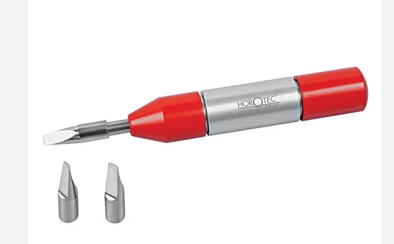

I've never seen one of those. You got a link to it? It seem to work well for you?

I saw somebody else on my other place i hang out with watchmakers say that they often use a case knife in a similar shape as mine and lightly tap it with a hammer and just alternate sides with it.
Similar principle to the tool that kalle uses. Like an auto punch, you push the blade against the case back or bezel as it reaches its tension point it releases and fires the blade forward. I wouldnt trust myself with it. I prefer the slowly slowly catch your monkey approach.  I also have the same devise that mike uses, in fact it was mike that inspired me to try it. I dont often use it, not that it doesn't work , i just rarely need anything besides a knife.
Cousins sell them for £12.95 (or you can buy the Swiss version for £69, which looks identical 🤣,  but it's one of those tools you don't need the expensive version for it to work OK).  Or you can find them on ebay.
Sweet, if that's workin for ya i'll order one on my next cousins order. Thanks bud!

I"m a little unclear, fires the blade forward? It looks like you just screw down to slowly put pressure on the blade till it pops up the bezel.

I think you are conflating 2 tools, the one that fires is a bit like those spring loaded centre punches (see below), these 'shock' the case back or bezel into opening, but I only use this as a last resort as the risk of it jumping and scratching the watch or burying itself into the flesh of your hand are significant, and I've only ever used on on a case back not a bezel.

Sorry confused you there colin, i was referring to the guy you mentioned that uses a hammer to tap the caseknife in, kalle used an auto release tool that fires the blade out. Mike's  tool and mine does wind a blade into the case edges.
Thats the one 👍
