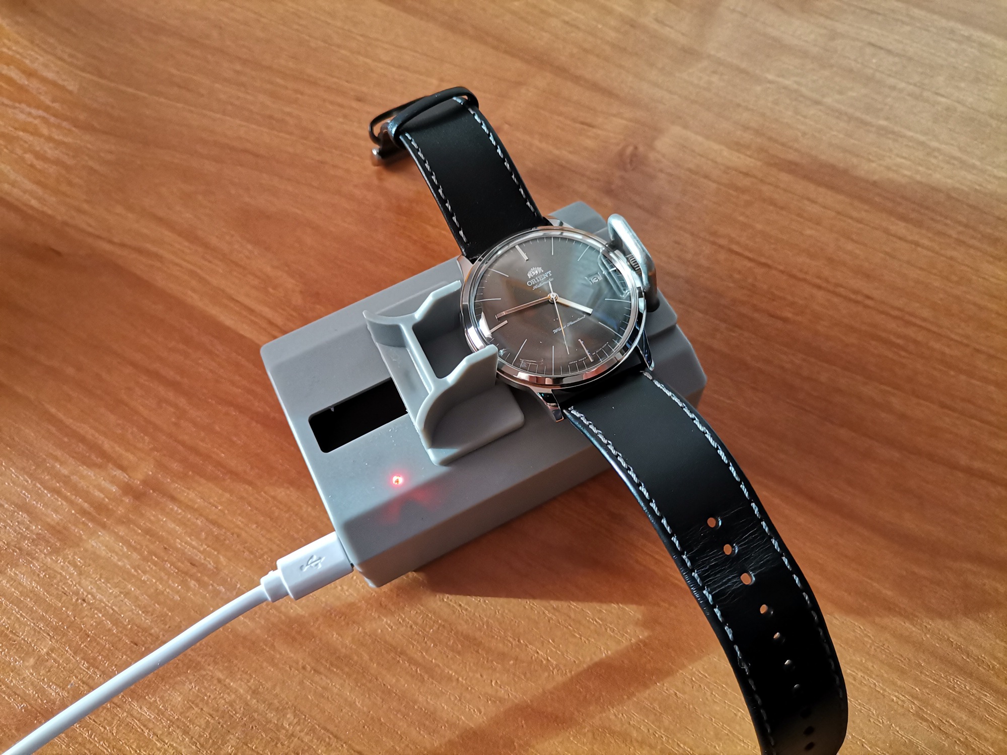

I acquired TGBC timegrapher from AliExpress due to lots of positive reviews. It can be used with Tg 0.5.0 app which is available for Linux. I have had mixed results so far. I don't think that the sound quality is good enough for fault finding, but it is good enough for rate adjustment and checking amplitude. The Tg ap had a hard time showing amplitude and waveforms are usually unusable. I will upload a sound recording from TGBC timegrapher so you can check it yourself.
The sound recording:

Thanks for the information, I had a look on Ali, but there are tons if them, could you send the link for yours as it seems to be working for you 🙂

Those inexpensive microphone boxes on alix work fine.  I have the one with the stand that rotates, which is quite nice for testing positions.  It has analog out.  I like the additional control my computer's audio hardware gives me over the built in USB audio on some other models.

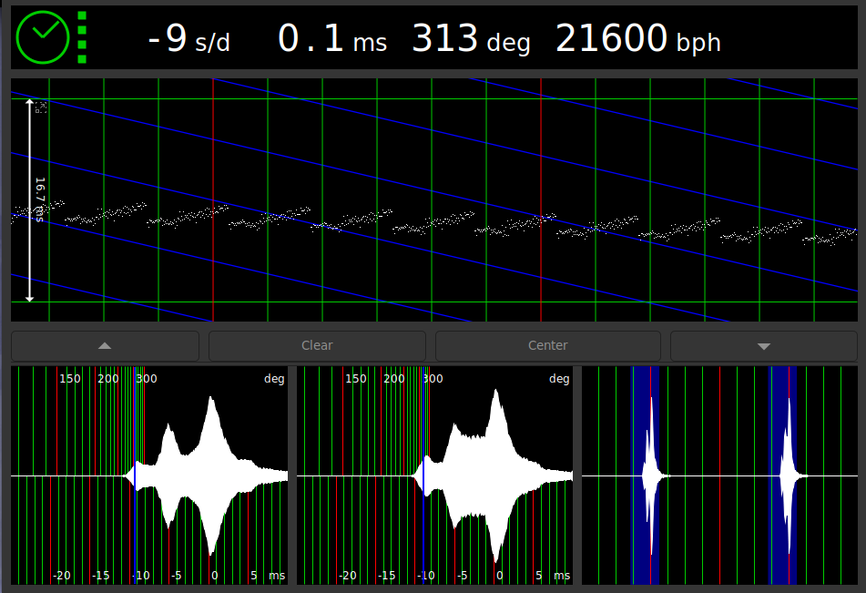

I think it works well.  Can you describe what is wrong?
There is an issue with how the beat is timed, based on the lock rather than the unlock.  This results in variations in the escape teeth showing up as a cyclic pattern even though they do not effect timing.  One thing I'd like to do it allow switching to unlock for timing, but unlock needs better quality audio and it seems many struggle already.
The averaging interval is a complex subject.  TG uses a different algorithm than other software and detects the rate error by looking at the peak auto-correlation of the signal.  The window over which this is calculated is 32 seconds.   But this is not the same thing as averaging interval.  But it does mean a similar thing if one wants to know if the errors relating to a given wheel will be averaged out or not, based on whether a completely revolution of the wheel is included in the averaging interval.

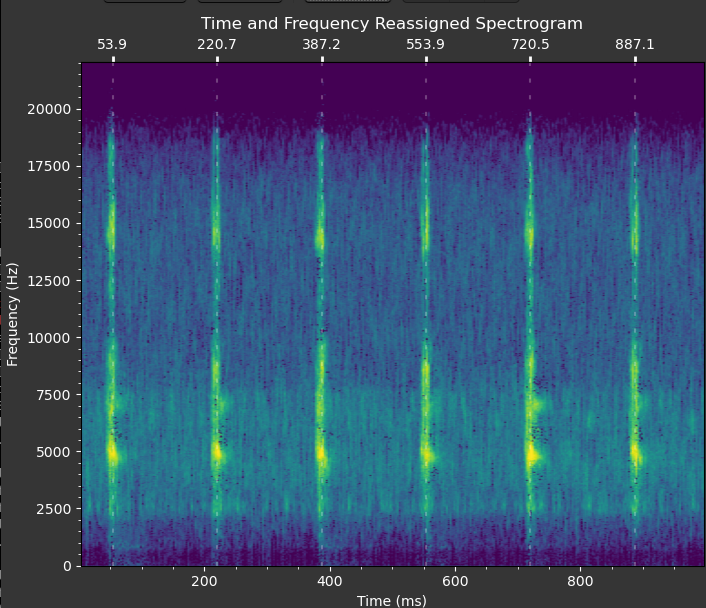

On 3/13/2023 at 9:07 AM, Fralex said:
You were quite right to suspect an electronic noise source!  Using my version of tg, we can quickly see the issues in the signal monitor window.
The signal level of -16.9 dBFS is in the green, neither too quiet nor clipping.  But look at that noise about about 7000 Hz!  There is your problem.
This can be address via the audio filters.  I adjust the default high-pass filter to 3000 Hz.  Looks like mostly noise under that.  Then I create a very narrow notch filter at 7000 Hz.
Noise, be gone!  The line at 7 kHz is now gone.

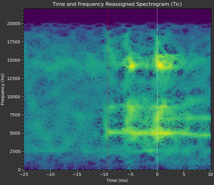

Lets look at the waveforms.  They are a bit muddled.
The tic spectrogram shows this better:
See how the sound at 5 kHz, while clearly part of the beat, seems to start at the unlock and then just keep going.  And it's loud.  It's covering up the more distinct unlock, impulse, lock sounds we get around 14000 Hz.  So we'll add a peaking filter to amplify that section.
Now the 14 kHz sound looks strong vs the 5 kHz.
And the waveforms, we can see the unlock, impulse, and lock more distinctly now.  Amplitude measurement will be better, as it needs to identify the sounds within the beat.  The rate error uses an auto-correlation algorithm that considers the entire beat as a whole, so it doesn't matter as much for that.
The stair-steps every 15 seconds are of course the 15 second audio sample @Fralex posted being repeated.  This messes up the s/d calculation.  The yellow line is the amplitude graph, which also repeats every 15 seconds.

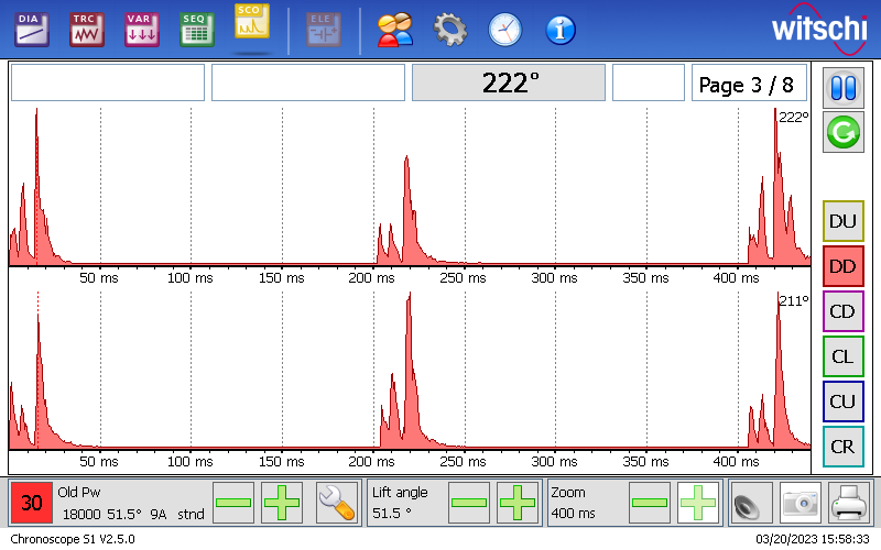

The Chinese 1000 timing machine is producing something that looks quite decent. Just a little slow hair out of beat and the graphical screen looks outstanding. But with the limited number of pixels is not good I have the resolution that the software will. This is where if you go to a witschi timing machine they usually have magnification and then you can make everything that looks wonderful at this setting look horrible. So I'm guessing the reason it looks as nice as it does is because of the low resolution.
The watch escapement analyzer software is indicating from the graphical display that one side of the escapement looks like it's having an issue.
The PC timing machine software graphically doesn't really show a beat and actually looks quite decent.
The watch o scope software looks like similar to the  fit in analyzer it looks like one slides having an issue
Then for the PC version of the TG software it doesn't have the wonderful optimistic view of the Chinese 1000 timing machine. It doesn't even have the half optimistic view of some of the other software were at least it's 50% good it just says my escapement looks like crap.
So I'm back to the problem of the discussion up above can we rely on the software the graphical display to make diagnostics of the escapement or can it only be used for timing?

This is an old version of TG.  There have been bugs fixed since and also a horizontal paperstrip that makes a better use of screen space.
The whishi 1000 has poor resolution, so I guess we probably can't see small errors like this on it.
The software apps all do seem to show an issue with one side.
What I can see that is an issue, is scale.  On tg, you can see the label, "20 ms".  On newer versions this can be smoothly zoomed in or out.  Zoom out enough, and it will look just fine!  Watch-o-scope looks like it does have a scale on the left side, but I can't see in the screenshot how to interpret it.
So to compare like-to-like, all should be set to zoom in the same amount.  Or at least take that into consideration, e.g. the whishi can't zoom so one is stuck with low resolution.
Next, tg is timing based on the lock.  This has certain issues.  One is we see the beats are not the same length.  I do not mean beat error!  I mean, unlock to lock is different between the two.  The top beat is maybe 0.3 ms shorter than the bottom.  This will affect the beat error measurement, if we were to switch to using unlock instead of lock.
It also looks like the lock is long and relatively constant volume.  This will result in the peak detect wandering more.  I wonder if the gain is too high and the sound is clipping?  Newer version has code to detect this.
There are those glitched beats every so often.  This could be some other noise.  It could a real noise from the escapement too.  I think other software has very tight gating and so will lose a noise that is too far out of the expected place.  I.e., I could erase those dots from the screen shot so it looks better, but the sound that caused them is still there.  Just because other software does not show it, does not mean it isn't there and that not showing it is correct thing to do.  This is what gating is, clean up the dots that are not near the other dots because they are probably wrong.  Unless they aren't.
I notice it looks like every ~15 seconds there is a single late beat.  Does any wheel have a period of 15 seconds?  I wonder if this might actually be real.
One thing I want to add is audio history. So one can click on the late/early beat and then see the spectrogram of that point and try to figure out if was someone typing on the keyboard or maybe really was part of the watch.
We most also consider the computer.  Were all pc software traces done on the same computer, same microphone, same audio input, etc?
Thinking about Zoom I decided to take the watch to work where I can zoom it considerably more and get really nice captures on the screen. Normally the zoom of 2 looks like what I would think it should look on well in a timing machine. Then I went to 8 and then 16 and trace still looks pretty good.

I did run a time plot I'm not sure if we can really see every  15 seconds but you'll see there's the minor issues. But in real life stuff like this will average out over time. They just look interesting on the time plot. Then the numbers are all really close or not seeing dramatic differences.
