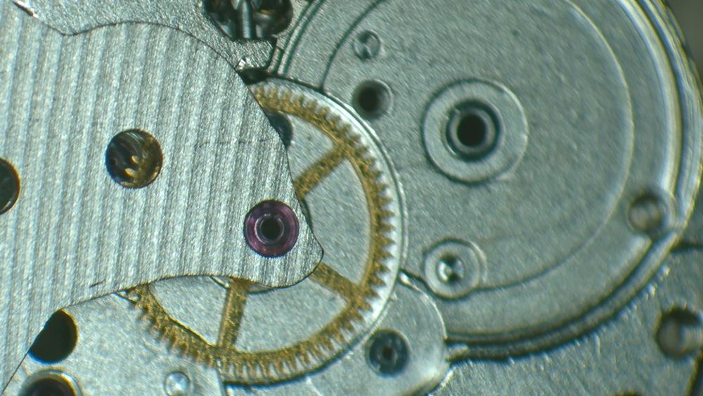

I have a Seiko 2206 with too much endshake on the centre wheel, allowing it to touch the barrel (which itself has too much endshake, but I can't see how I can fix that).
I was going to push the top jewel down a tad, but a Seiko service sheet gives the following advice.
I don't understand what operation 2 is trying to achieve - 'Narrow the hole diameter'.
But then it tells you to push the jewel back to the same level as before !
Any ideas ?

Hi Mikepilk  from reading the text it seems that in such a case there is a need to pay attention to both the centre wheel and the barrel arbour as separate entities in order to correct the problem. Fitting the jewel at the same height is a bit odd, I think its a case doing each in turn to achieve the desired result
The diagram above is only showing how to reduce the center wheel shake by adjusting the center wheel bridge, not the barrel bridge. So 'narrowing the hole diameter and putting the jewel achieves nothing!
The bottom pic shows you how to increase barrel arbor shake (how often is that needed?) by tapping with a hammer, but not how to reduce it.
As JohynR725 suggests, I think something was lost in translation. My partner is Japanese, so If I could find the original documents !
