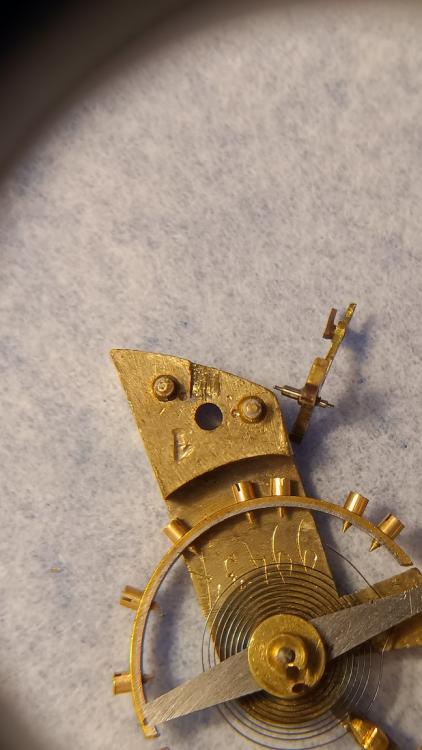

Unfortunately, it was tough to get a good shot of the pallet/balance when it was locked up.  What other photos could help diagnose the issue?

I don't think anything is wrong with the pallet jewels, other than the shellac looks strangely old and crusty.
But with regards to your roller table idea.  Is it because when it's upside down, the impulse pin might fall out of contact with the forked end of the pallet and guard pin, so the balance can spin to the opposite side without the pallet fork having bene engaged as well?  Then on the swing back, if it does contact the forked end, they're on the wrong side, so it stops dead in its tracks?

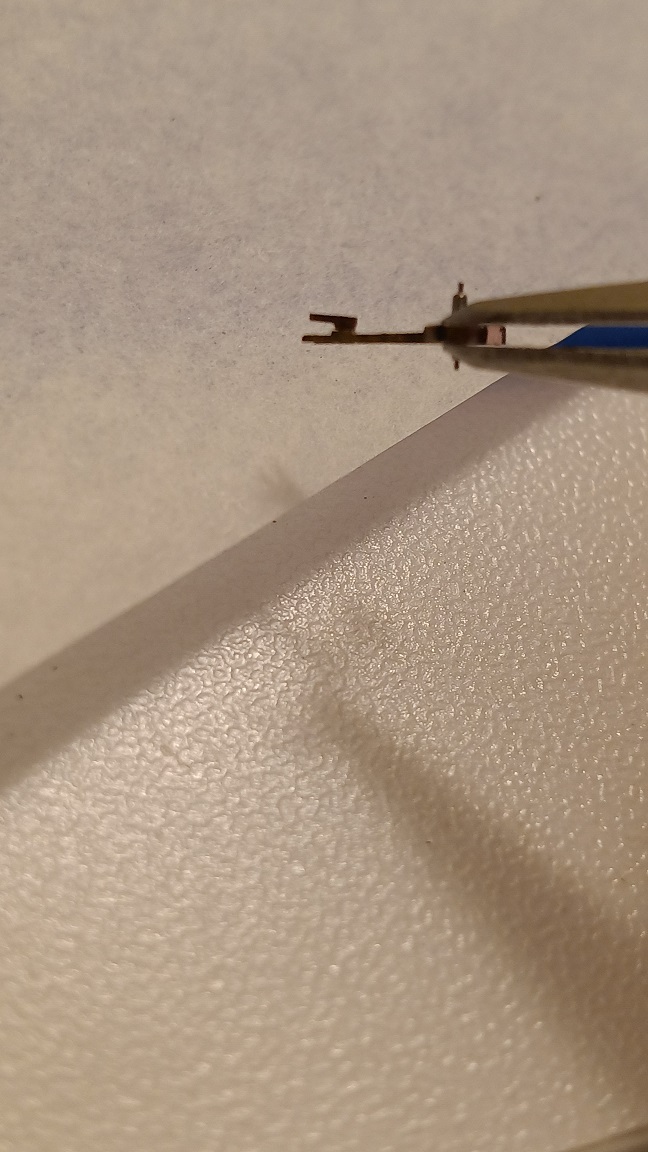

Fork arbour looks shellaced in the hole , perhaps not a good friction fit,  so might not be perpendicular to the fork.

Fork arbour looks its been shellaced in place, not friction fitted, so if the fork is lopsided as a result, a pallet might miss a escape teeth causing overbank.

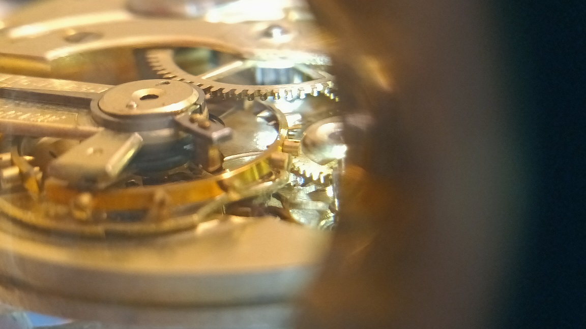

I got some more pictures today.  I also got a video of the endshake on the pallet fork.  I forgot to take a video of endshake on the balance, but it seems very high (though the staff does not seem to be broken).  Not sure what to do about that since the jewels are rubbed in.  Also, in the first two pictures, I did my best to capture what the balance/pallet look like when it's stuck.  Interestingly, the jewel is on the opposite side of the pallet in those pictures.  The pallet fork is hung up on the roller.  Though without the escape wheel in the gear train, I think the pallet was free to swing to the opposite side under gravity get stuck.  Banking is fixed.

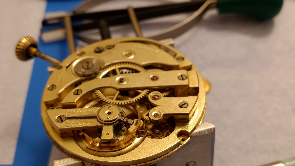

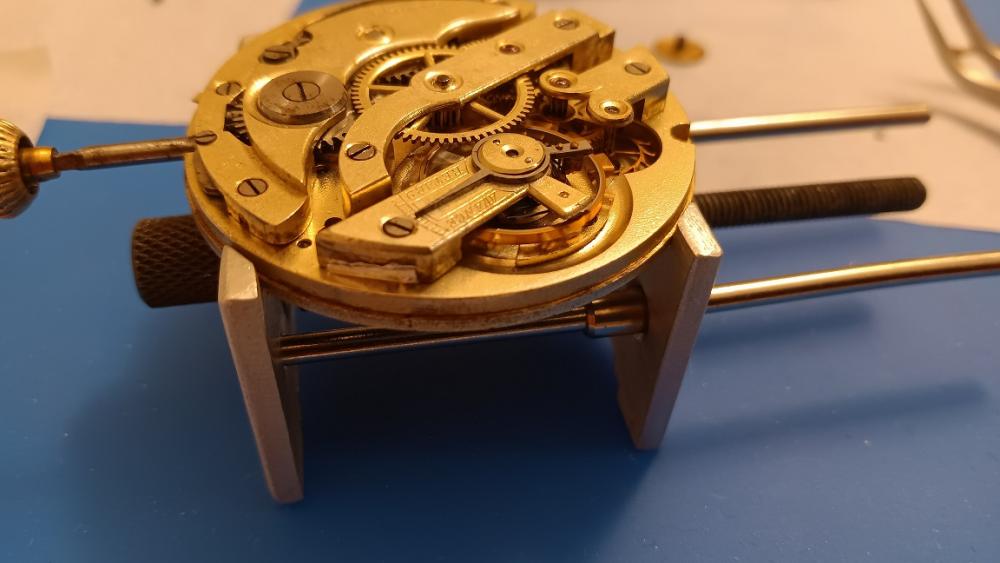

You can reduce the endshake by adjusting the cock, place a piece of aluminum foil in between the cock and mainplate, placing the shim near the outer premeter of the mainplate tilts the cock lowering its setting, move the shim inward /outward to get the perfect endshake. Keep an eye on the roller table, fork and  impulse jewel to engage correctly.

I will try the aluminum foil method today and report my findings.

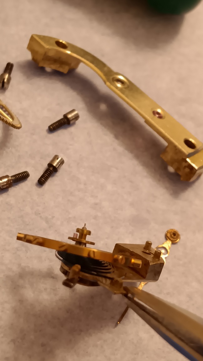

Did you adjust the end-shake on the pallet fork as well?
No.  I didn't know how to do it for the pallet.  I understand for the balance that shimming up one side would push the other side down.  But either way it's been running no problems, so if it ain't broke, don't fix it.
You would do it according to the same principle used for the balance, i.e. a piece of foil under the pallet cock, behind the screw, to tilt the jeweled end down slightly. As Nucejoe explained, the shimming is how you make reversible adjustments for diagnostic purposes. The permanent fix will be different.

I last left it running dial up last night.  But if I come home today and it's still running, I am going to call it good enough.  I will continue to monitor it for a few days.  If it runs in all positions, I don't want to start fussing with what now works.

24 hours and it's still running!
