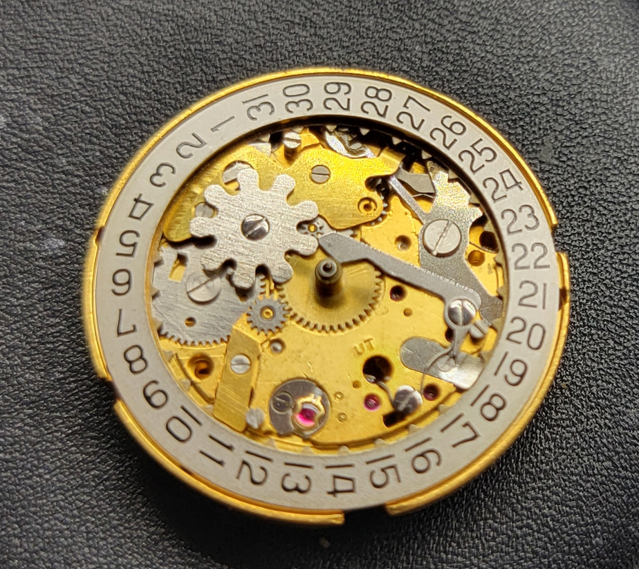

Hello - I know this is from over two years ago.  I have a Felsa 4009 and there are a couple of springs I have to put in but one of them I have no idea where it goes.  The Date Jumper spring and the Date Jumper where lose inside the case.  Any idea where they go?  Do they go by the keyless works?

Well, I looked back at my files to see what pictures I took and what I posted here is all I have.  Odd, because back then, I was taking lots of pictures.  Show us pictures of the springs and your current status and maybe we can figure it out.

Unfortunately, those documents do not show how springs go and/or where they go.  Most of them are pretty self explanatory (yoke spring for one is pretty easy to figure out), but the date jumper and the date jumper spring (2575 and 2576 in those PDF files) are shown there.
I finally found an image which help me figure out where it goes.  Not that it has helped me in trying to get them set there without one or the other (or both) taking flight.  The tension is so high that if you have the date jumper in and try to do the spring then the date jumper come lose and if you do it the other way then the spring wants to take flight.
The image shows the date jumper and the spring (this image is from ebay not mine) and you can see them below that plate which they call the Minute Work Cock.  Anyway, if anyone has any tips, clues, suggestions on how to do this without either of these parts wanting to take flight. Then I would be very grateful.
I guess I should add images of what I managed and what I tried.
1. I was able to set the Date Jumper and Spring without the day ring
2. I was able to also put the plate on top (see image).
However, I can't put the day wheel if I put the plate on there and if I don't the second the wheel touches the date jumper it just jumps.
Well after more tries that I even know I finally got it.
In the end what I did is place the Day Ring (Date indicator) then the Date Jumper and then the date spring.  However, I left the spring without tension allowing the long leg to be over the Date Jumper.  Then I put that lid on (Minute work cock) on top with screws loosely.  Once all that was in place I used the tip of my tweezers to move the long leg to put pressure on the Date Jumper.  That's the only way I could get it done.
I don't know if that's how you are supposed to do it but I am not sure how else to get it.  Here are some photos.  I'll test it tomorrow to see if it is working properly.  Images below.
