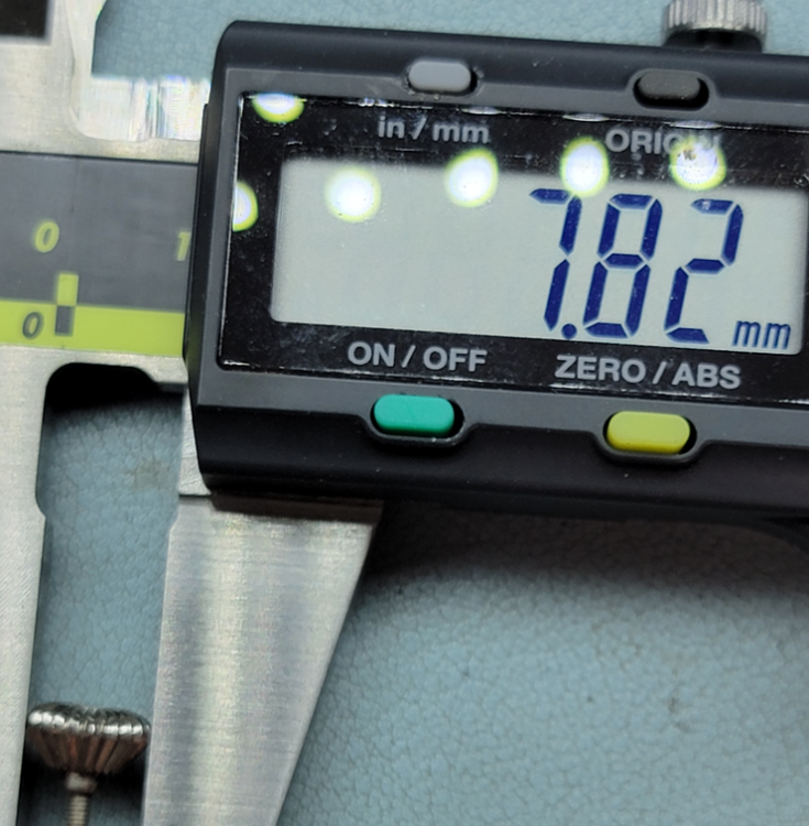

That looks like a good match and I think he 7.82 diameter would be in proportion to the rest of the case. One question… Could you measure the overall height of the crown, including the threaded part  that sticks out on the bottom? I just want to make sure it won’t interfere with the bow vertically. If the dimensions are in order, is this something you would be willing to sell? Thanks

Sure

LittleWatchShop, I took some measurements and I dont think there would be any issues with vertical clearance. After thinking about it, my concern with that crown would sit on top of the case tube and even if I cut the stem length carefully, there would still be a gap which would allow dust and water ingress. I am thinking I need a crown with no post and an opening slightly greater than 3.60mm so that it can fit over the case tube to minimize that. Please let me know if you disagree.
JohnR725, thanks for the links. I did come across those while doing my research but they (and other pages I found) only go in .1mm increments, 1.1, 1.2, 1.3, 1.4, 1.5 etc. My stem has a diameter of 1.45mm, checked with both digital calipers and micrometer. Is there a standard to step up or step down to calculate the tap needed?
KarlvonKoln, the largest tap in my set is 1.2mm so I dont have one big enough. I did look around and individual taps can be had without spending a great deal of money. I would not be opposed to investing in one and trying your suggestion. The learning experience would be good if nothing else. The same question applies though... what size would I need. I do have a couple of crowns in an assorted box I have that would be good candidates.
