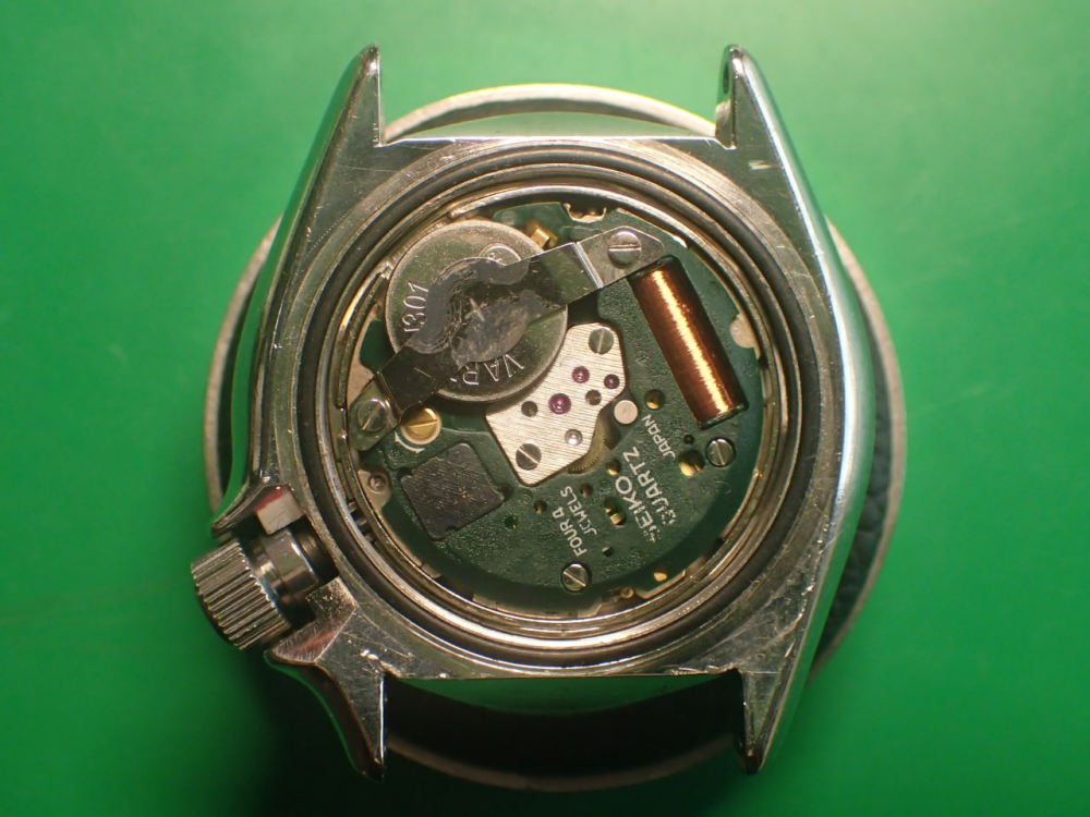

I would need some help in troubleshooting the issue for this Seiko 7548 movement.
Prior to disassembly and cleaning, the movement was not working.
I disassemble and cleaned everything. Now I putting back the base movement together with a fresh 386 battery but it is still dead as a door nail.
My diagnosis so far:
* The train wheel is spinning fine
* The battery is brand new and should be good
* The circuit looks fine
* The coil looks fine
I have two different coils: one from a dead 7546, another one for this movement.
Does the movement need the metal retainer in order to work?
Any help or suggestion is welcome.
Thanks for your help.
Cheers
Hello   If as you say the train is free and the3 battery is good (have you checked it for 1.5v) it leaves us with the coil and the block.  check the conductivity of the coil and its resistance. If that checks out you need to check the out put from the block and see if there are any pulses reaching the coil.  I have attached the service sheets for the seiko.  On page 13 there is a dignostic flow chart to help you.

If you are still working on this one I think I see a problem.  The screw on the Reset Lever looks incorrect.  It should be a screw that has a square(ish), flat, brushed top.  Look at the parts list.  Other screws from the movement will fit there but are too long and rub the parts under it stopping the movement.  022494 is the part number of this screw.
Awhile ago, I bought a recently serviced but not working 7548-7000.  I serviced it again, replacing the screws where I found them.  Still didn't work.  I stripped it down again but this time, sorted all the screws per the parts list.  With the correct screws in the correct place, the watch ran correctly.  The Reset Lever screw is just a tiny bit shorter than the others.  It is most easily distinguished by the top shape and finish.  My before pictures of the movement confirmed that a different screw was used on the Reset Lever.
Hello,
sorry for going silent on this project. I solved my problem in a rather inelegant way. What I did was replacing the circuit and coil with one from a donor 7546. So now, the watch has the wrong movement number, but it does work fine.
Thank y'all for your help!
