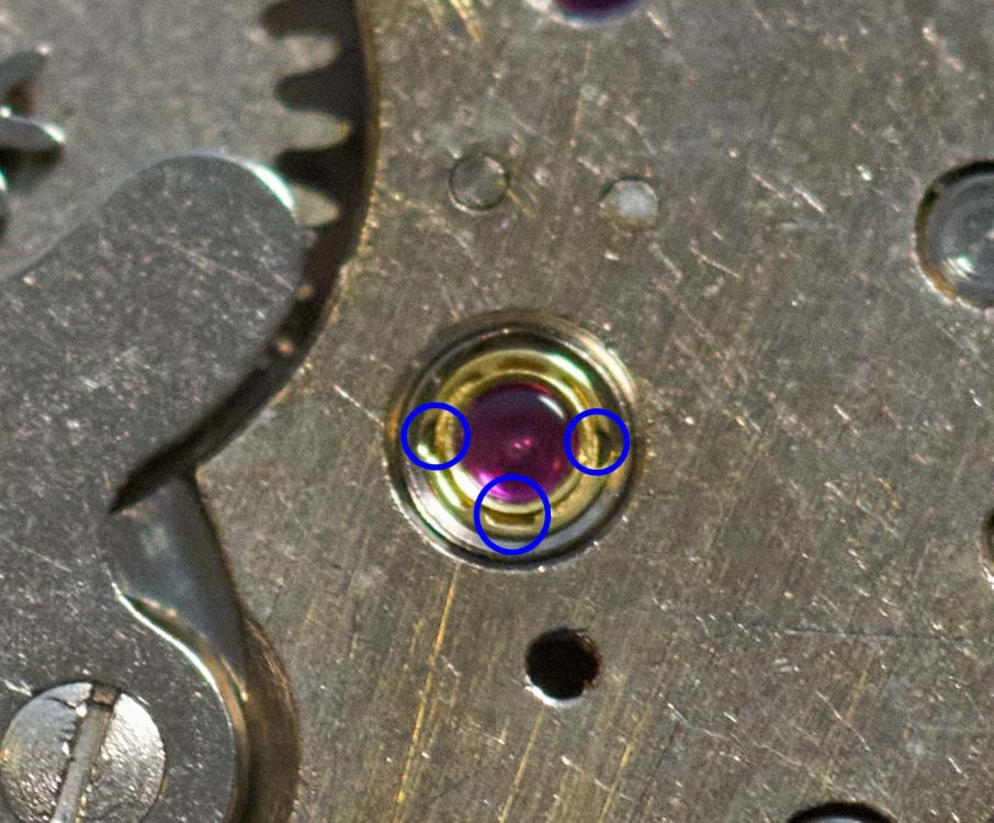

Busy repairing and servicing a Nivada Compensamatic with the AS 1686 movement. All of the references I can find on the movement show a lyre shaped Incabloc spring for both top and bottom of the balance, including the very well documented Vulcain service on this site. This one is different.
The top spring looks very much like a KIF Trior, but the bottom mount is significantly smaller with what looks like a different spring. I've tried to get some detail on the attached images but was having to hand hold. Any suggestions would be much appreciated.

Thanks for the input gents. I had spotted the small cutout on the top mounting so it looks like a modified piece of pegwood might do the trick.  Looking at the bottom spring there appears to be three notches as marked below, but these are hard to spot even through a loupe. Looks like it'll be hard to remove but is going to be extremely difficult to put back.

…Looking at the bottom spring there appears to be three notches as marked below, but these are hard to spot even through a loupe. Looks like it'll be hard to remove but is going to be extremely difficult to put back.

I personally would not try to disassemble this setting! Clean it as it is and oil through the jewel hole.

The spring shape is probably like the top, with arms that line up with the 3 slots when turned.
It will need to come apart for cleaning. Try turning it with some pegwood and see what happens !
Yes mate. They are an absolute pain and so tiny.  The first one i did I lost twice trying to fit it with tweezers which is virtually impossible.  A recessed end of a toothpick did sort it though. Gauging the size to shape the toothpick took a little while. It needs to just fit the 3 spring arms to press them down and get them all started in the setting slots. Then you may have to ease them round with a couple of finely dressed oilers. Great fun 👍

Haha. Yes mike if you try to do it with 3 seperate tools. My first attempts were with one pair of tweezers at the correct spacing to hit 2 of the arms and another pair to deal with the other arm. I was failing miserably for over half an hour with 2 temporary disappearances. Resided to making the wooden tool which took just 2 trys to install the spring. I do have the correct brass version of the tool now.  Yep i agree a poor design, common in small  70's Oris
Thanks for all the advice guys. I'll tackle the top one first and see how I get on. I was thinking of taking Kalanag's advice and attempting to clean and lubricate the bottom mounting in situ for now, whilst appreciating that it won't be thoroughly cleaned in the same way as removing. Think there was a similar discussion around some Seiko mountings recently.

I finally got around to servicing this movement today. Since the original post I've acquired a stereo microscope which has made all of the difference and given me a lot more confidence.
I decided to get stuck into the balance jewels and they were surprisingly easy to remove, but very strange.
The shock spring, both top and bottom, is integrated into a type of chaton/jewel, so no separate spring. The bottom fitting is a two legged affair and the top one has three legs. The jewel that would normally sit against the spring in an Inca type setting sits directly on the pivot with the rounded side facing up against the flat face of the shock/chaton/jewel fitting. I did try putting flat face to flat face but it stopped the balance.
I would have taken photos but was too busy swearing trying to work out which part to oil and which way up each part went.
All back together now and running well.
