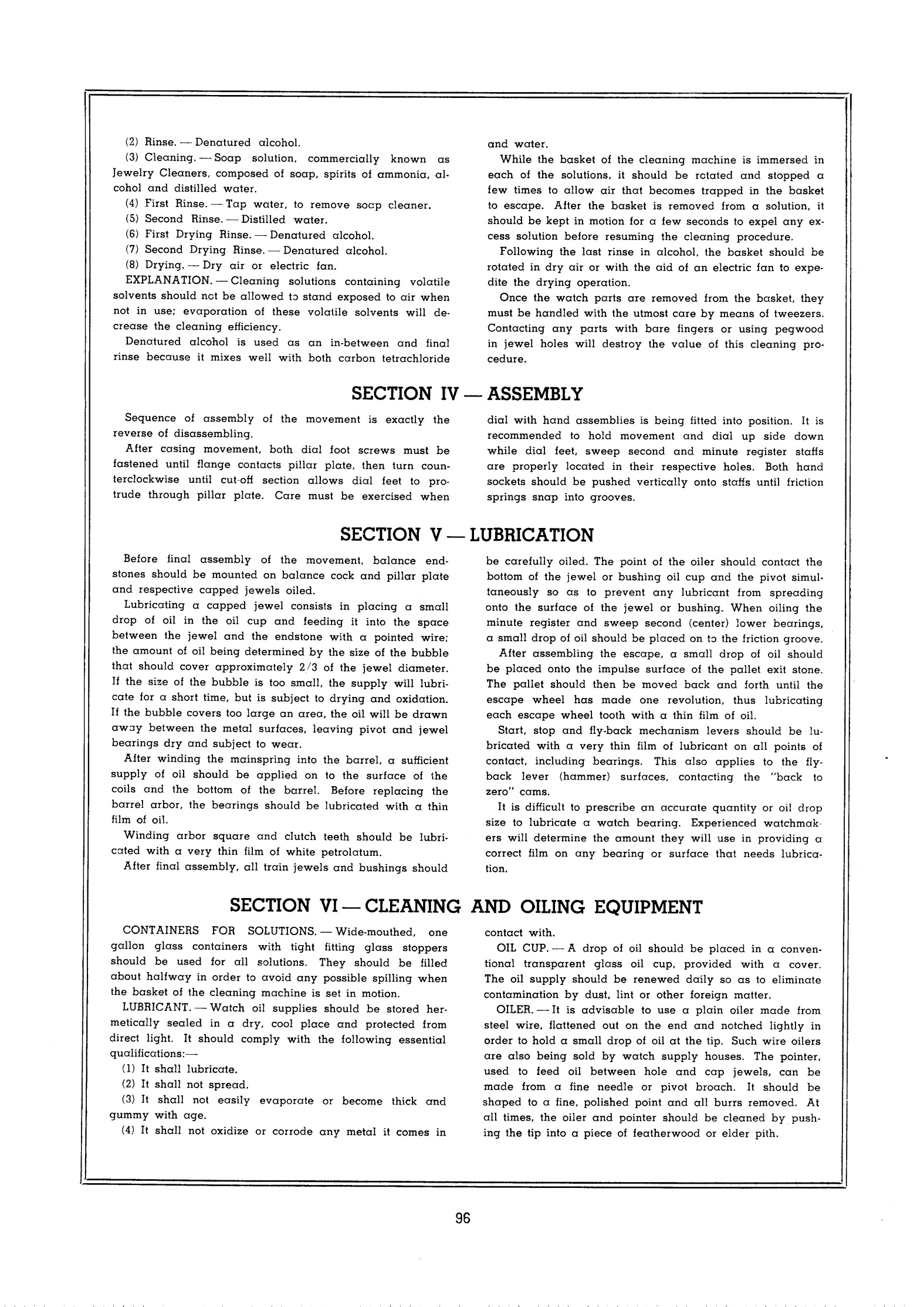

did remember to scan the book made it into a PDF. You notice the watch goes by several numbers but it is the same number on your watch so this is the right watch. Choose disassembly and the parts list. You'll notice the so-called barrel nuts do not come off in the disassembly and are part of the main plate in the parts list. At least I'm not seeing him as a separate component so you can leave them on.
Waltham timer.PDF
Thanks John, that will surely be helpful when I get time to continue the reassembly,
My watch is different in that it uses a thumb slider for start/stop instead of the crown.
