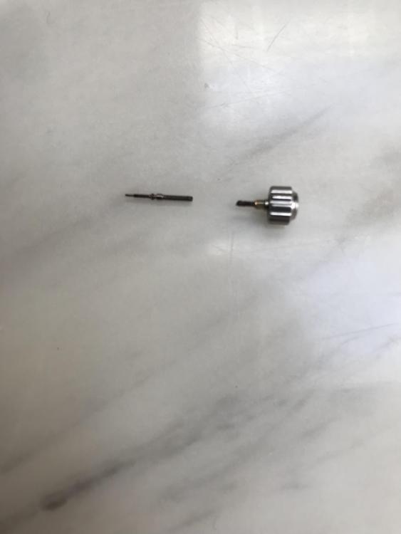

Hello newbie from London here trying to save some money by repairing where possible. Battery stoped and I had some Water that must have rusted the stem. I took it out cleaned as much as possible but it wouldn’t move the hands once screwed back in and then trying to take it out of the crown it broke. So trying to find a new stem and crown for my WL1214 ideally in U.K.? Your expert help appreciated. Bajie

Thank you for the comments. I’ve a battery on order and yes I’ll see if it starts again first. The other no is PL6823 photo added. I thought it possible to get just the stem and if I can get the old unscrewed the just screw in the new? Or is this not what you get ie you get crown and stem? I also wouldn’t use it again in water.

 Will you show a picture of the broken stem and where stem is broken off inside the crown, helps members  give advice, you might not need to purchase another crown and fix what you have or get by with just a stem extender.

yes that's the general concept. usually the new stem is long so it has to be cut the proper length. then usually a little bit of filing shape the ending get it perfect. Then once everything seems to fit in his right now the Loctite to keep it from unscrewing.

So it looks like 9mm and I could get the broken end off the crown. Thanks I’ll order the extenders and trim to circa15mm. All depends on if the movement still moves but if not looks like $50 for replacement and then I’ll seek advice on taking off and putting on the original Tag face and hands. Thanks for all the help to this point.
