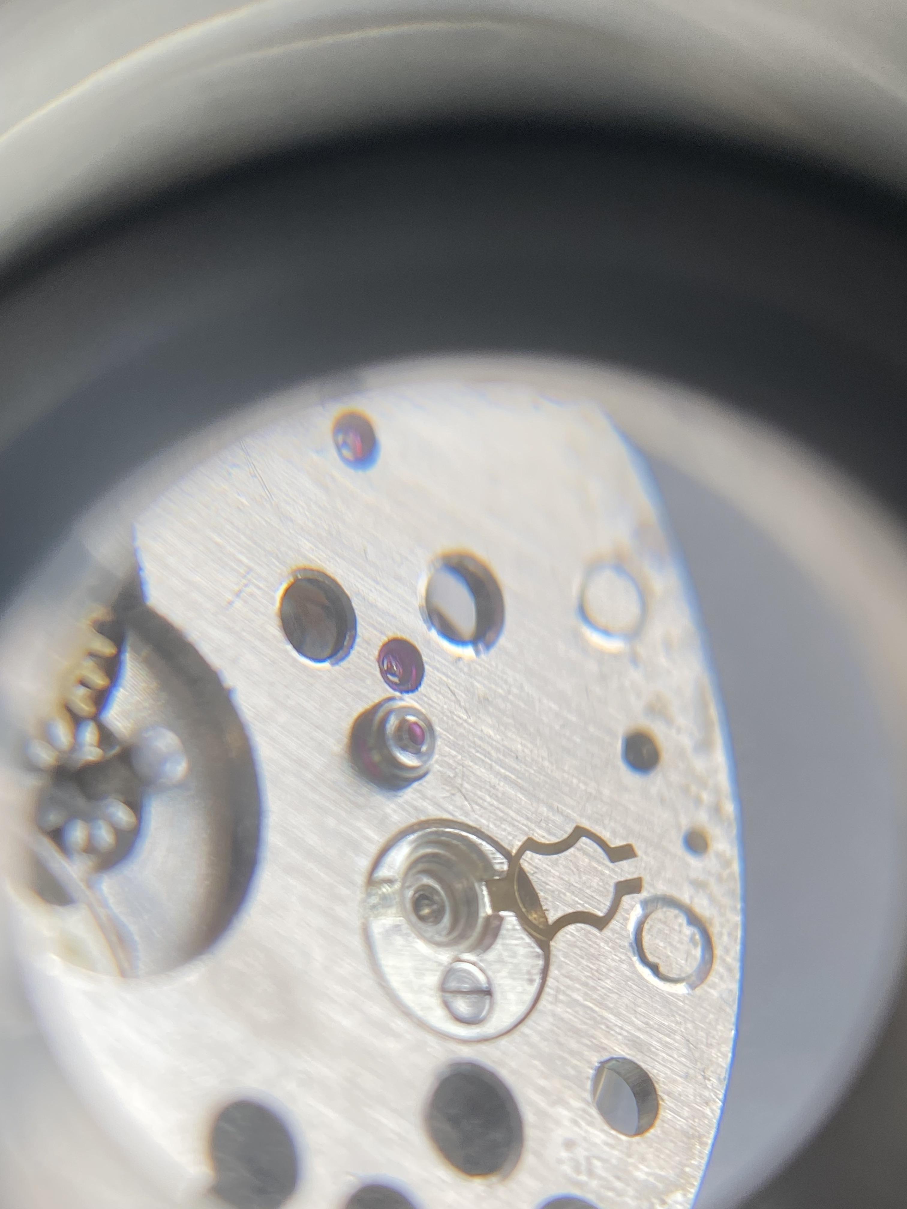

I am currently working on a watch branded "CITY" which has a quite nice AS 984 caliber inside. The watch runs incredibly well when running it dial side up, however, when turned upside down, the watch immediately stops. The balance wheel is contacting something and suddenly stopping. I noticed I can move the balance pivots about 0,5mm up and down in the cap jewels which I think is quite a lot. Could this be the issue? and if so, do I need new cap jewels or can I fix it by myself?
Perhaps it is something else. The pivots themselves look alright. Perhaps one of the pivots are slightly shortened and needs replacement?

Eyup brehmer. Half a mil does seem a lot. Does the bottom pivot worn/short ? The pivot shoulder may be touching the bottom of the balance jewel. You can try a little hack that some use, bit naughty but by spinning the cap jewel over to dome side down . Worth a try to see what effect it has.
Right, the pivot shoulder is touching the bottom. Although the bottom pivot itself does look in good condition, it is definitely shorter than the top pivot.
I will give your little tip a try(;
Otherwise I will have to replace the balance pivot.
Big thanks for that answer!
I will keep you updated

Ok so now just be mindful when lowering the inca spring as its seating environment has now changed from a domed surface to a flat surface. The space around the edge of the spring may be less so dont force it down. This trick was suggested to me here a while back and i did use it once and it worked and the watch is still running. I'm not saying it will work but it can work. Like i said its a bit naughty and the balance is not designed to run this way.
It worked wonders!
I did lose a couple degrees of amplitude but nothing really significant. Huge thanks for the tip! You solved the problem(:
