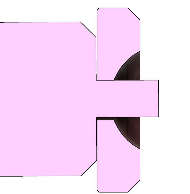

I just serviced a Vostok cal. 2431 in overall very good condition. I've had it since it was new (2014) and it was performing reasonably well before servicing it. It's identical to the cal 2416B but has been modified (by Vostok) to make the hour hand rotate 360 degrees only once per day (24h movement). Anyway, in the process, I carefully adjusted the end-shake to be as small as possible while carefully making sure all wheels were spinning freely.
After the service, the amplitude became extremely erratic. The dial-up position jumps between 300 degrees and 240 degrees in what I perceive to be a random manner. I can't detect any particular pattern for the variations. It appears that the amount of power reaching the escapement varies randomly.
Now, Vostok movements aren't exactly known for their precise tolerances. Could it be that these movements don't handle super fine end-shake as well as modern Swiss movements? Perhaps I should try to increase the end-shake? Of course, and as always, the problem could be something entirely different, but as I did adjust the end-shake to be as small as possible (0.01 - 0.02 mm) that's what I suspect could be the problem, no?
I guess my question is, can end-shake and/or side-shake be too small even when all wheels are perfectly free (Libre Sans Jeu)?

 Depending on the sideshake and diameter of the arbor at the pivot, you can have a situation where the shoulders at both ends are making contact with both hole jewels at the same time if the endshake is very small. It can be exacerbated by very short arbors too, particularly the pallet fork*. 0.01mm is hard to visualize, I made a sketch of an arbor with jewels and exactly that much endshake to illustrate.
*Troubleshooting a new-build tourbillon a few years back I had a situation where the fork was ultra free, with "feelable" endshake, but the watch was having amplitude issues- ended up adding 0.01mm endshake fixed it.

Thanks for your input. Much appreciated! I can't say that I fully get the theory of it, but it's clear to me that increasing the end-shake a bit is worth a try. Reading your messages I now recall that I also replaced one of the 3rd wheel jewels and it could be that the hole diameter of the new jewel was a tad bit small. I'll look into that as well.

Here's a cutaway with close ups of the two ends. The sideshake is 0.01, which is about right for a 0.15 pivot (this size). If the arbor is under tension, it will generally want to tilt- like when you try to wind the watch with the wheel train in but haven't put the bridge yet- everything tilts 🙃. With a very small but existant endshake, the shoulders of the arbor can touch both flat surfaces of the two jewels at the same time. With a little more endshake, as the tilt is restricted by the pivots, it will become possible for one shoulder to touch one jewel (and is almost certainly the case 99.999999% of the time), but both shoulders can't contact both jewels at the same time.
Nice CAD work.
VWatchie, also remember that Nickelsilver probably also modeled those parts in theoretical perfection.  All dimensions spot on, lines that should be parallel are, all angles are accurate without internal filleting or external rounding, concentricity or T.I.R. zero.  Which is all easy to draw, very (impossible) to obtain.  Watch parts (even "cheaper" mass produced watch parts) are probably closer than most but will (on average) deviate from print.  That's called acceptable tolerance.  If you don't want to hand fit every part in every assembly, you assemble using fixtures adjusted for parts assuming the widest possible "acceptable" deviations.
And as Nickelsilver said, while under torque is not the same thing as when it is free wheeling.
Wow, crystal clear, and perfect illustrations! 🌟🌟🌟🌟🌟 Thanks a ton!
This is the kind of stuff that should go into your watch repair book (when and if you decide to write it 😉).
