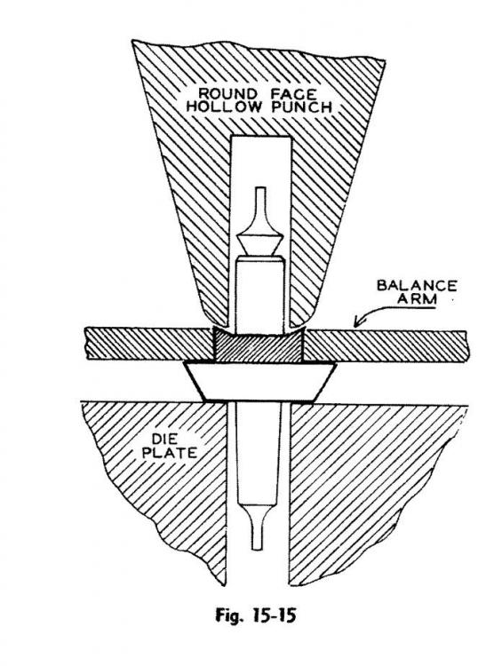

I don't know what size those stakes are, but I can see from the last photo that the rivet is still untouched. So yes, you hit too hard, and also had the wrong size punches (stakes are what go underneath). You want a convex punch that just fits over the hairspring diameter, thus against the rivet, then a flat faced punch with the same hole size. Tap tap tap tap tap tap tap round face, turn the balance a few degrees and punch as well in the opposite direction every few taps to even out any irregularities, check that it has spread a bit, then tap tap tap tap tap tap tap flat face to flatten it (turning as before). The roller table diameter should be in a hole in the staking tool die plate that lets it fit just freely, not tight but not flopping around, so the hub is supported on its flat surface. Obviously align the die plate well with the centering punch once you've chosen the hole.
If the balance is a light friction fit on the staff (ideal), then you would want a punch like you used to seat it, with finger pressure, no tapping.
Here's an image from lesson 15 of the Chicago School of Watchmaking course. It's easily found online in PDF format (I just grabbed this from here and it seems clean). Shows the fit of the concave punch, flat will be the same, also the fit in the die plate of the tool.
Remember this is a really small piece of heat treated steel, not a roofing nail 😜. Also, just as reading about a subject always benefits from visual demonstration, visual demonstration will always benefit from some well written and illustrated reading.
