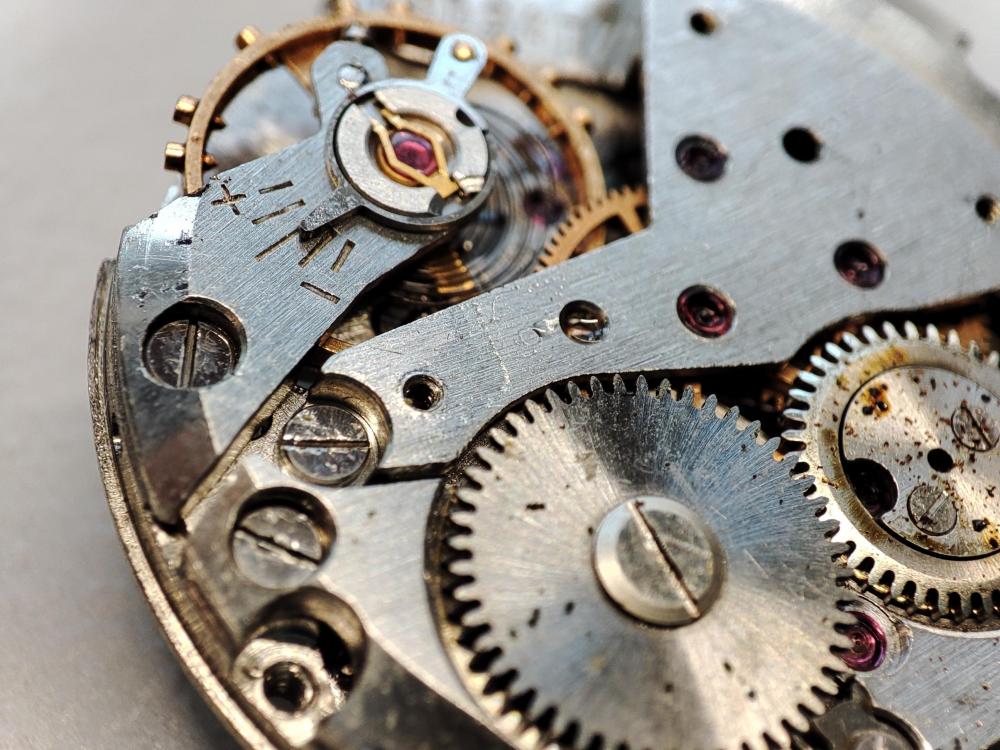

Hi! I was disassembling a 22 jewels Poljot automatic watch.
I believe the caliber to be the 2415 or in the same family, but there is no engraving.IMG_20220723_124032.thumb.jpg.dd63168f113fbc607a99b0eb33f18411.jpg
I was trying to remove the ratchet wheel screw, but it wouldn't go one way or the other. I couldn't find any other way to disassemble the movement without removing it either.
Clearly I should have asked first, but I assumed that the screw wasn't reverse threaded and it was just stuck, so I did some force and it broke.

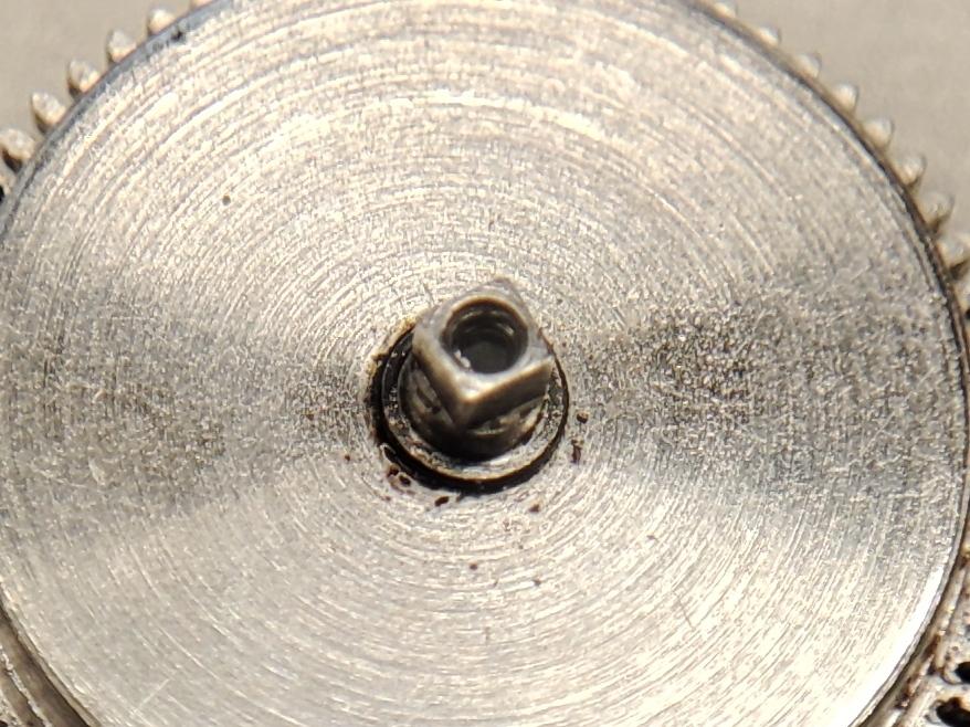

Doing this revealed that the ratchet wheel has a mechanism I have never seen
IMG_20220723_132053.thumb.jpg.643c98d9e83f85714684815946335d05.jpgIMG_20220723_141115.thumb.jpg.e19b2e5068d58dd6d9a344f36a416582.jpg
I am curious about this system, but especially I want to understand what I did wrong.

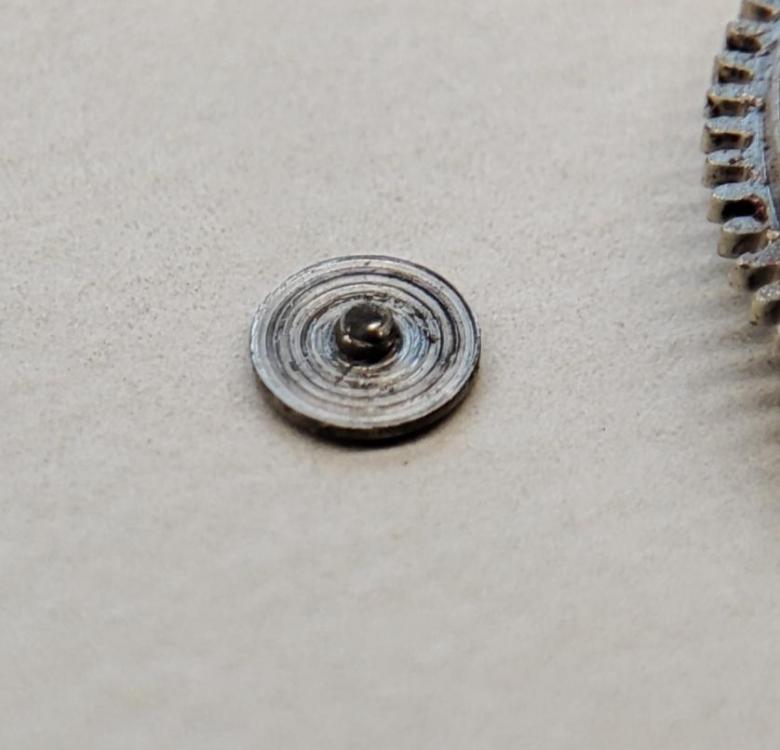

The part of the screw that came out is too short for me to see it's threading
Also, the hole where that head fits seems to be deeper than the screw stub, but it may be an illusion.IMG_20220723_141623.jpg.06fb7bdb5ffefb2fb4c583a3a7798288.jpg

AntonVA,
It looks to be left handed from here and if it wasn't actually stuck and you just turned the wrong way, you might be able to fish it out by poking it with a tooth pick and turning it the correct way.  Just don't use a screwdriver until the last resort.  If you damage the threads, you may never get it out.
That's a very interesting group of parts (I have also never seen them before).  The two three pointed springs look as if they are directional, so they must go in the way they came out or it won't wind properly.  If it doesn't just slip, something may break in the automatic winding gear.

I didn't realize it was reverse threaded because in my movement it didn't have 3 slots IMG_20220723_125732.thumb.jpg.8c41b1b468595789c36f2cab4f78d547.jpg
I will certainly try to take the end of the screw out as you say, thank you

I know from my own short experience that I found that 50% of Ladies size watches I have worked on had left hand threaded screws on both crown and ratchet screws with none of them marked as such so knowing if the screw that would not undo was either a tight right hand thread or a left hand thread is quite difficult, especially given how little force is actually need to break a screw head, I tend to assume that all ratchet wheel screw are R/H thread unless they are not and all Crown wheel screws are L/H thread unless they are not 🙂.  Difficulty comes when the thread is tight because its seized by rust etc, those will will break regardless of which way you try to turn them. 😞
Luckily with the few I have broken or found broken and the reason the watch was not working, getting the broken bit out was quite easy, either using a screwdriver to simply un screw it, being careful not to damage the threads or by using one of those screw extractor devices, but they only work if the the other end of the screw is accessible (Not a blind hole)
