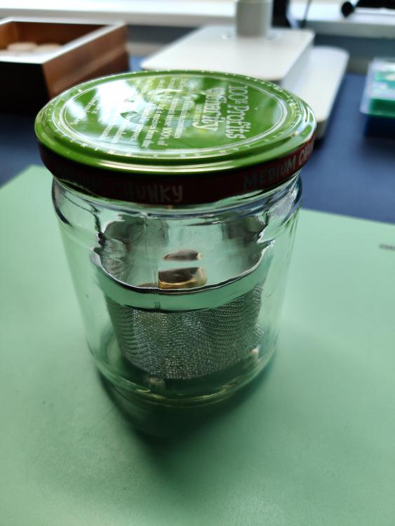

Something I realized I didn't see earlier is watch paper. Goes with the blower during cleaning with my regimen. Not sure whether/how it would work with the lighter fluid strategy. I do know that I wouldn't be able to clean cap jewels without it.
I use 2oz canning jars in lieu of the brits' little jars (I didn't realize that's where they were getting them... way better than those stupid plastic things). You don't say where you're located, but if you're near Denver, you're welcome to come grab some from me.
Edited by spectre6000
49 minutes ago, JohnFrum said:
So the ultrasound with cleaner, with parts rinsed in IPA twice then dried?
Clean, rinse, rinse, all in the ultrasonic cleaner.  Dry with a hairdryer or similar.
This is the setup I put in the ultrasonic. I have more baskets, just showing for illustration purposes.
I really need to get a real watch cleaning machine, this way works but it is slow.
