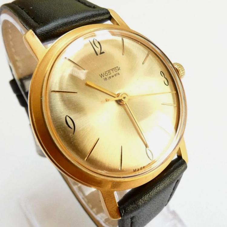

This is my latest purchase from eBay. It is supposed to be running well and keeping good time. The case was almost perfect and the dial only had a small blemish.
When I put it on my timegrapher, it couldn't even get a reading. The first thing I saw when I opened up the watch was dirt everywhere. It was on the plates, the teeth of the wheels and pinions, the keyless.... literally everywhere.
Then I saw the hairspring. At first I thought it was distorted but when I took a closer look, I was shocked and thrilled to realize that it was an overcoil hairspring. I'd been looking for a watch with an overcoil hairspring for some time but most of the known brands are unaffordable ( at least not for tinkering with ).
But alas, joy turned to disappointment when I noticed that the overcoil was sagging and touching the 2nd loop of the hairspring.
